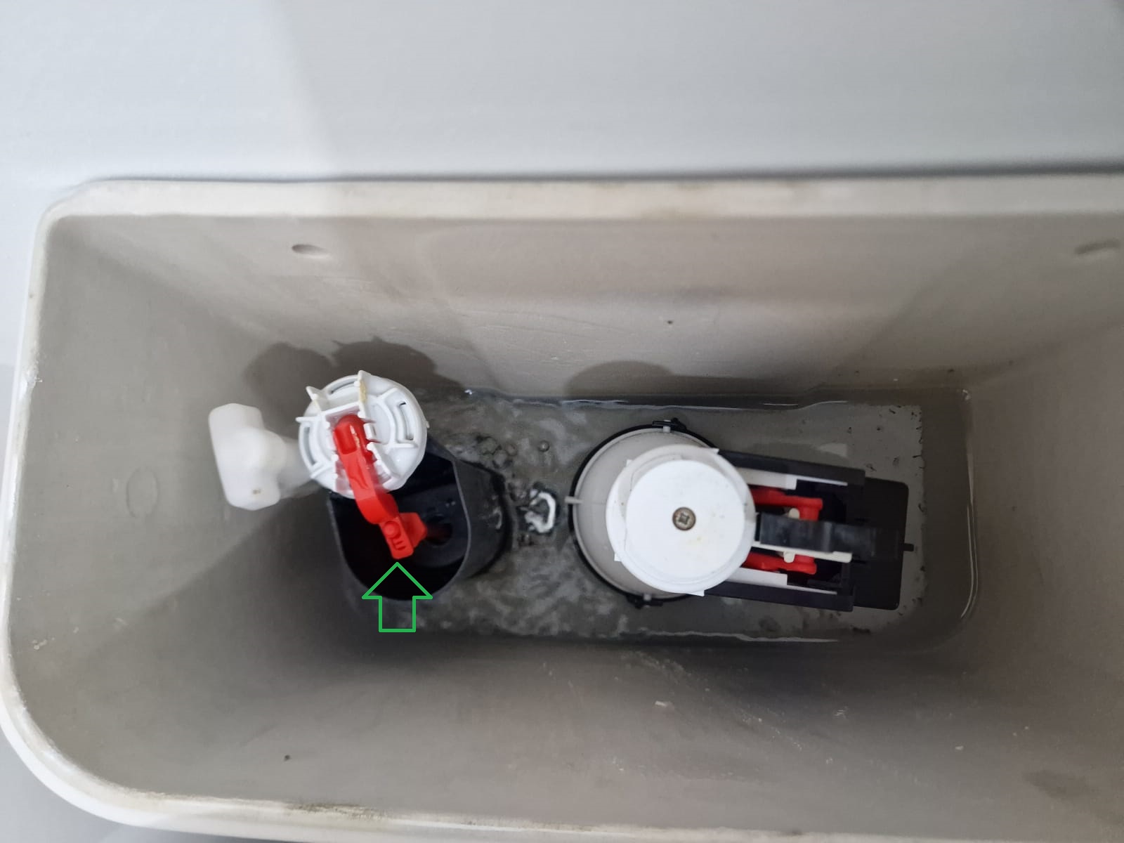

Hi all
We have 3 Ideal Standard toilet/cisterns in the house as part of the new build house several years ago (2015) and over-time, this issue is getting worse to the point its just annoying now.
After flushing, every 2-3 flushes will result in this red lever with the black float getting stuck too high and so the water does not fill the cistern.
Literally have to give it the smallest of taps/nudges resulting in the float to go lower at which point it fills up allowing the next person to flush.
Sometimes we don't bother to lift the lid, tapping it etc at which point it either extremely slowly fills up or usually at 2 in the morning, drops, and then starts to fill up.
Can this part be replaced easily or is it quite an in-depth process assuming it does need replacing?
Thanks in advance

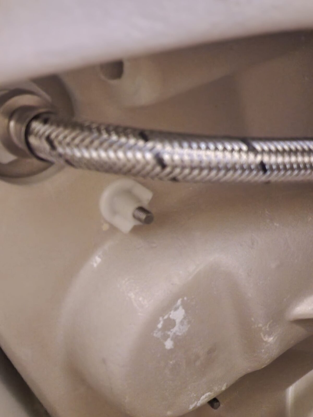

80% sure its braided - happened to see this when I was changing the seat where the hinge bolts were under but will check tonight for sure
Apologies for the poor quality - I assume this is what you mean in terms of braided
@terryplumb how does a brass tail differ?

Brass threaded tail is better to connect to the supply. Plastic threads are very easy to cross thread when connecting up,and then you have a knackered new float valve !!
Hi all,
Just wanted to update - I was advised by a handyman to spray with WD40...and to my surprise it worked.
Never once thought it was fix it especially as that part gets wet but for over a month now, no getting stuck.
Unsure how long it will last but sometimes the simplest solutions are overlooked!
Thanks again

1. With most inlet valves, changing it is often the easiest job.
2. However, with the sort you have got, the cistern has to be separated from the pan to get at the securing nut (white plastic nut above the flexi in your photograph). This is a much bigger job, and requires you to also change the "doughnut" washer which seals the cistern to the pan, and in prudence, the nuts, bolts and washer securing the cistern to the pan.
3. If you can remove the white plastic cap under the red float lever, you will find a rubber diaphragm washer. Change that.
4. It would be best if you can identify the inlet valve (make and model) to get appropriate spares.
5. Turn the water to the WC off before changing the diaphragm.
6. I wouldn't use WD40 on any plumbing fitting which has a rubber washer in it. The best plumbing lubricant is silicon grease. It can be obtained as a light spray such as Screwfix item 3290F.
Not so much overlooked, as not really considered as a go to solution for a plastic float. 8 years out of a fill valve isn't that bad, doesn't really owe you anything,
Ideally it would be replaced. To do that though, that will need the cistern taken off the pan, the fill valve connection is up 'inside' the chair of the pan and will be nigh on impossible to get a tool in there to either get the end of the flexi off or the nut that holds the fill valve in.
