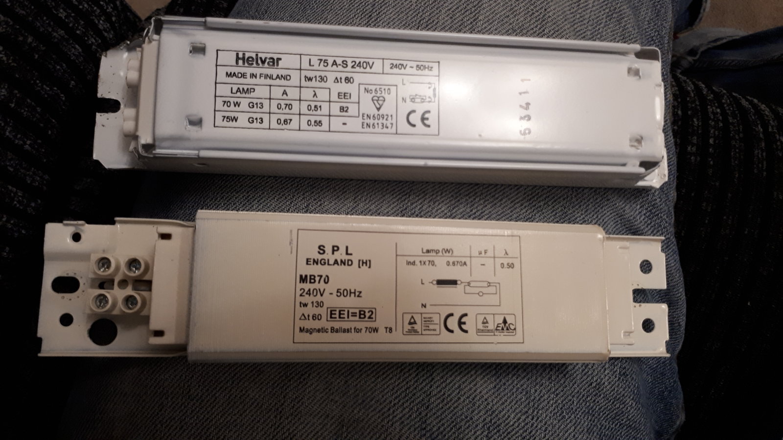

Can you still buy oval shaped lamp holders?
The pictures not very clear, but there likely moulded onto the endcap, i used to keep ones off faulty fittings back in the day to repair others as it was quite common for them to burn up, sometimes you can pop them open and if your lucky clean the metal springy bit up.
Failing that any of that ranges endcaps will fit from 2ft up to 8ft if you can find them

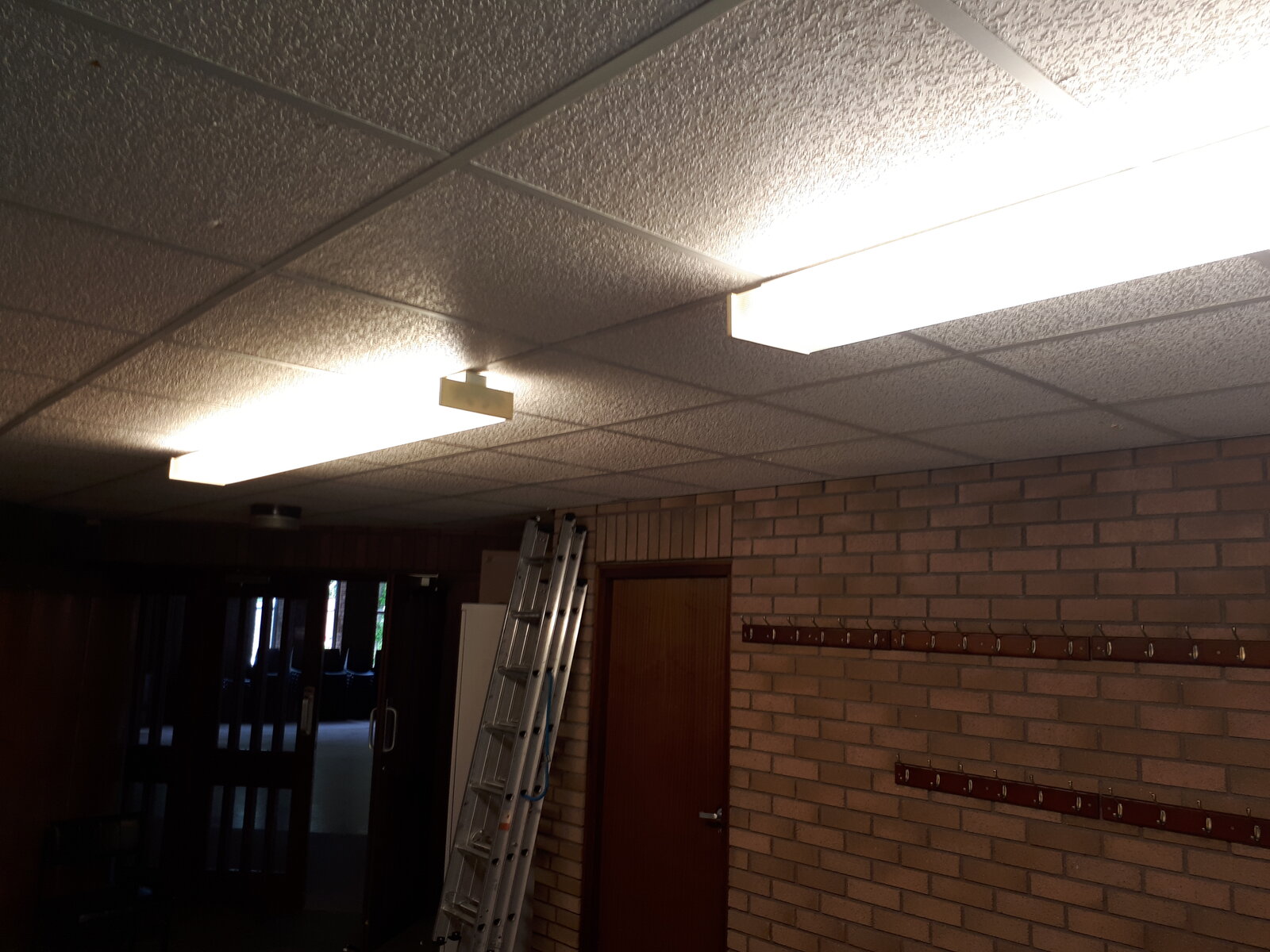

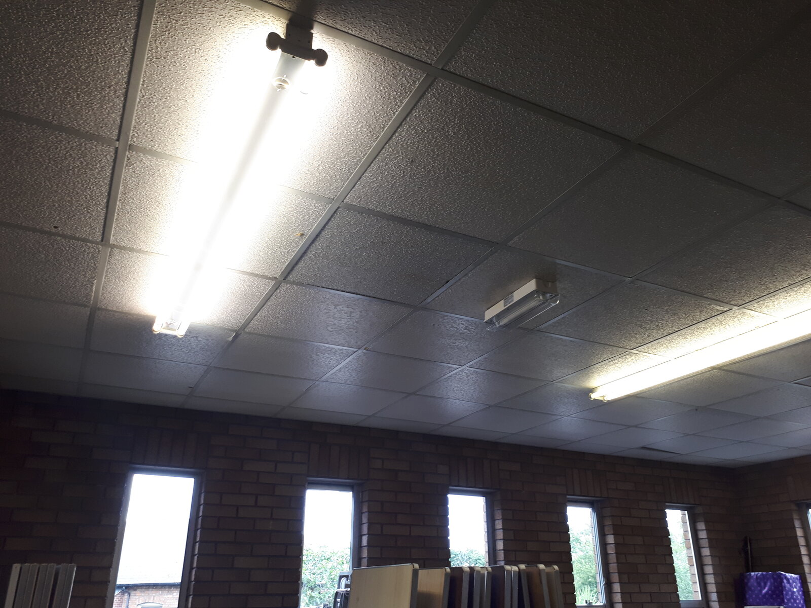

Hi,
Just resurrecting my thread from last March before lockdown. I was finally able to go into the church today and fix those faulty thorn 6ft lead lag fittings with new 5uf capacitors from amazon.
Thanks again for the help.
Rich

Fantastic!
Thanks very much for the update, it's always good to hear how things turned out.
Visited the church again today and all three of those capacitors I fitted have failed. Cheap Amazon rubbish. I'll just leave them with the lag tube working rather than bypass the cap.
