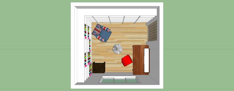

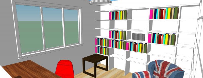

Yeah, dining room is to become a home office/study type space to look something like this
I am a bit concerned about the kitchen feeling small but with the utility room and new living/dining space at the back I thought it might be ok.

Kitchen should feel bigger with the opening through to family room.
might even open up the right hand wall a bit further.
