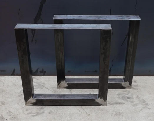

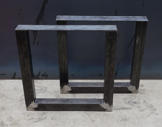

Sorry, I should have been more clear. These are the legs I am trying to fit. There are 8 holes in the top rail on each. Are inserts still the way to go?
You will need to have some form of attachment which allows the timber and the metal to expand and contract at different rates. I'd possibly prefer some form of stretcher/angle plate and good, old fashioned wood screws
