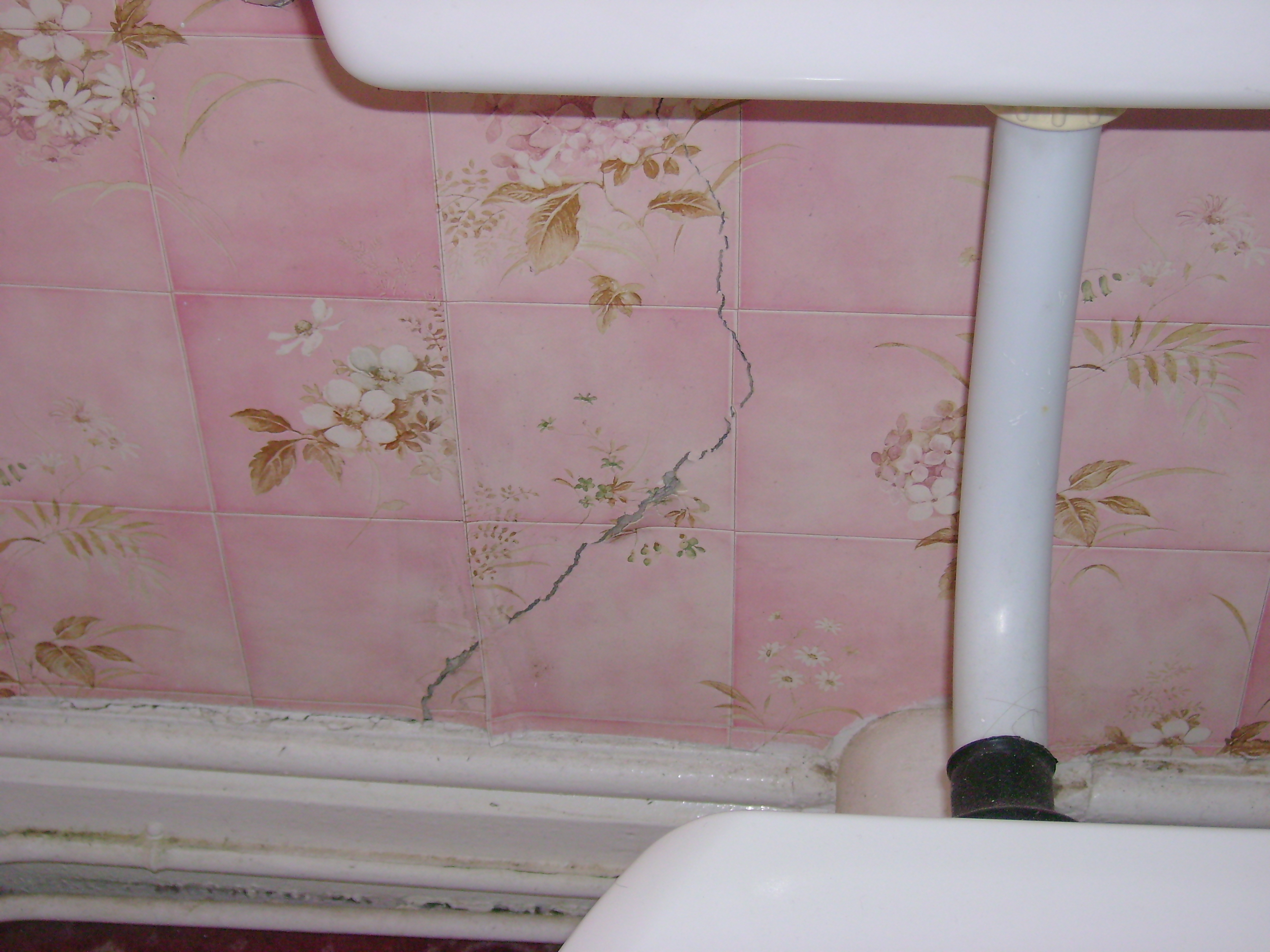

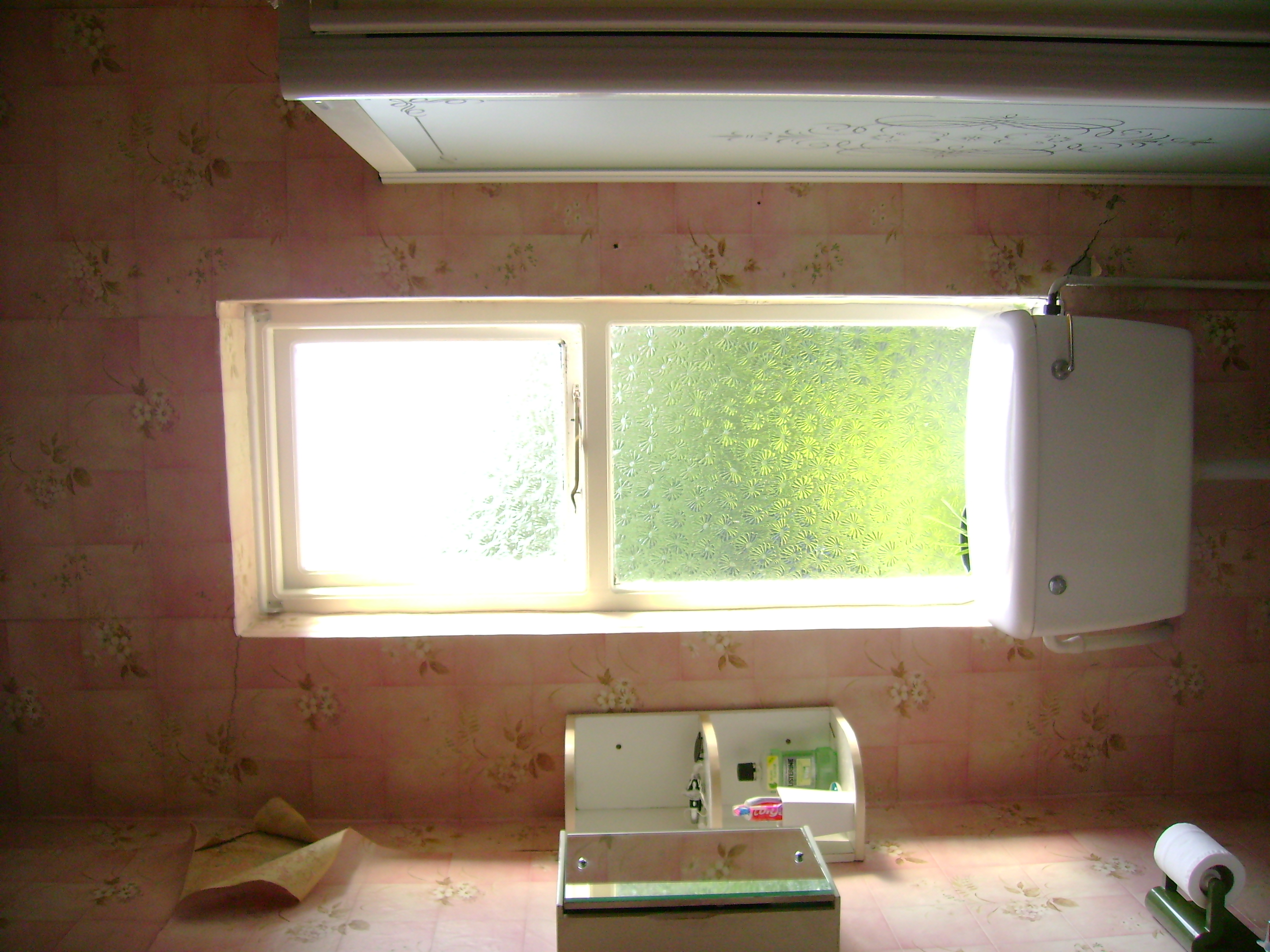

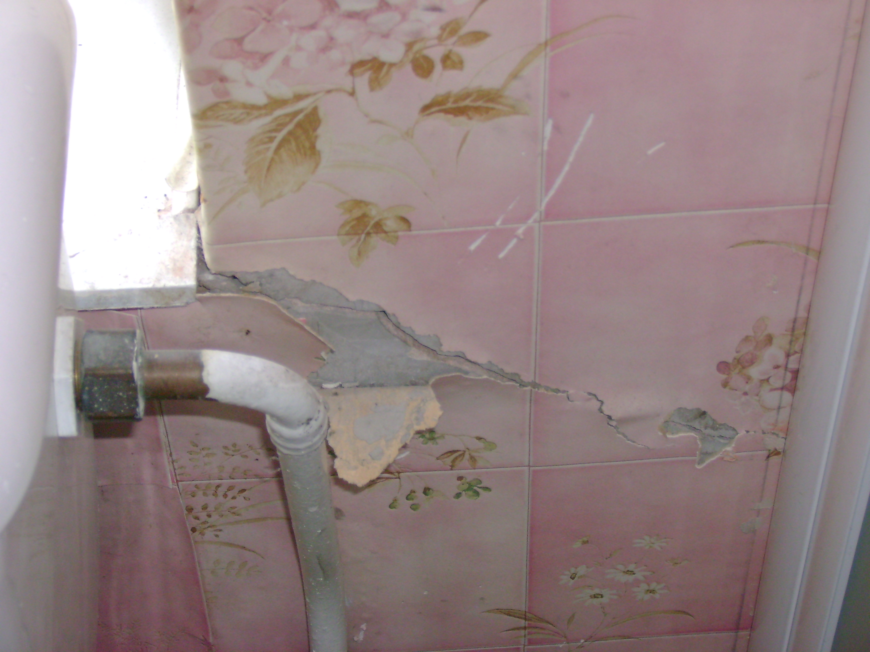

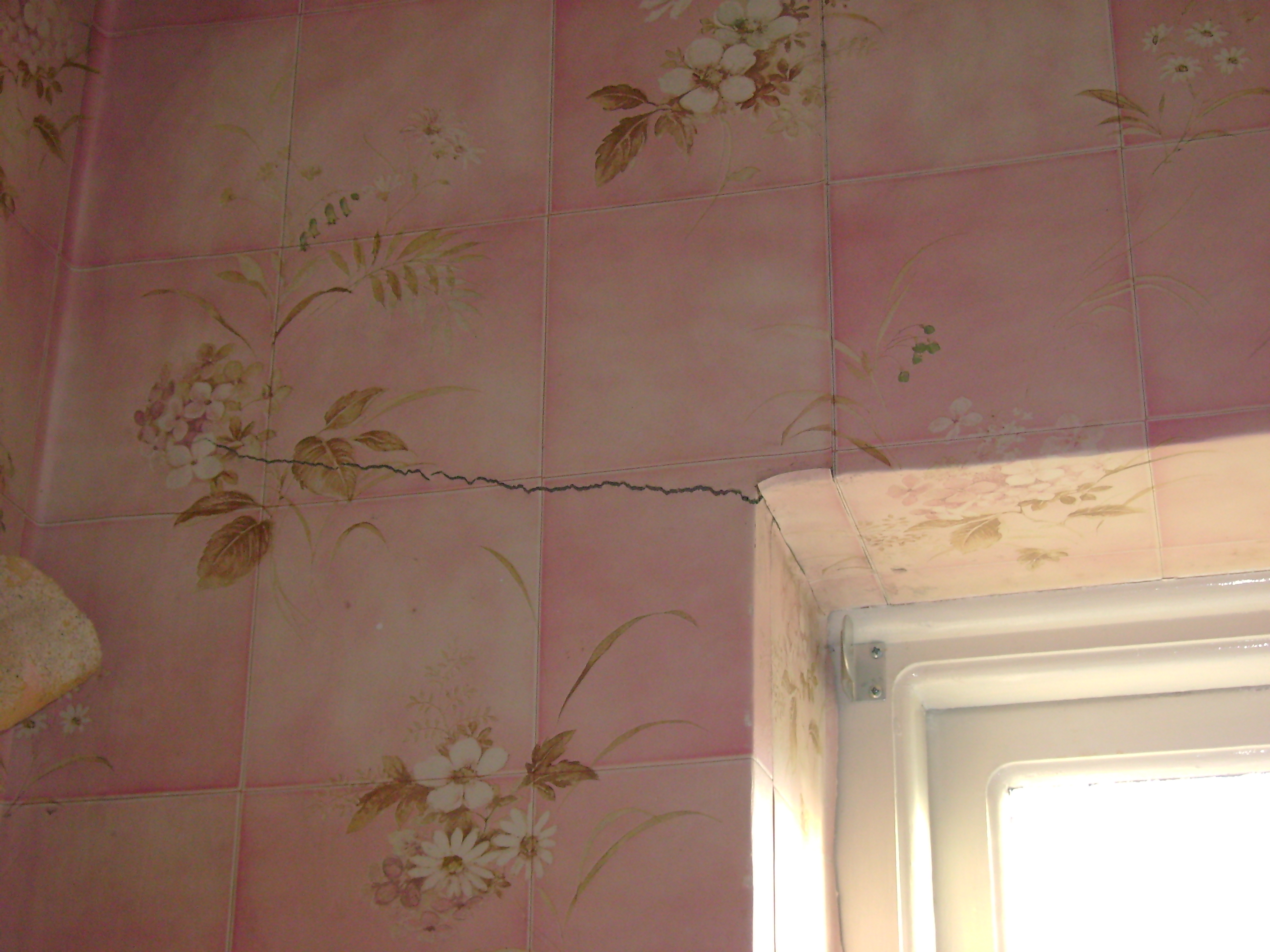

Thanks for your responses. Yes, the movement in the past does seem to have been downwards, as the floor slopes downwards noticeably when you walk into the bathroom (and the ceiling downstairs is bowed).
There is no external crack on the outside that I can see - see the following pix:
http://www.jawaddington.co.uk/cracks1.jpg
http://www.jawaddington.co.uk/cracks2.jpg
http://www.jawaddington.co.uk/cracks3.jpg
http://www.jawaddington.co.uk/cracks4.jpg
Most cracking is around the window, as you could see. Problem with the lintel? Thanks in advance.

yes also.
the strapping thing isn't going to help.
there is clearly a movement problem, monitor it to see if it gets worse, over a year or so.
If it does, replaster and sell quick. (only kidding)
If it gets worse, then call in someone competant to sort it, not the half wits you have been taking advice from.
Thanks chaps for this sound advice. The cracking hasn't got any worse over the year I've had the house, and it is prob 20 years since the bathroom was decorated, so it seems to be historic and not getting worse.
Regarding the fine mesh, should I just repair any damaged brickwork and then cover just the affected areas with fine mesh or the entire wall? How would you fix the mesh to the brickwork?
Best wishes...
Alex
Plaster scrim tape or hessian, or a bit of fine galvanised mesh dabbed onto the wall across the crack with a bit of plaster and then plastered over.
Aim for something like 75mm each side of the crack (equivalent to 150mm wide mesh) and this should follow the line of the crack.
It just stops any slight movement or contraction of plaster across the crack
But fill any wide cracks in the wall first - a bit of runny mortar forced into it will do
