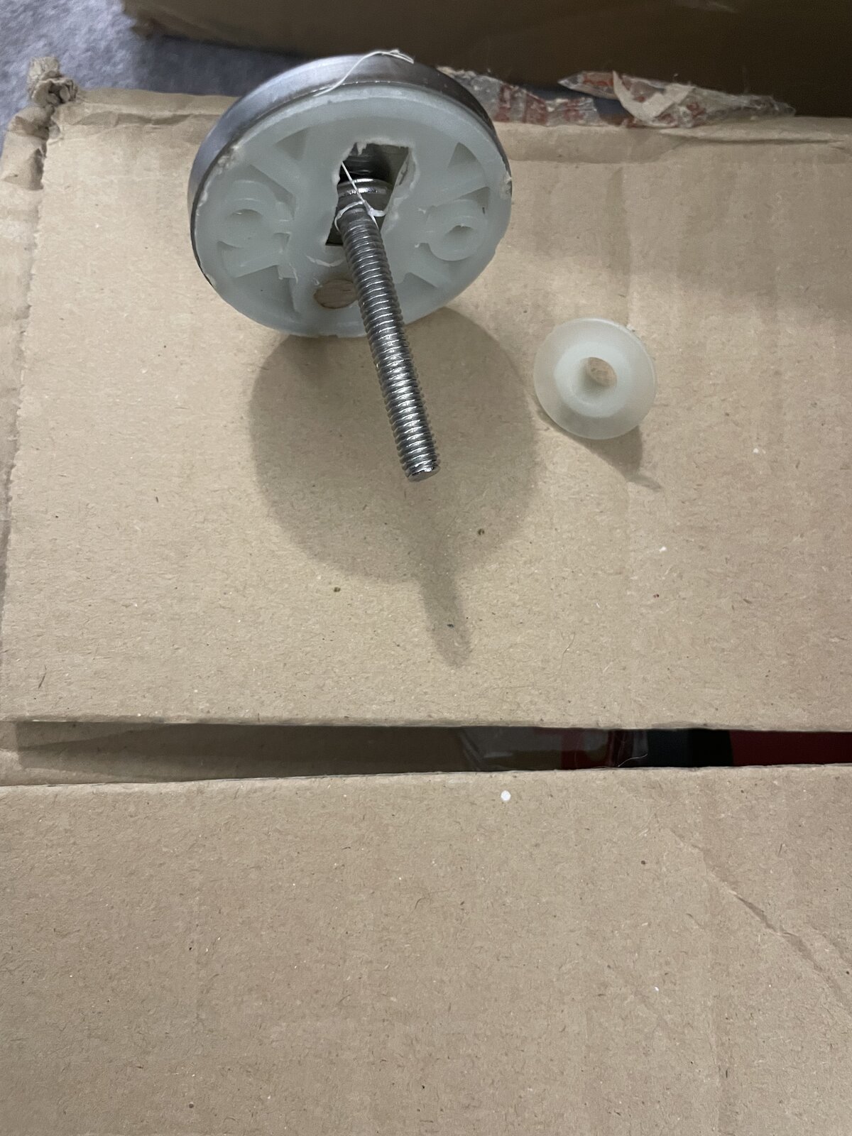

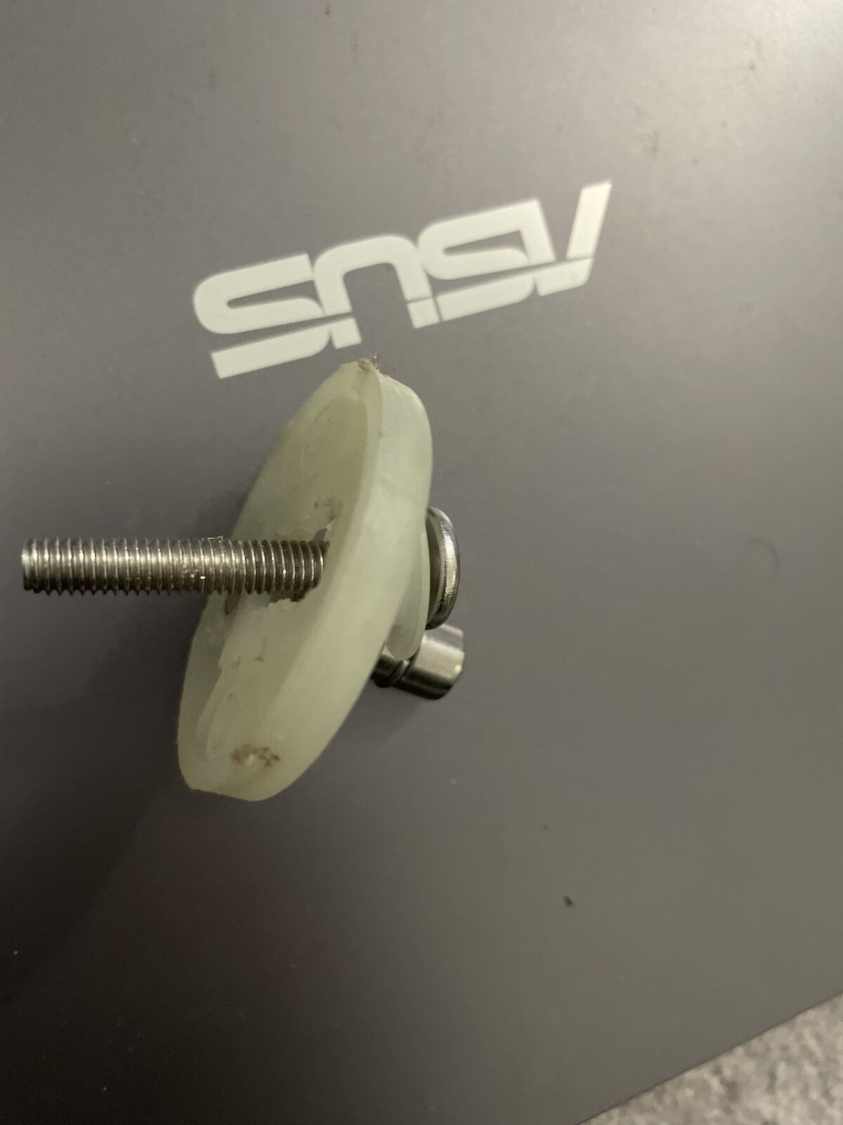

I have a wonky toilet seat. Taken it apart.
I have this screw and nut ( photo attached). Can’t seem to screw the nut in to tighten it. Please help.

Take stainless steel cap off so you can hold screw while you tighten plastic nut
I always bin the plastic rubbish that comes with those bolts. I use an M10 (I think) nut and a washer.
