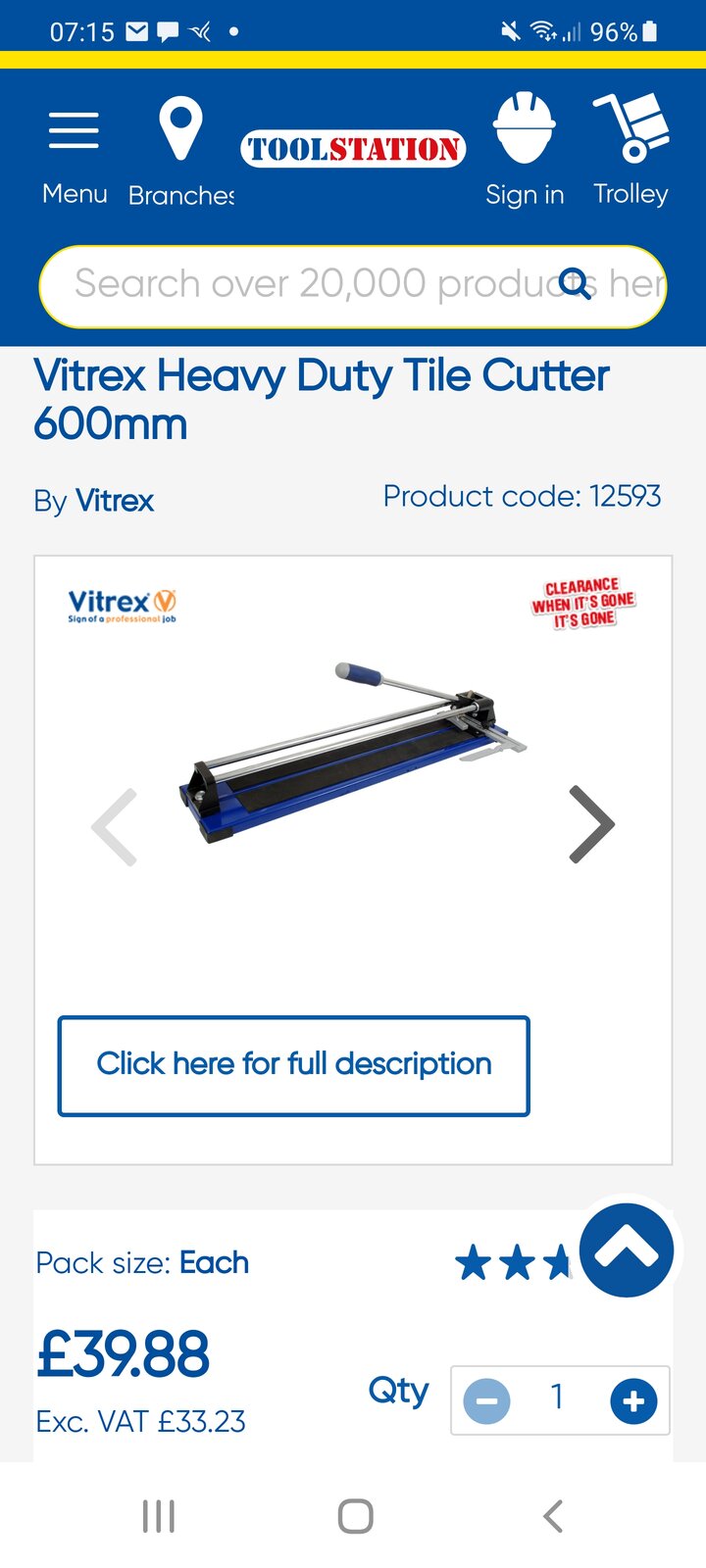

Hi all,
What tile cutter would you recommend to cut 600x300 porcelain floor tiles? Nothing expensive, just cheap and cheerful would be ideal.

You cannot beat these for straight clean cuts imho.
I have used the cheaper wet cutters on large format tiles and they do the job as long as you take your time.
Also used a diamond disk on a Dremmel with flex drive for some detail work.
If you're tiling your own house you can take the extra time to get a better finish.
