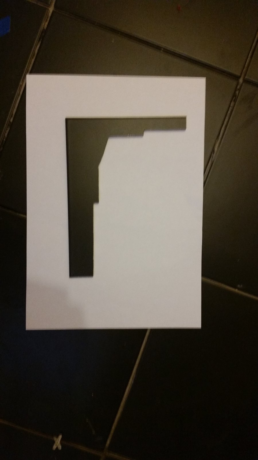

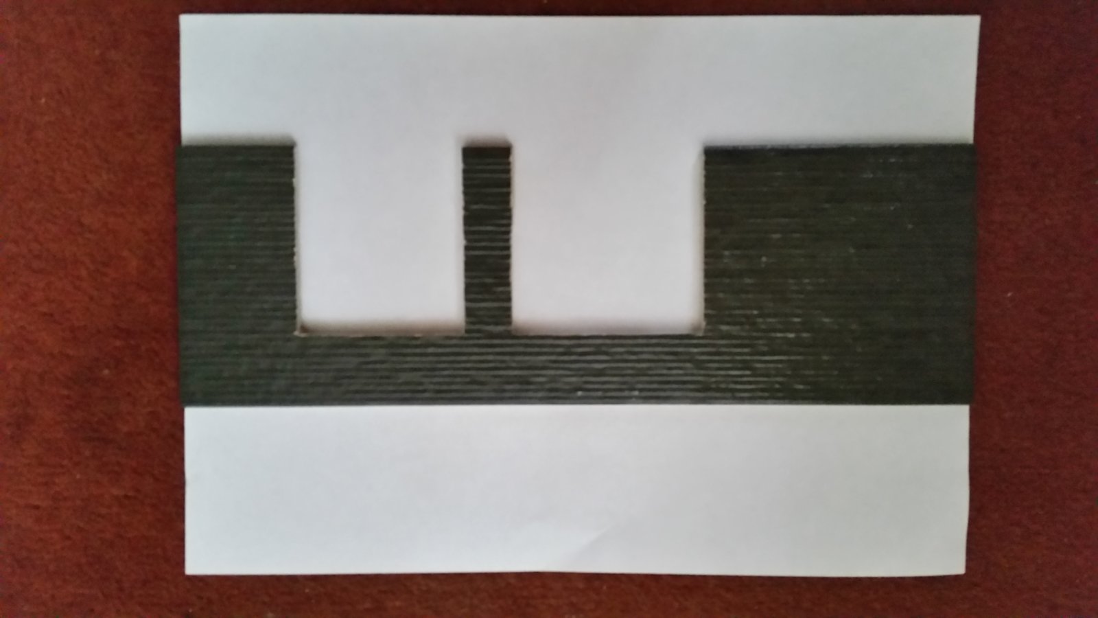

Looking at the images, the Dremel allows you make small cuts that wouldn't be possible with an angle grinder or wet bed cutter because the diameter of the blade is too large.
My old Rubi wet cutter has a removable blade guard, allowing me to drop the tile down on to the blade but it takes a lot of practice to land the tile in the right place given that you are pretty much doing it blind.
I could replicate Keithmac's cut out with my Rubi but the thinner cut outs would not be as crisp, and I would probably ruin 5 tiles in the process of trying to get it right.

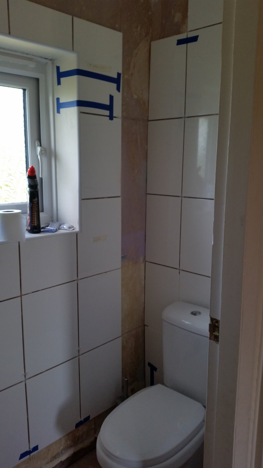

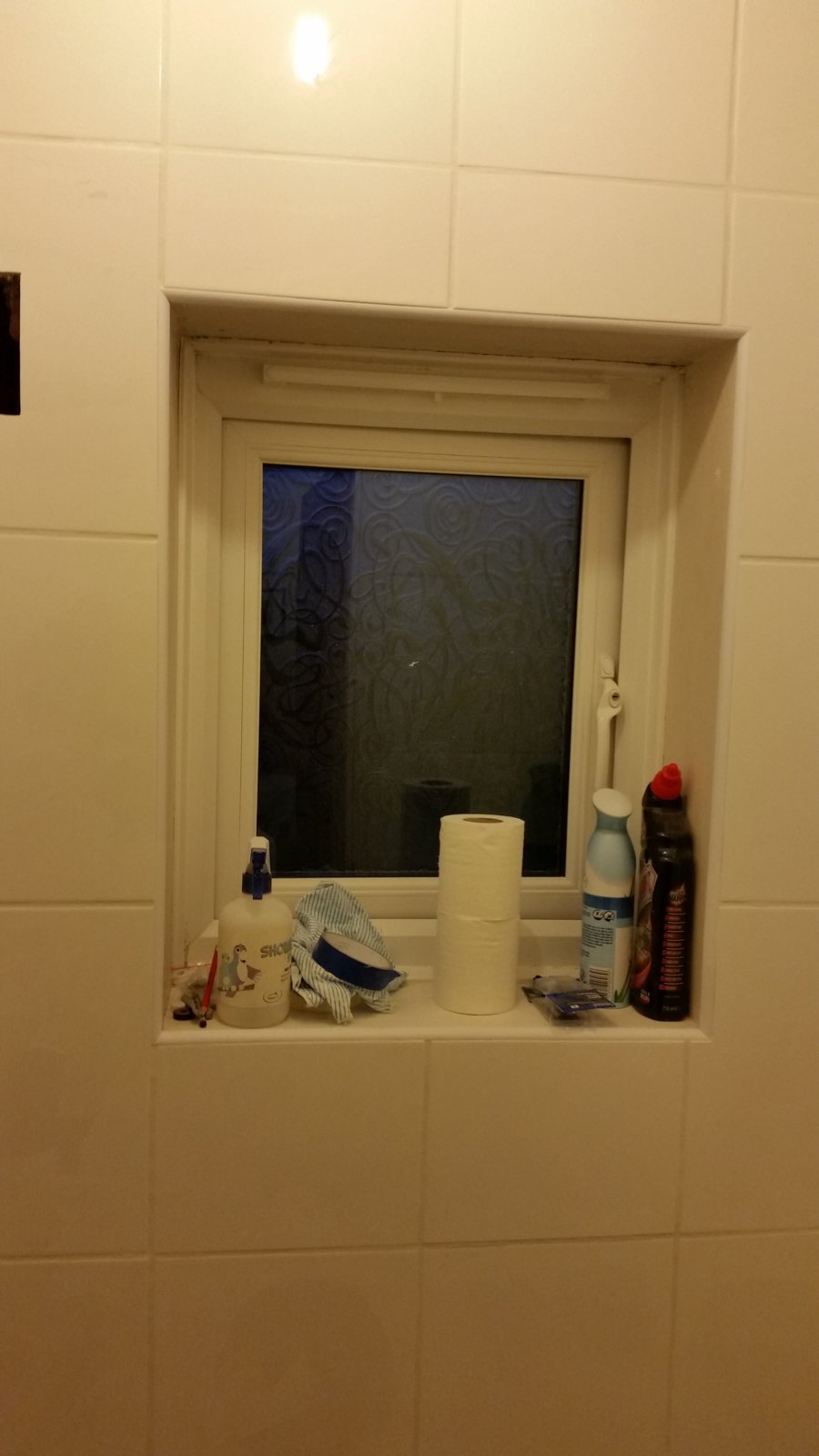

I used the wet cutter and manual sliding cutter for the WC.
Tiles were shiny side up and slow and steady through the wet cutter and it worked fine. You can dress the cut afterwards but I only did that with a couple of tiles.
As opps says, you can drop a tile onto the wet cutter, the corners will have a cut back though so again slow and steady.
Dremel with diamond disk gave sharper edges but took longer.
I just made it up as I went along really and stuck with what works best!.
