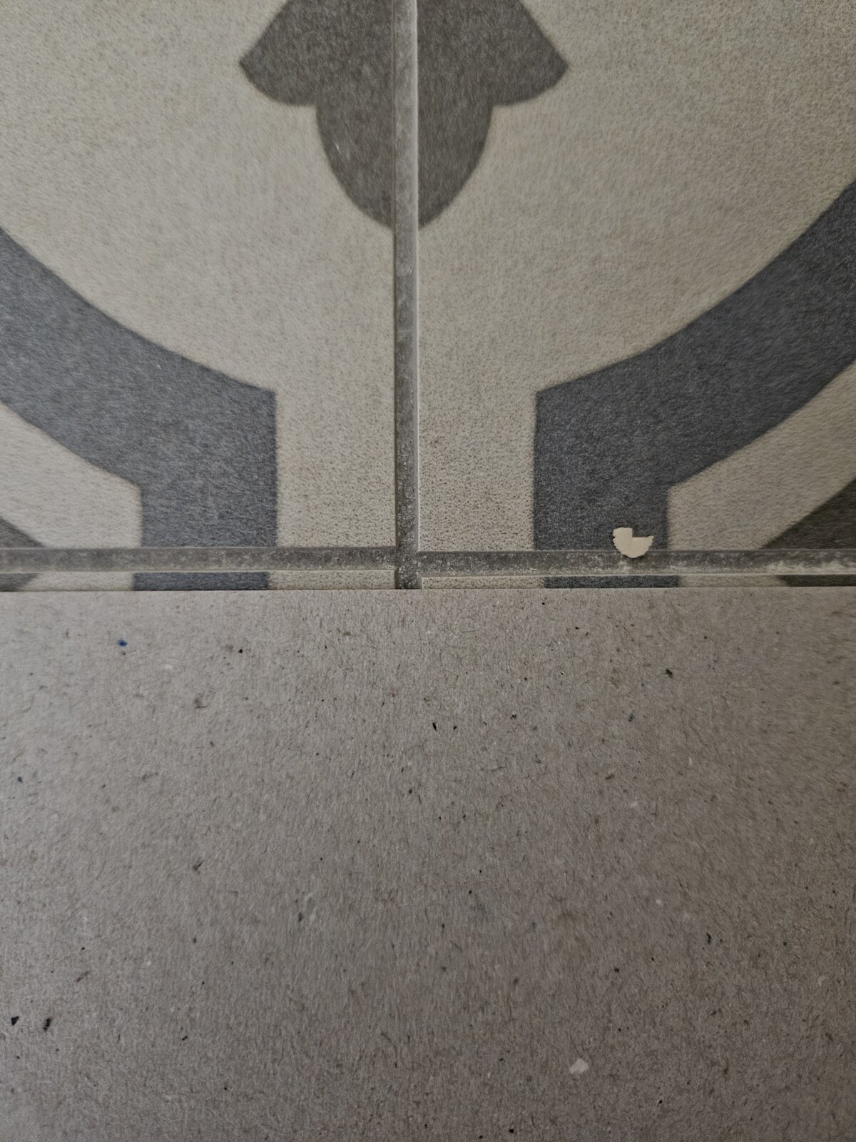

Hi all, I'm after some advice. We're having our kitchen redone at the moment and we think the tilers have done a bad job. Firstly, the tiles aren't at right angles to any of the walls in the room. The tiler said they did it via one wall, but I've shown that the entire grid is slightly off axis by around 1.5cm over 3metres. The fitter says we're overthinking it, but I'm annoyed that every angle is off by the same amount.

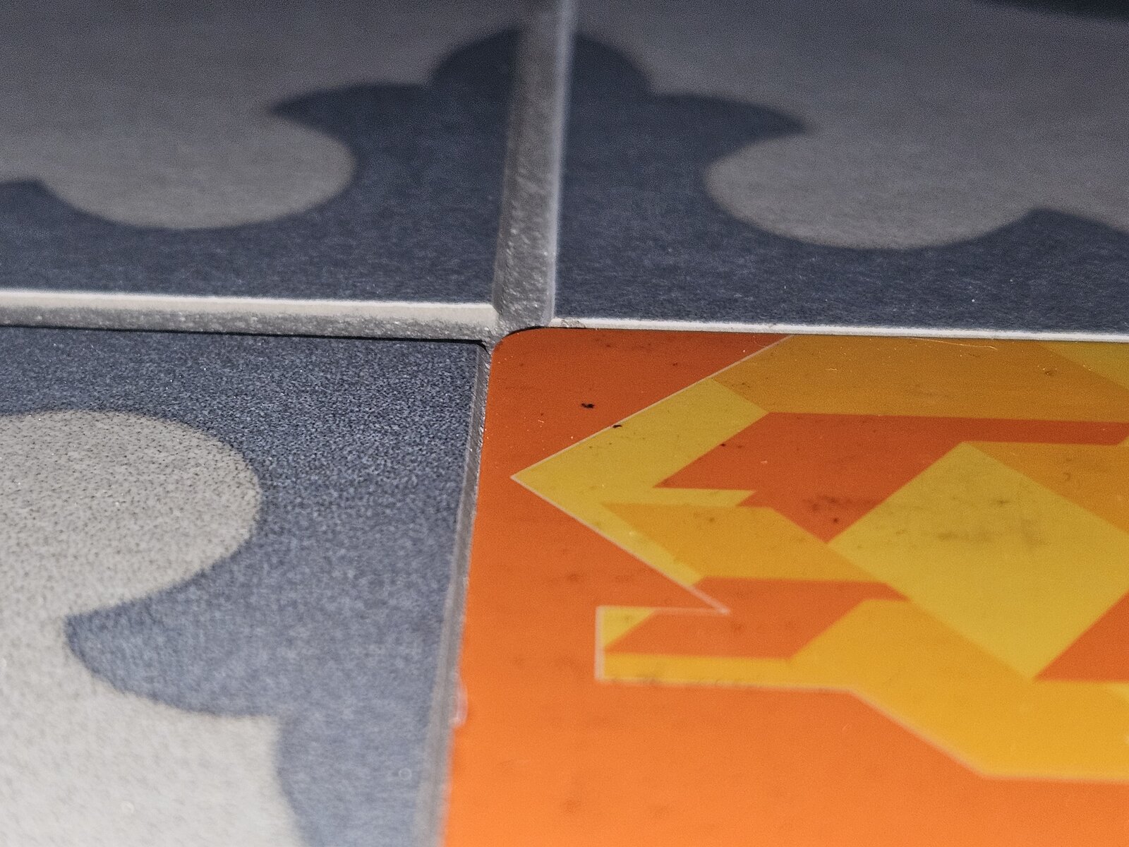

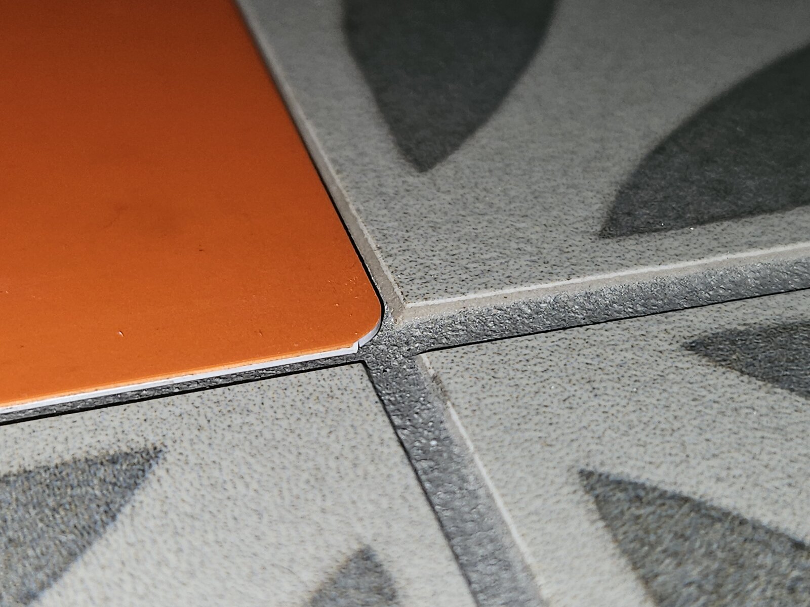

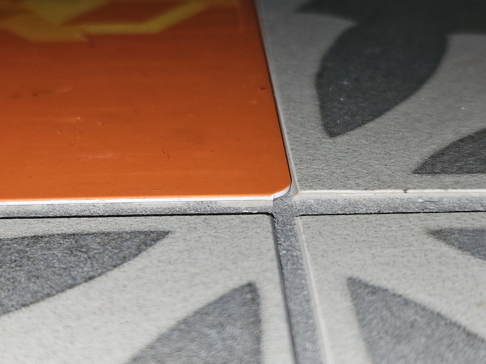

Secondly, there's lippage all over the place. Despite having used floor leveller, a large number of tiles are not flat so our feet catch the edges. It's just over the width of a bank card, which I've used to demonstrate in the attached photos.
Bearing in mind the tiles laid separately in our bathroom are completely flat, I feel this is just a bad quality job that should be done again. But is this actually an acceptable amount of lippage?
Your advice would be greatly received. Thanks
If you pay for a pro job, it should be perfect or extremely close to it. Pic 3 seems to show significant lippage in excess of the 1mm that is acceptable for grout lines <6mm. That is not acceptable. State now in no uncertain terms you will not be paying for that quality of tiling - it needs doing again.

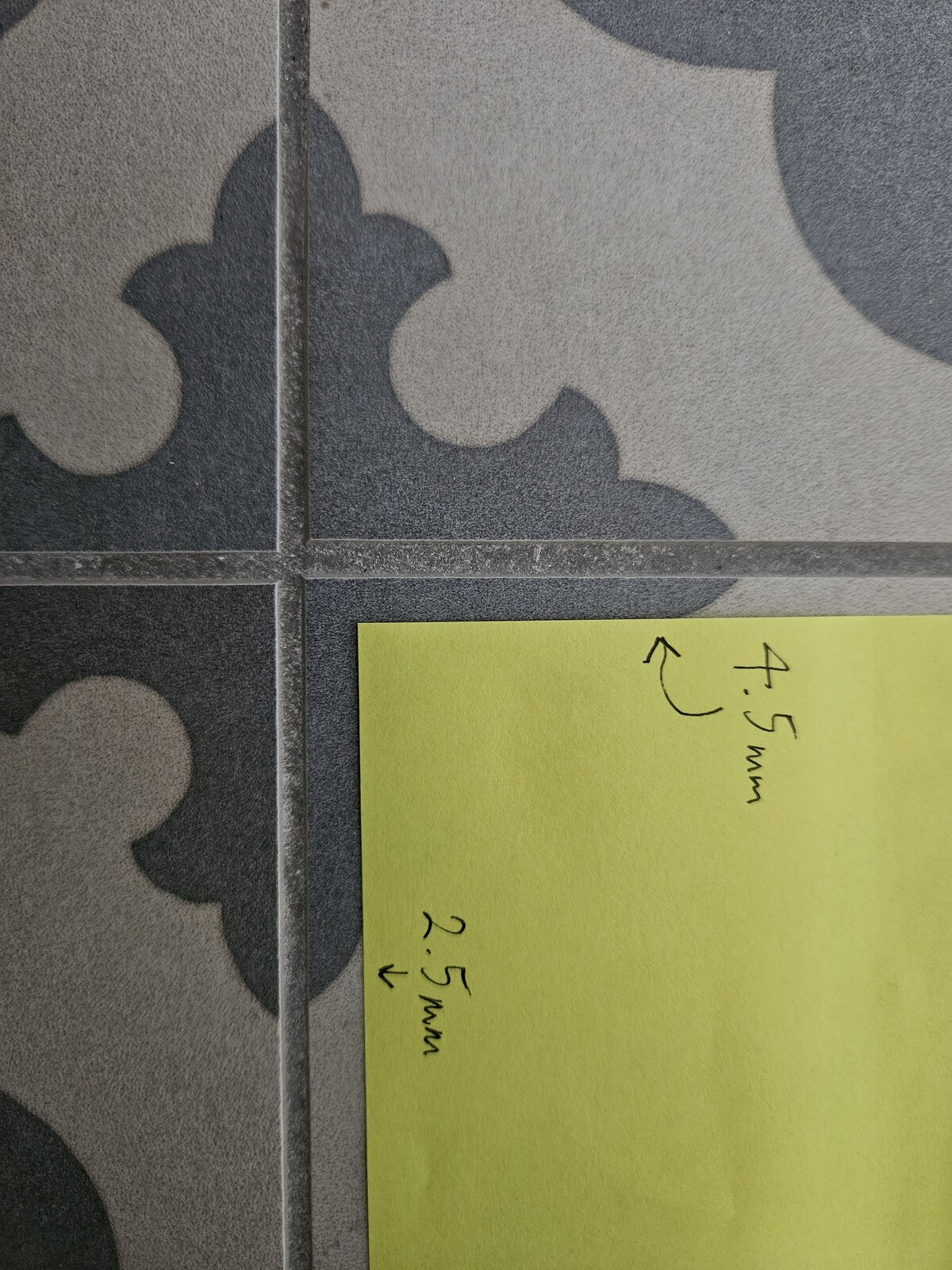

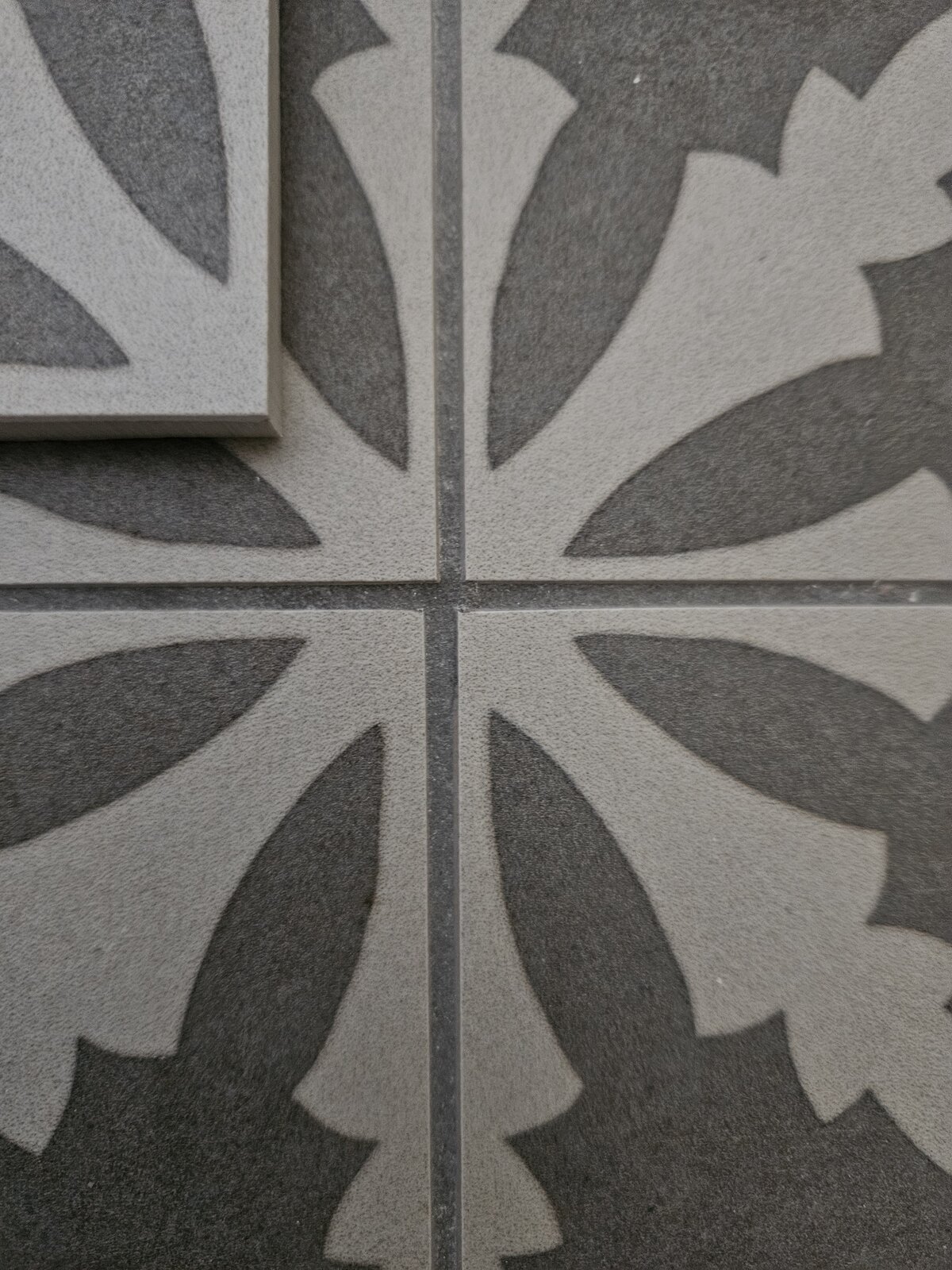

Thank you to all who have replied. We've gone back to thinking that the whole lot needs redoing as we've found a litany of inaccuracies. Most notably, tiles not aligned straight, staircase and gap inconsistencies (as much as 2mm vs 4.5mm). My thinking is that these are all indicators of a poor job, rather than us being too picky, but I'd appreciate the thoughts of any tiles on here.

Check that the tiles are all exactly the same size and it's definitely the alignment rather than size
Yep, we checked them all for damage before the job, and they're all exactly the same size.
Didn't he use spacers or levelling systems?
That's not the standard of a pro tiler.
I'm not a pro tiler, so I take my time to get near perfection.
I've seen pros do a bathroom in 2 days perfectly; would take me a week to achieve the same results.
Someone mentioned bent tiles and I can confirm that, especially with modern large tiles which are a bummer to keep flat.
Got to choose each tile to match the bend in the previous one.
Not your case of course.
