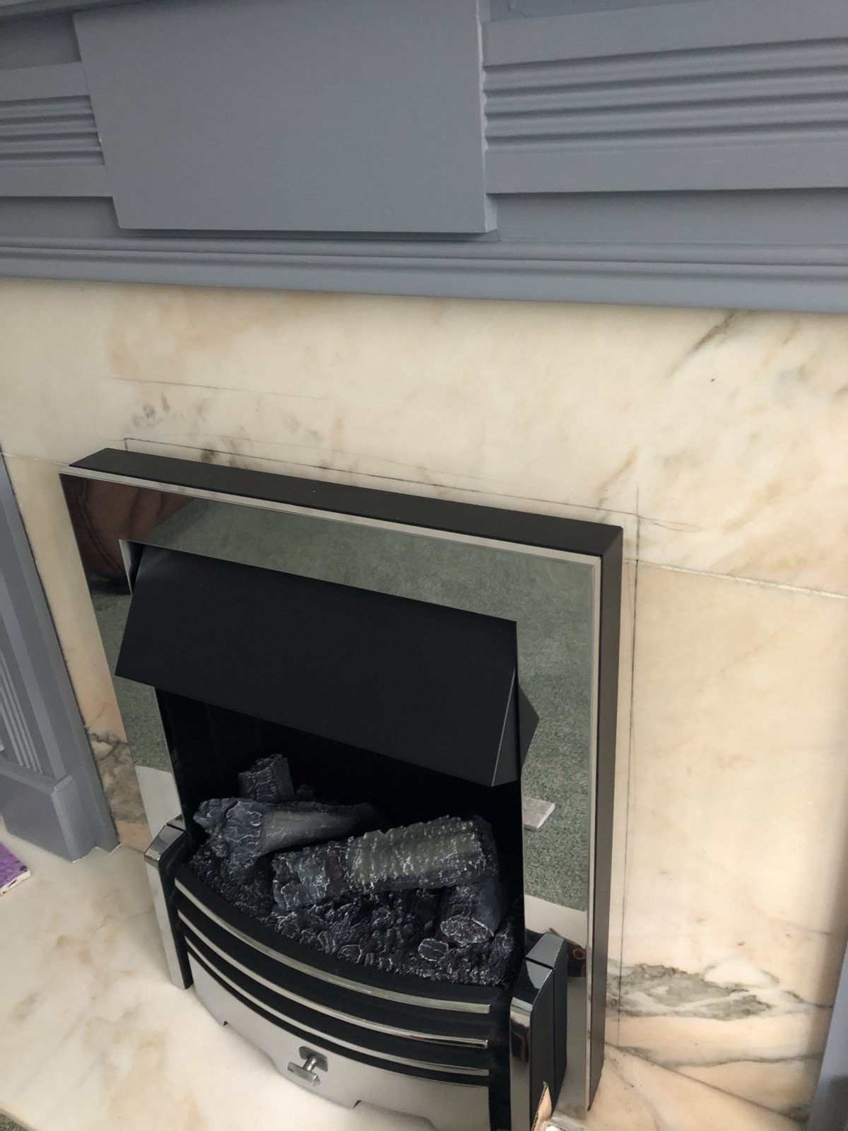

I want to tile over an out dated marble surround (see picture).
I was planning to scratch the old marble and then PVA.

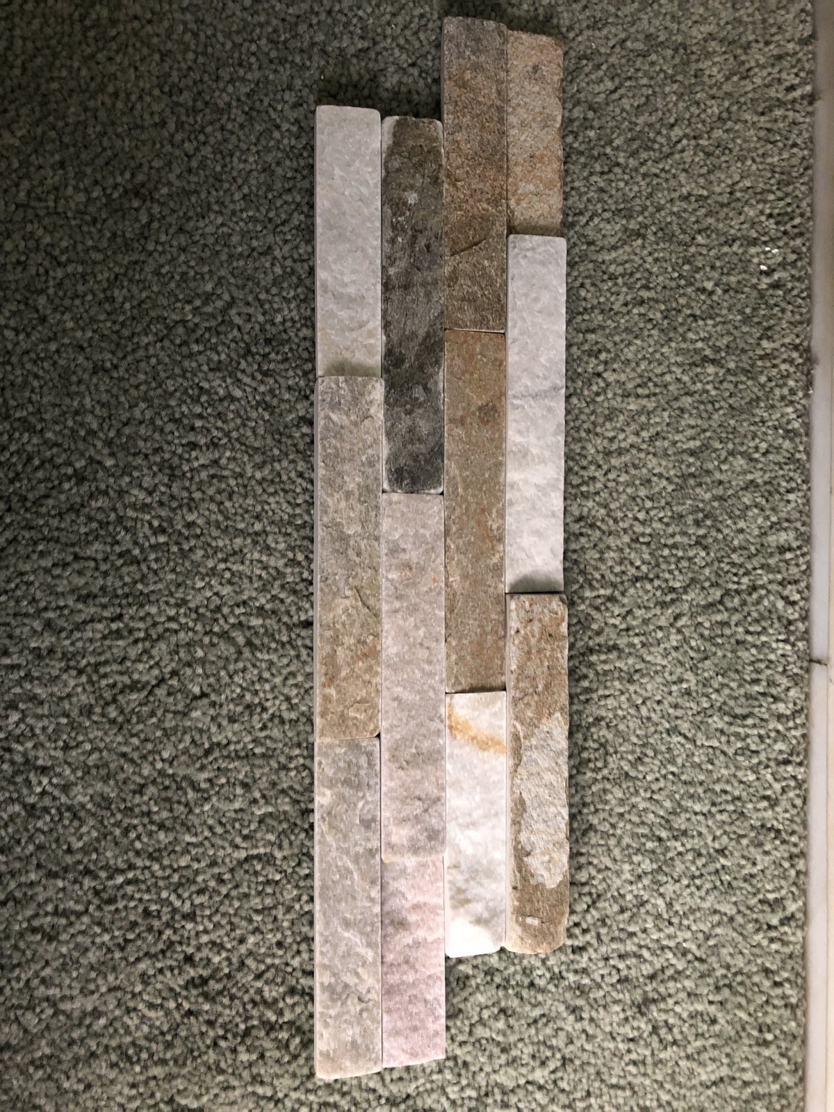

Then use a cement based flex adhesive to fix the new tiles (see picture)

I'd use a strong contact adhesive to fix a suitably sized piece of hardboard and fix the tiles to that. If the marble has a high gloss finish I doubt a pva base will hold anything more than a sheet of paper.
Thanks for your reply. Just so I understand you would suggest sticking the hardboard to the old marble?
