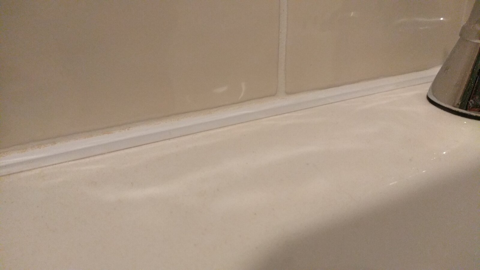

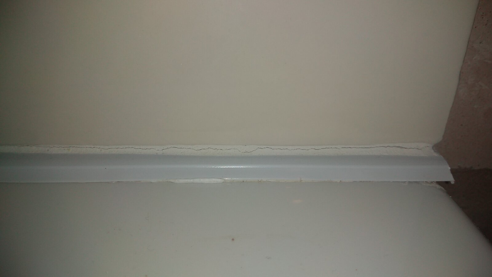

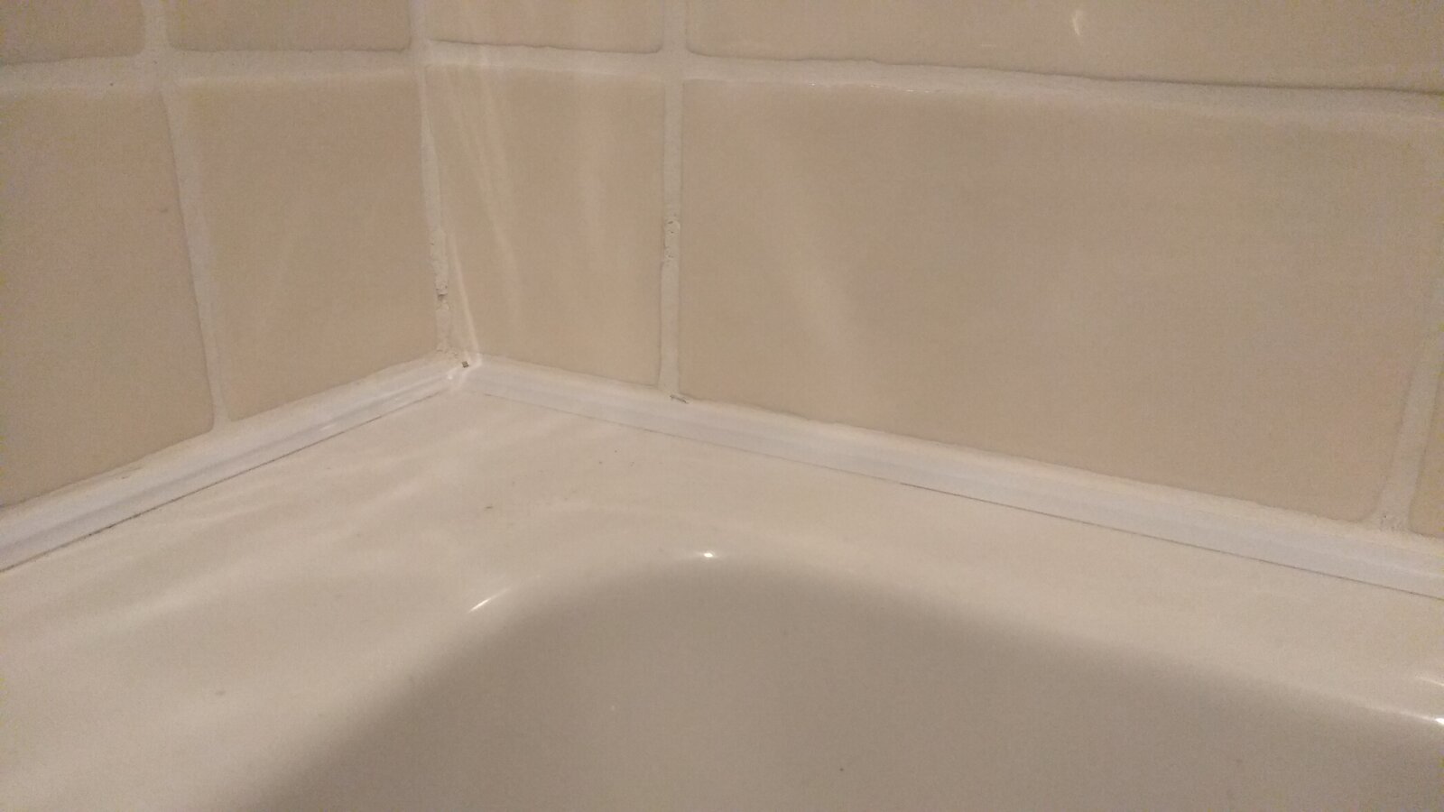

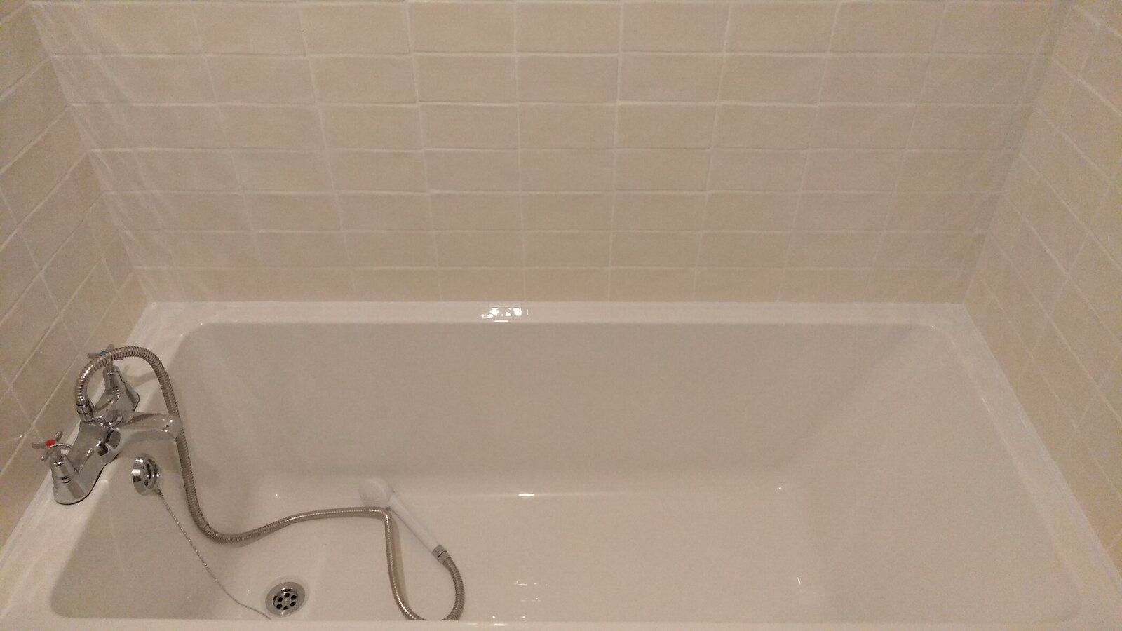

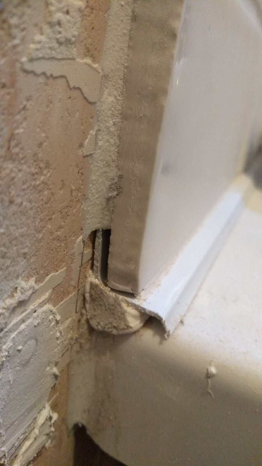

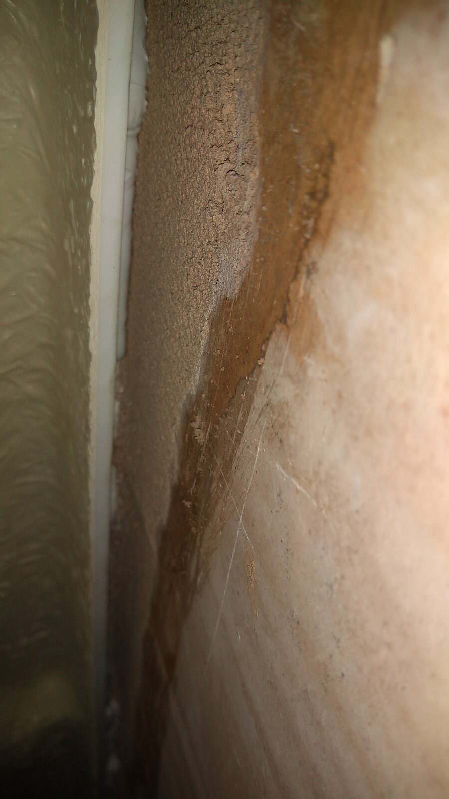

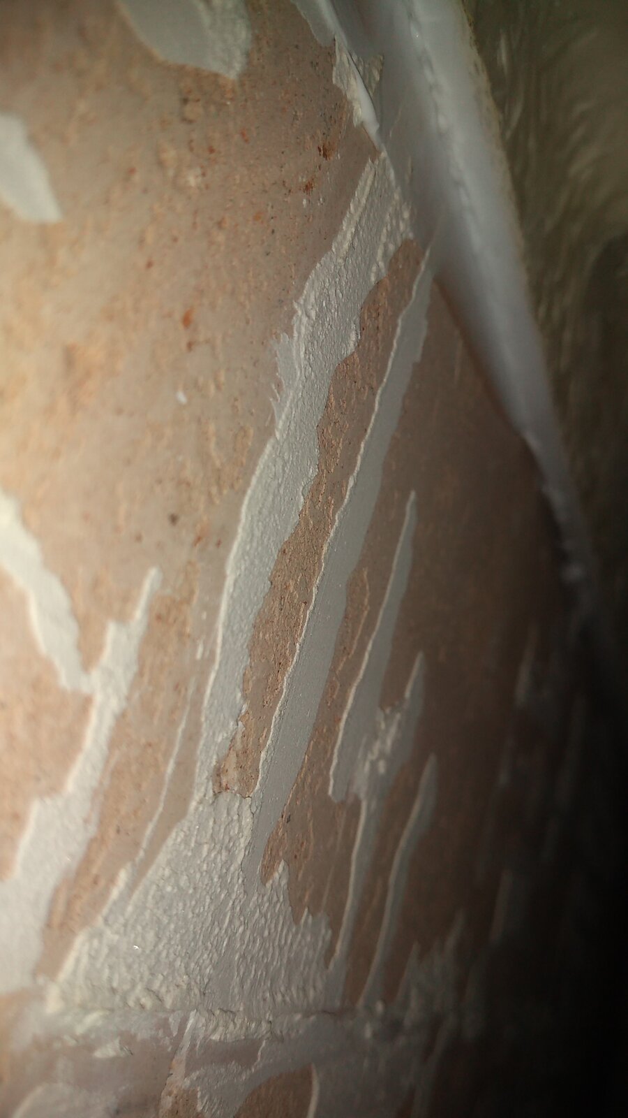

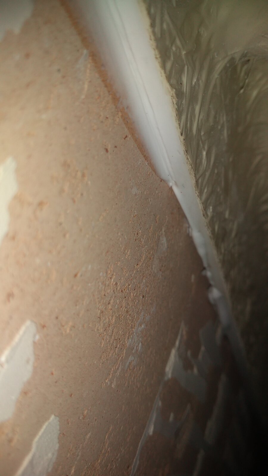

I'll post some more photos below. The first two show where the tiles and trim meet the wall at the end of the bath. That shows better how the tiles sit on the trim. and the type of trim profile that was used, which may give a better clue as to what it is. Photos 3 and 4 show the silicone from beneath the bath - at the head end (applied before the tiler came), and photos 5 and 6 show the same at the tap end.
Any further thoughts most welcomed and thanks for the help so far :)

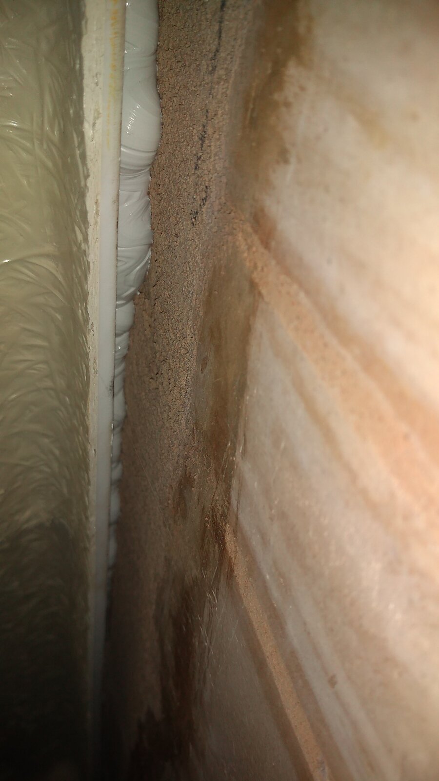

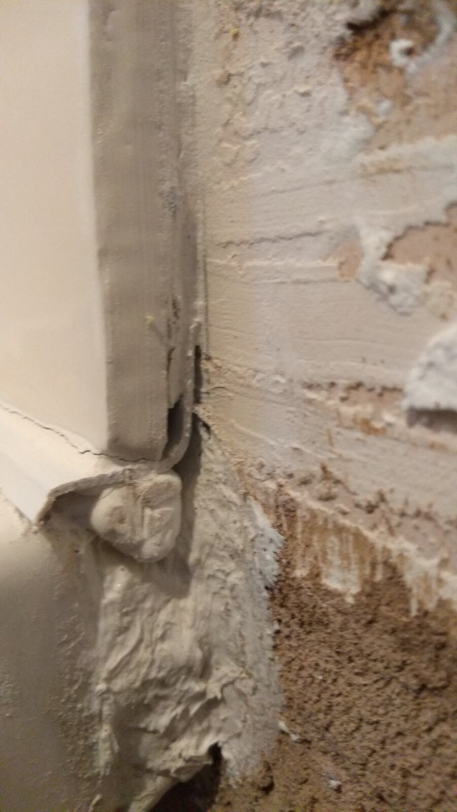

Certainly got enough silicone in there so as long as he filled the bath and let it set with weight in it, it should hopefully stay watertight.

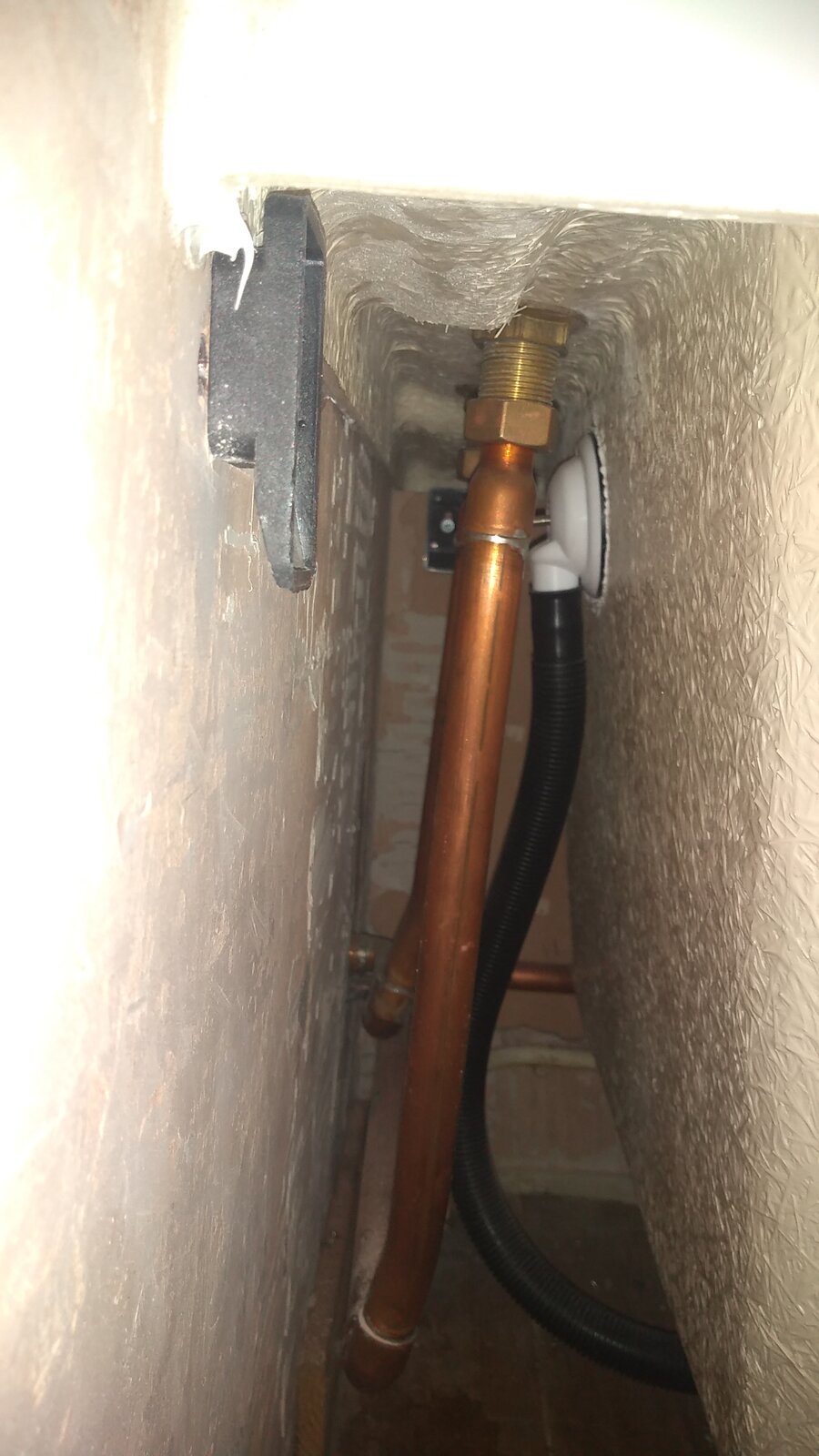

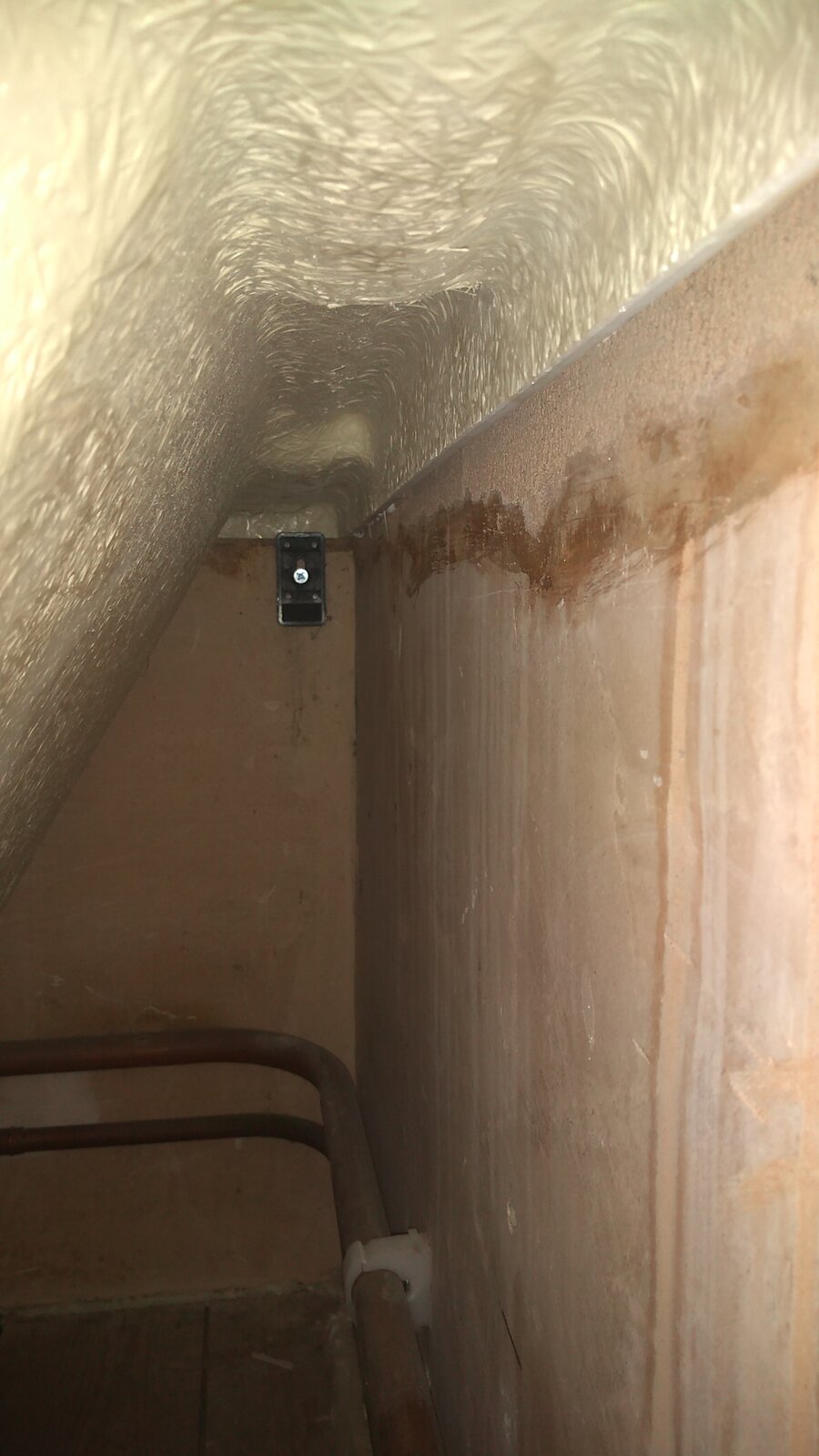

Not to add to the list but there doesn't seem to be any support under the edges of that bath, no batons etc? What is the bath sitting on? Ideally you want a small baton on each of the left and right corners to stop the bath deflecting when and hand and weight is put onto it. Ideally there would be a larger one along the back too.
Well, it would probably work.....
But its a grot-fest once water gets under the seal and you have to hope its 100% filled else the water will find the weakness.

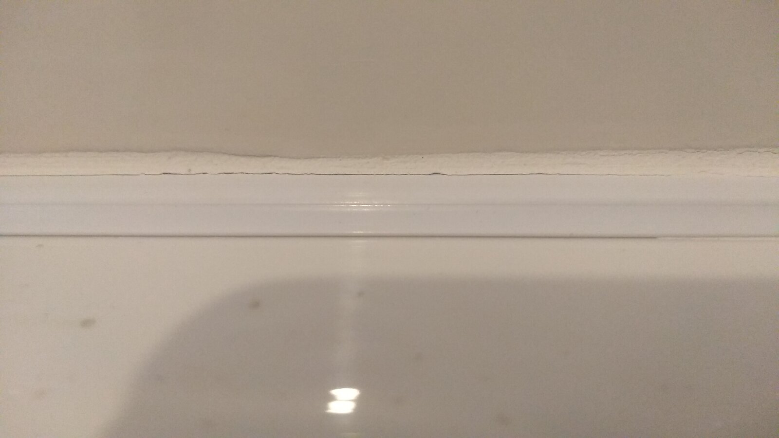

Nope. Bathed wasn't filled when he initially siliconed, nor when the tiler grouted. We've only used the bath once so far and there's definitely cracks appearing, as @ktuludays spotted (they might have got worse since the bath but it's hard to say):
No worries RE adding to the list! It's best to know these things. The bath came with 4 small plastic wall brackets. He used 3 of those. Aside from the it's just sitting on the legs/feet that came with the bath. I'll add a photo showing the brackets in situ. Is all that enough, or should there have been batons?

Apart from aesthetics, the cracks in the grout wouldn't worry me too much, the design and install nature of the tile edge is such that water cant track under. I would run a little bead of silicone along it to tidy it up and seal it. The plastic brackets are ok, as long as they are nice and secure in the wall. They're not what I would use, I throw them away all the time and use wooden batons along the long and short edge as I don't believe those small brackets provide enough support along the length of the bath edge but that's just me.
The idea of filling the bath is to compress the seal as it sets. Once it's sets then it holds the bath securely so when a weight is added to the bath, it doesn't compress/move as much and therefore stressing the joint.

Regarding baton, I got in touch with the bath manufacturer (Carron). I had been confused by the installation guide which showed wood within the lip of the bath. They have confirmed that there is wood encapsulated into the resin and that all is needed is the feet and wall brackets. He said baton can be used in addition if fitting the bath to a non-supporting wall. All the walls around our bath are solid, so I think we're ok on that front.

If the tile themselves are stable and the grout between them is solid. The just rake out the loose grout between tiles and seal and fill with a minimal fillet of silicone.
As suggested I don't think the cracking grout would cause a problem with it being watertight. Looks like there is plenty of silicone between the bath edge and wall and under the plastic tile trim. The water won't capillary back as the trim has an upstand behind the tile so just take out the loose grout and seal that and it should be fine.
What has happened is that the sealing strip is so well bonded to the bath that its being pulled away from the grout when the bath moves, hense the crack.
Given the way its all out together, that is never going to change.
So, replacing the grout with sealant will be fine.
It won't stop the potential for leaks under the seal but thats discussed above.

Sorry if I've given the wrong impression, but there is no loose grout. The tiling has only completed a few weeks back and the bth has only been used once. It's all solid, just cracked, and potentially not what should have been used.
That all makes sense and I can see what you mean RE this preventing leaks beneath the bath, aside form the fact nothing was done with weight in the bath and this might compromise it. But aside from that, would it not be an issue water getting through cracks and into gaps and then not drying out and going manky?
