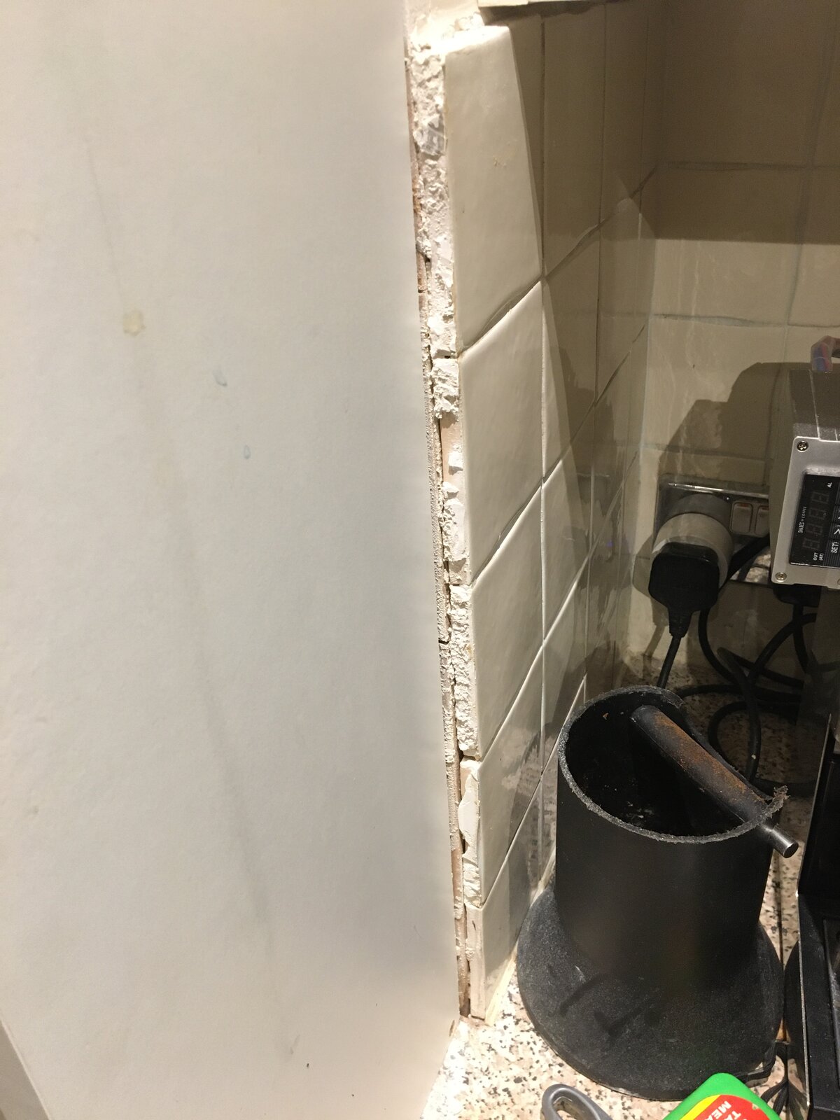

Is there any way to fit tile trim “retrospectively” to this corner (photo attached£ to tidy it up? I could remove the tiles and reattach them (with a piece of trim inserted) but I wondered if there was a short cut here?
thank you
Alan
(Almost zero knowledge of tiling)

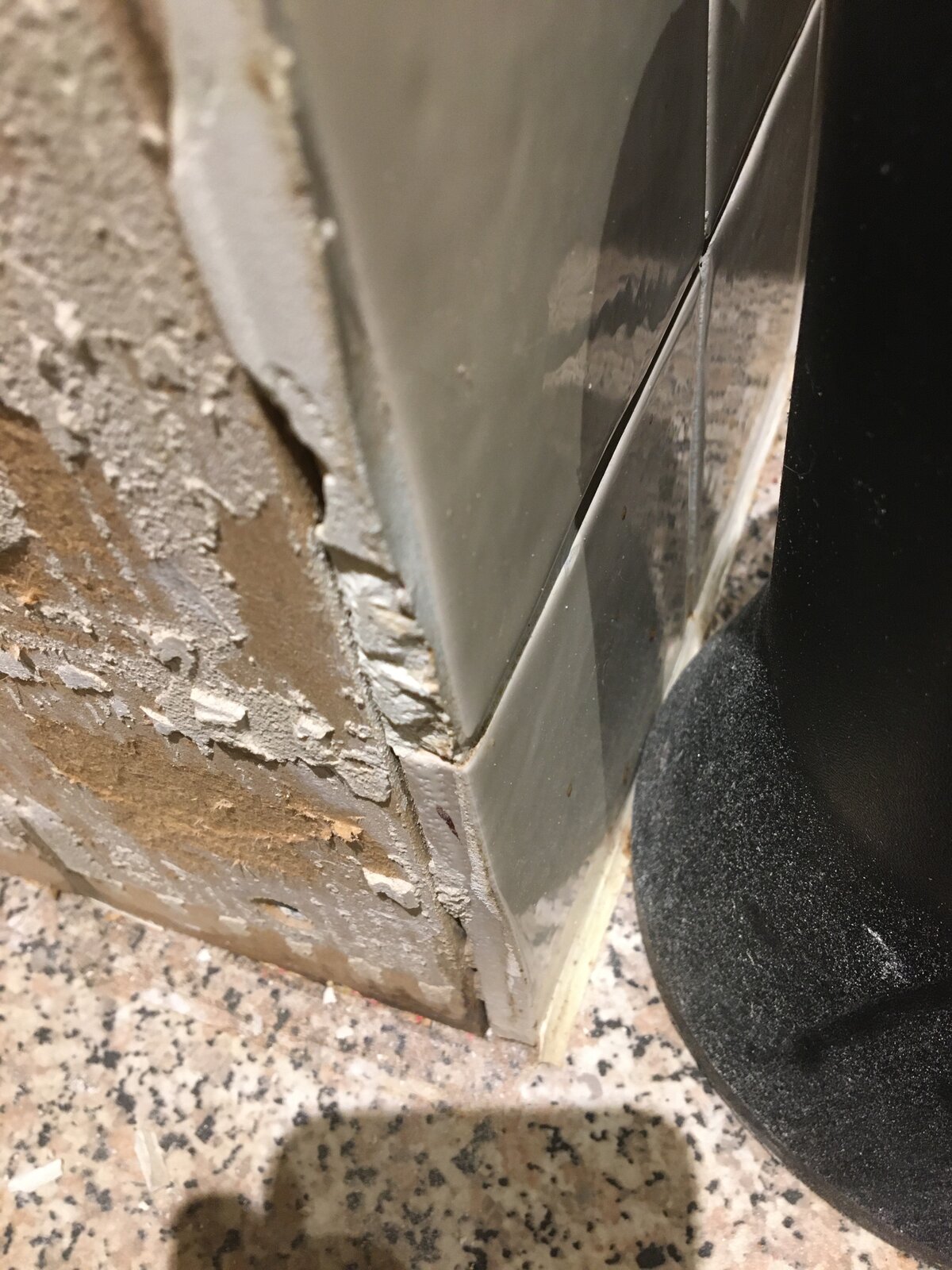

In fact...it might be helpful if I showed you the kitchen cabinet in situ:

If you carefully rake out a little adhesive from rear of tiles and clean end of tiles you can cut most of the lip of tile trim off and tuck it behind with a little silicon to secure.
Ah ok. Yes, I reckon I could manage that - sounds fairly straightforward. Thank you.
