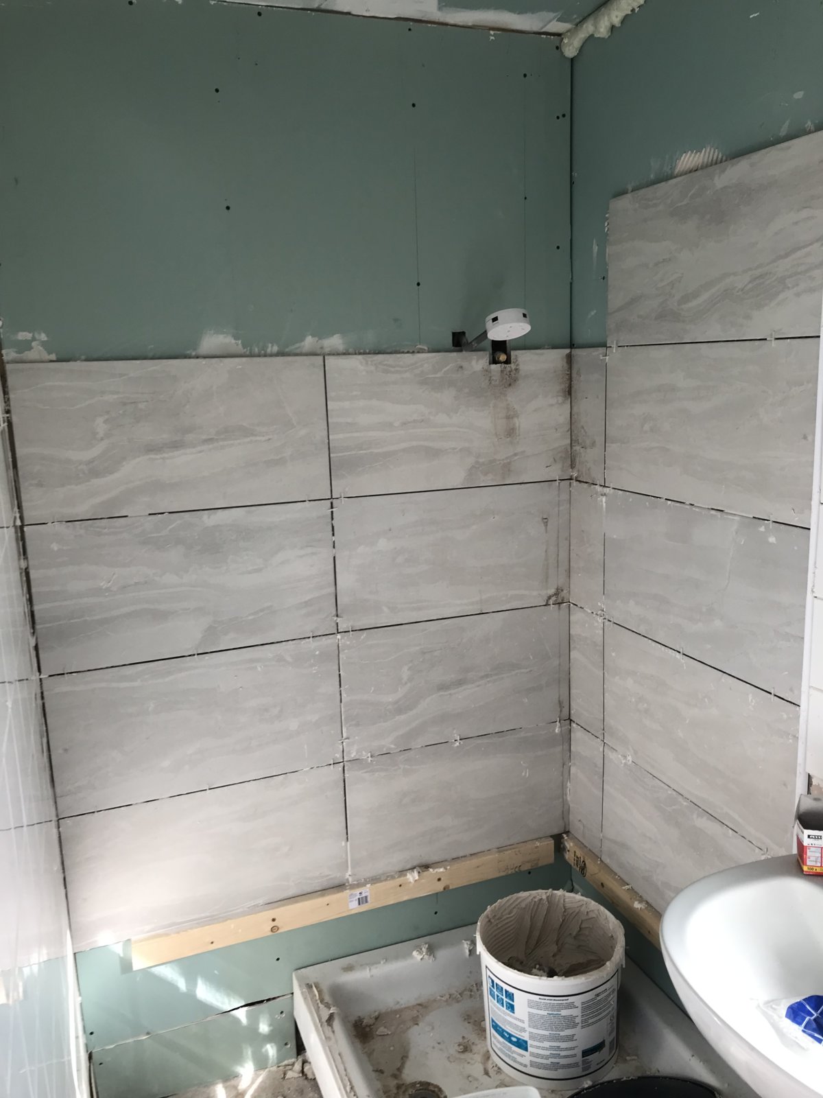

It seems funny looking back at it but want to make sure I learn the appropriate lessons from yesterday’s “disaster”.

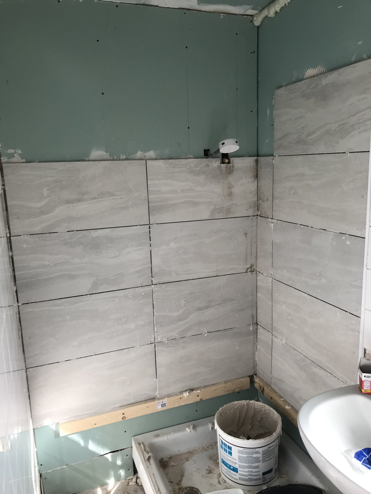

After spending approximately 7 hours, my brothers and I tiled up the shower area in the en-suite. I’ve attached a picture from earlier in the day but at this point it was all complete up to the battens screwed at the bottom.
Some 19 hours after the bottom tiles were done, I unscrewed the batten asked my brother to tidy up and I headed to fetch lunch. Calamity struck!

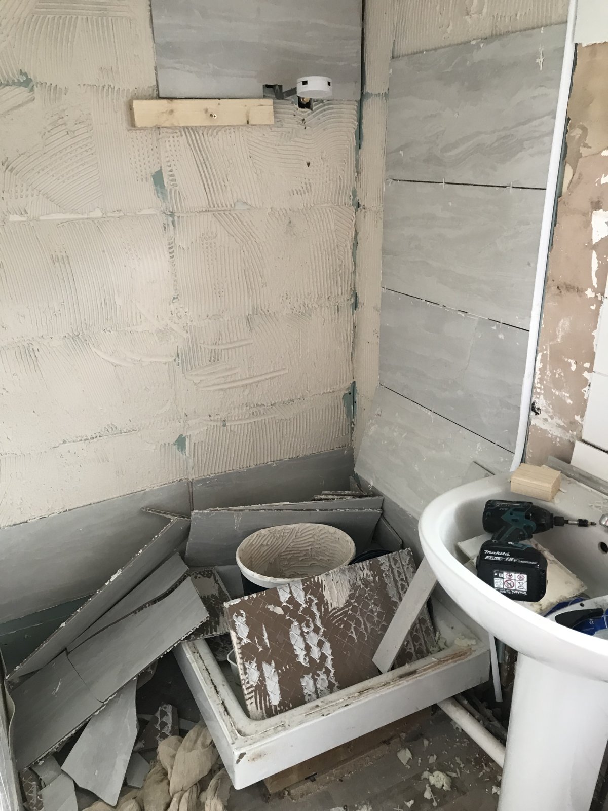

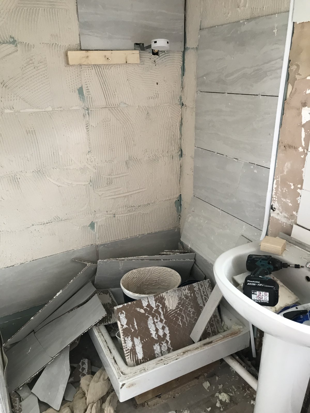

My world came crushing down on me when my brother called to say that all the tiles were dropping off the walls. I was in disbelief as I’ve never experienced anything like it. Even my first ever tiling job using the cheapest tiles and adhesive are stuck on the wall 7 years on. Admittedly the don’t look pretty!
When I got back, the situation had moved on...

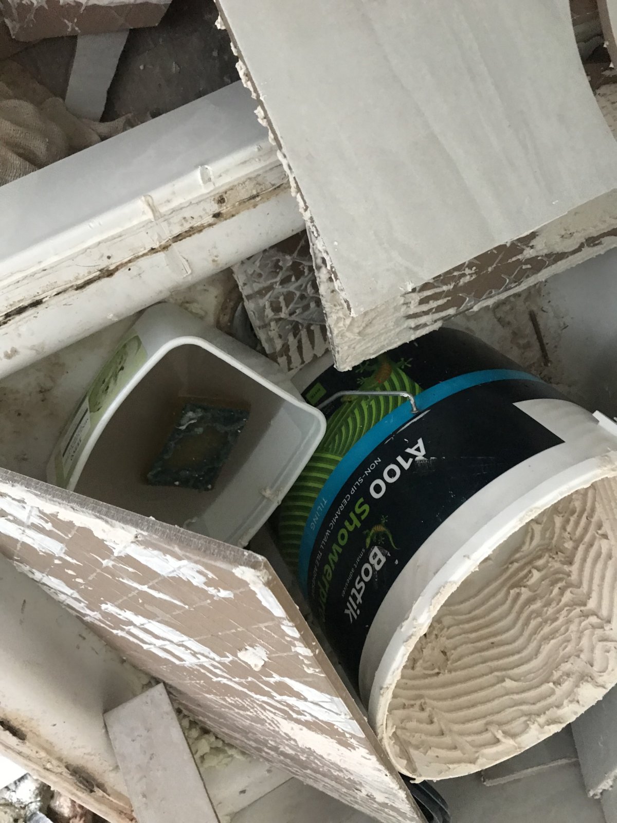

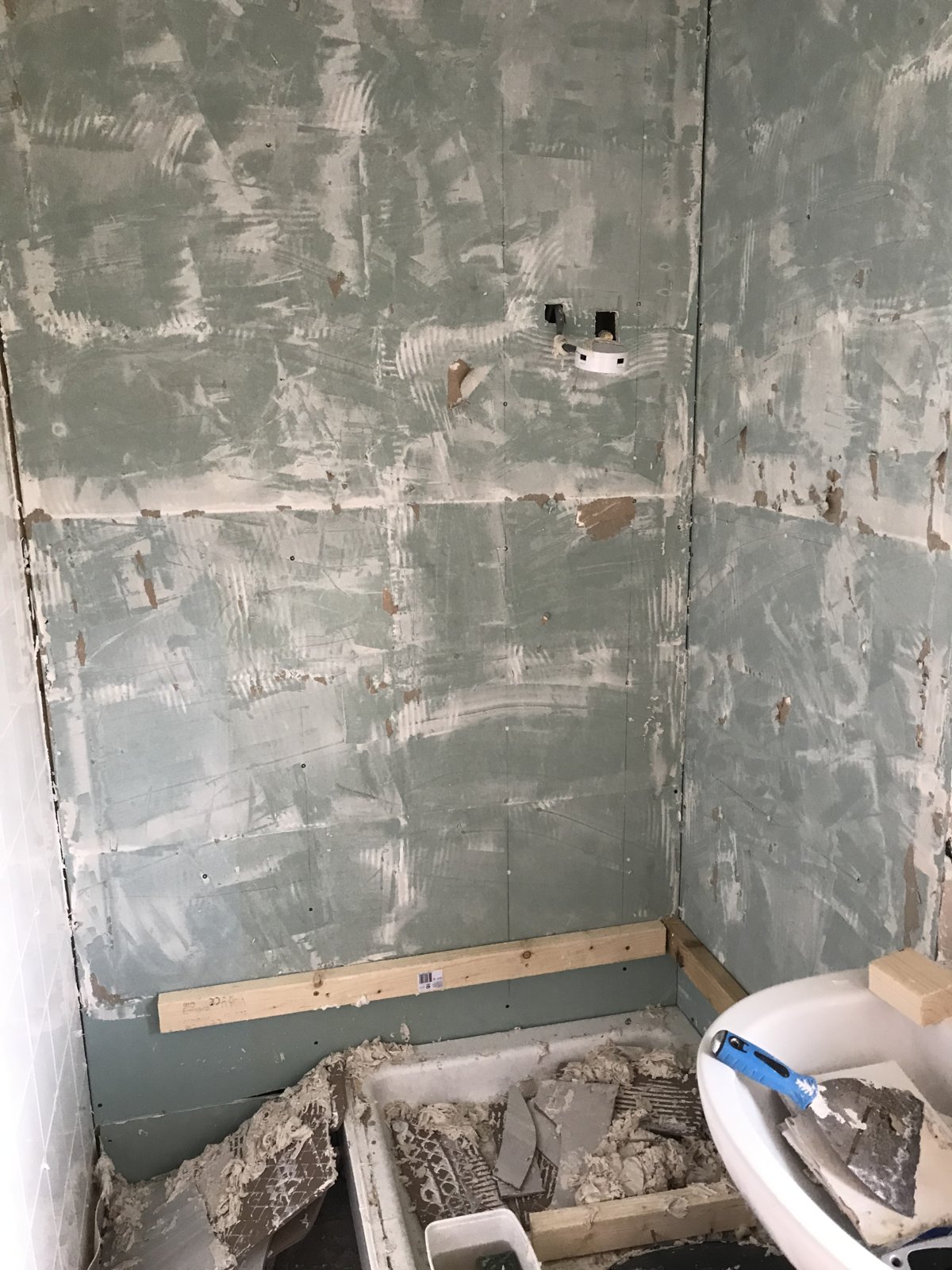

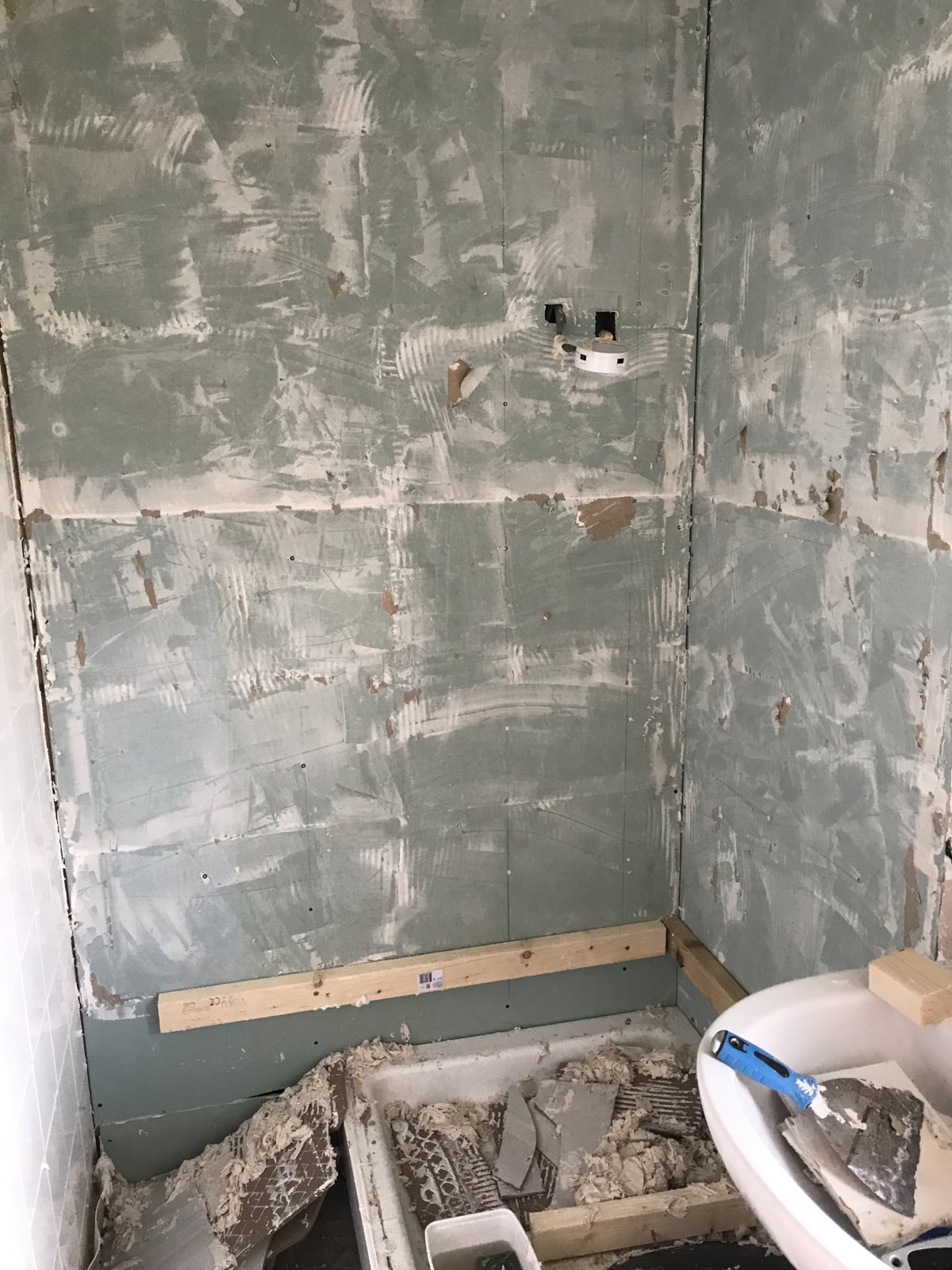

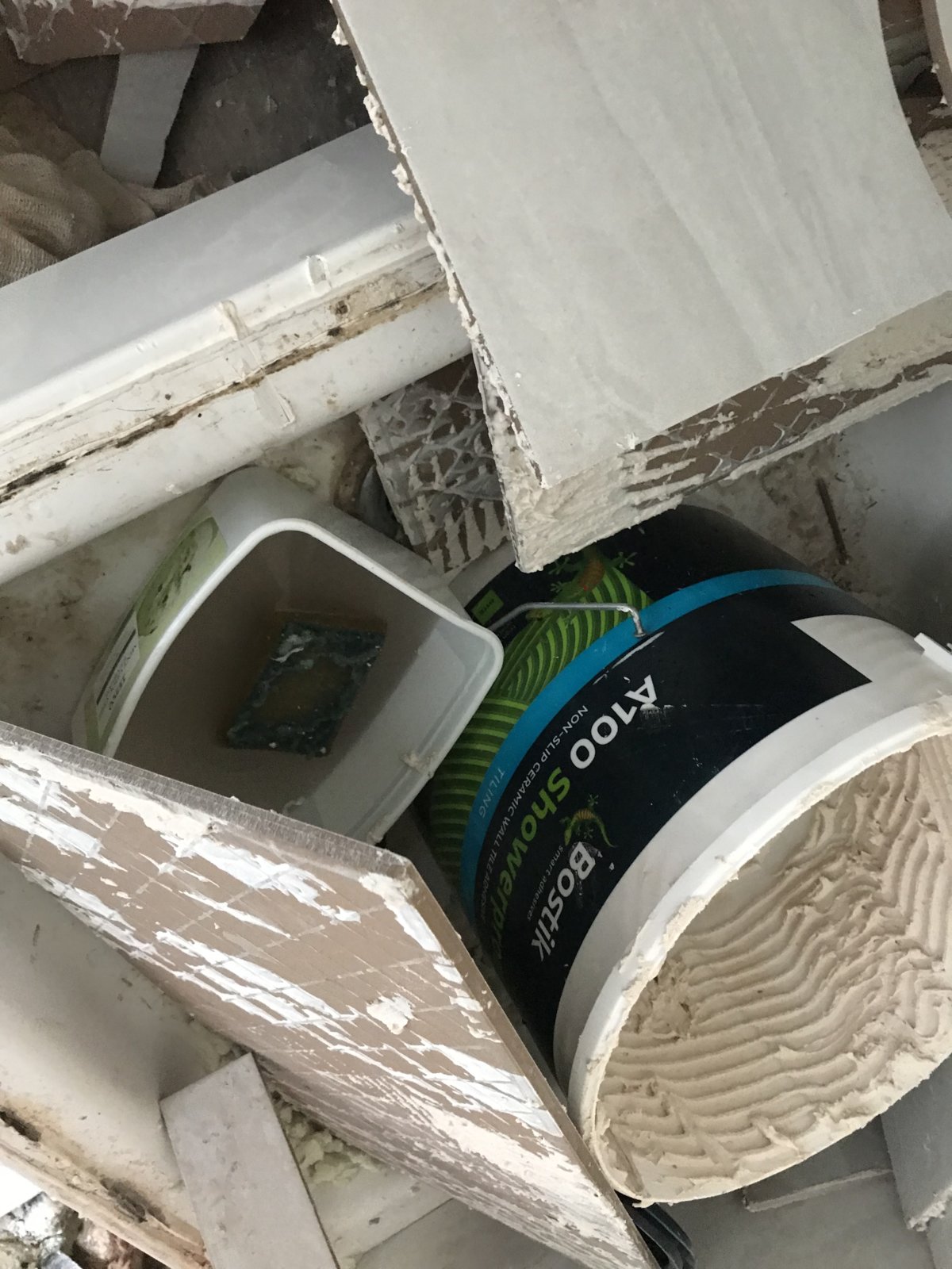

Almost all the tiles were off. The adhesive was almost entirely wet.
I took my frustration out at Wickes (wanted me to contact Bostik and arrange site visit...) and then plucked up the courage to dust my self off and go again! I naively put it down to the brand of adhesive I used for the first time (Bostik). Pic attached. You can also see how easy it was to clear off the boards.
I used Mapie adhesive the second time around and am now complete above the batten. I now need to remove the batten at some point and finish off below that.

Hellish bad luck that, but I prefer to use adhesive mixed from powder....being chemically setting rather than air drying its much more reliable - in my opinion!
Did you apply the adhesive to the wall or the tile - and did you press really hard to exclude the air?
John :)
Which bagged stuff do you recommend John? I applied adhesive to the boards and speed it out using a notched trowel. I did press the tiles home
The tiles are not bonded to the adhesive enough, you can see notched lines on wall where tile has not been in contact with adhesive.
It will be better to butter back of tile as you go.

No pro would use ready mix.

Not good!. I used premixed bucket adhesive for some small format tiles and it was ok (took 2 days to go off).
The hand mixed powder adhesives are far superior, takes a bit longer to mix but that's the only drawback.
I've used powdered on all our tiles since, same size as yours in picture.

Has the heat/humidity played a factor here? I don’t understand why the tile adhesive was still very wet. I need to understand this as it will determine when I should pull the battens off the current tiles - which have also used premixed adhesive...

Is your backer board waterproof, water resistant?. If so the water has no where to go if you use premixed buckets, will take an age to dry out.
The power mix cures as someone's already said so far better for that application.
I back butter my wall tiles vertical comb on the tile and horizontal comb on the wall, much better "grab" that way.
