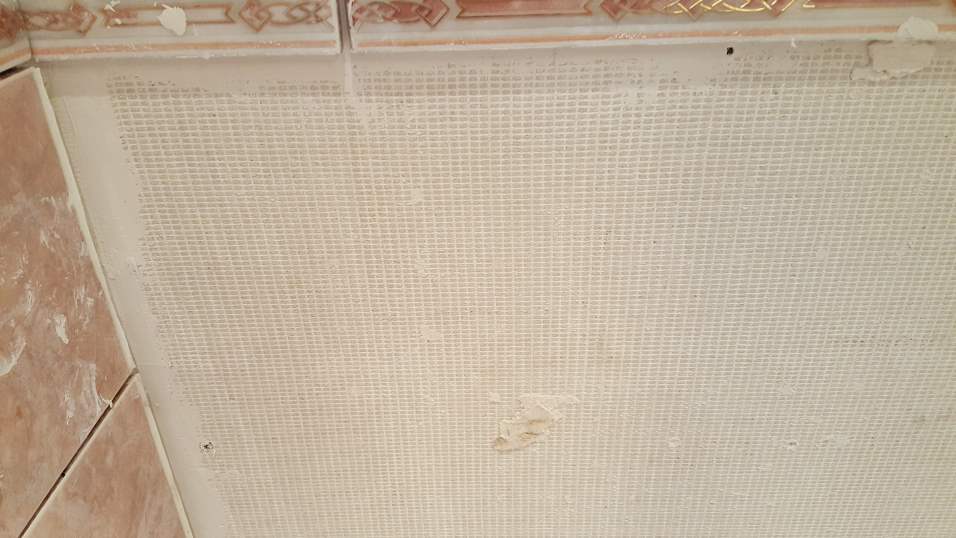

Today I find that none of the tiles on the backer board walls have stuck properly – they’re dropping off, so I just pulled them all off again. As you can see from the epics below, the tiles are covered with adhesive, stuck firmly – but virtually no adhesive has adhered to the backer board.
So the problem seems to be with the backer board. I somehow managed to miss the bit in the instructions which said I should seal it first with acrylic primer, so I’m going to do that – but do you think that’s definitely the problem, or have I done something else monumentally stupid?

You've clearly identified that the tile adhesive works well on the old sections of wall, and not on the new backer board; could it be that the moisture in the adhesive has been absorbed quickly into the board - thus the need to seal it. You may discover that the builders who didn't buy the expensive primer used a diluted PVA solution in lieu of it.
My opinion is that you will have much better results after applying the primer. Try not to allow the adhesive to dry out in hot weather*, as again this would lead to the adhesive not adhering as well as it could.

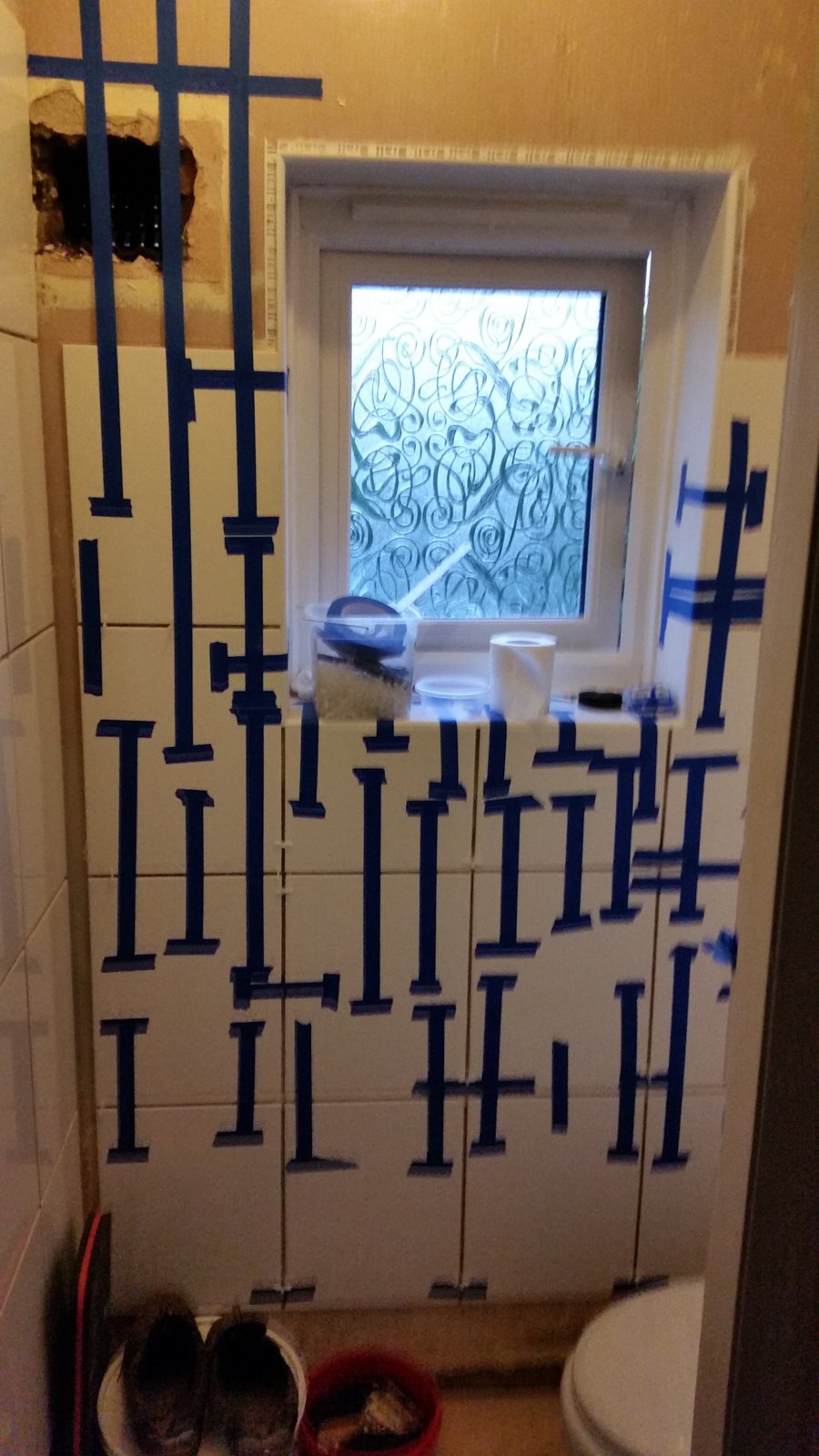

Hey, lovely job! I thought I was the only one who thought of using tape to hold them up :D
Well, I’d already stuck a row on using the pre-mixed tub, so it was kind of too late anyway. But I gave them a quick tug this morning, and they seem to be stuck very fast after pre-priming :censored::mad::LOL:
I was going to say thanks for the tip, I’ll mix my own stuff next time.. but believe me, there isn't going to be a next time…
I said that after tiling the kitchen but theres always a next time!.

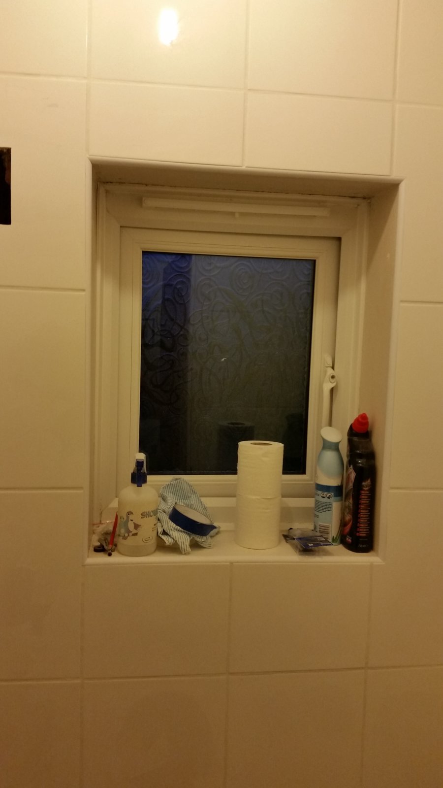

The blue heavy duty masking tape is great to hold them in position overnight while the adhesive sets up.
Nice to see you've sorted your problem out and good look with the rest of the tiling.

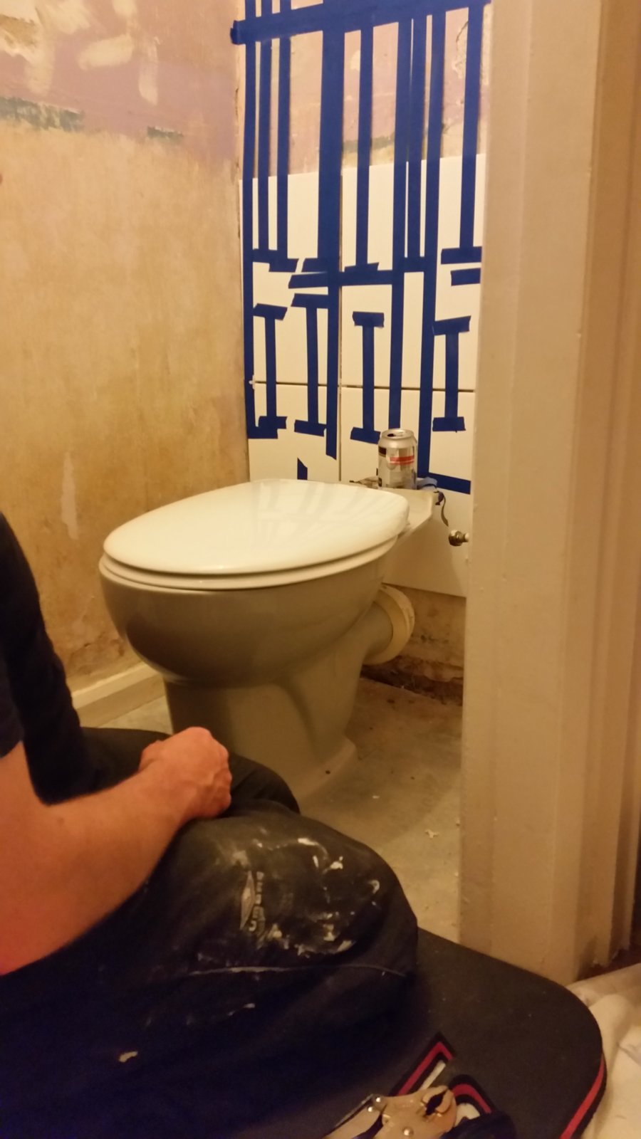

This is what I started out with, it was a right chew!.
HAH! With the greatest of respect, and to quote Monty Python, LUXURY.
This is what I started with...
My only real problem now is that, unaccountably, the shower trays available nowadays appear to be subtly different in size from the one which was fitted here, when the house was built in 1994, so my bottom course of tiles is an inch or two short of reaching it (so I’ll have a gap between the bottom course and the top of the tray) – also this tray is a true 760 x 760, whereas the old one seems to have been an inch or two bigger (had to smash it to remove it, so can’t be accurate), so I have a big gap round the sides too…
My tiles are also vintage 1994, so obviously no longer available – I guess I’ll have to run a narrow course of either plain pink, or white, round the bottom to make the deficit up… heigh ho…
You've top trumped me there!, although we only have 1 toilet so was a bit of a faf working around family toilet stops and flushing with a bucket!.
Pressure was on when I finally removed the old toilet and the new one leaked from the cistern fittings (took 3 goes to seal it all up properly!).
You've deffinitely got your work cut out there!, all worth it in the end though..
