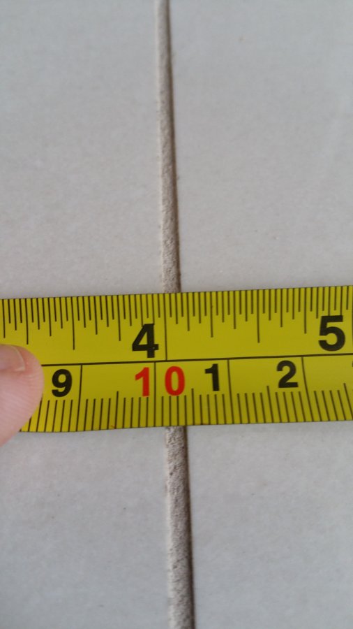

I cannot see any expansion joints, presuming i would be able to see them? It looks like the gaps are about 3mm pic attached.

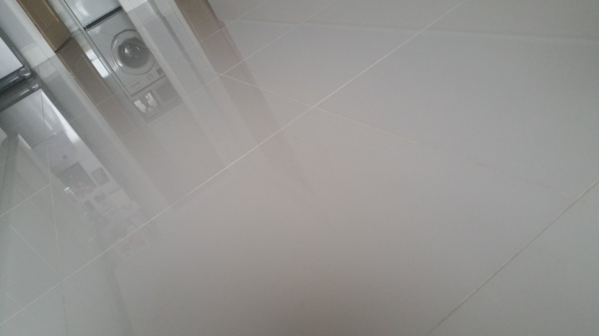

Hard to photo the whole area but I'd say in kitchen the tiles are not coming out yet 10 are lose ie when you walk on them you can hear and feel about a mm or more of movement you can tell it's loose...also the whole floor when lay down looking across it all the joints seem uneven where one corner or tile edge will be not level with the other creating a lip. .. this is less obvious in the hall I suspect as heating is not working. You can feel it when walking around in bare feet too...

Ok, its a start. The grout joints look ok.
With regards to the area, if all the rooms are directly connected, it is classed a one single tiled area. So the minimum place for expansion joints is through each tiled doorway. If an area exceeds 5 metres in either direction, there should be another expansion joint. And looking at your pictures, I can't see one.
It can get rather complicated as the standard for underfloor heating on a solid concrete base is that no bay should exceed an area of 8x5m. but with a potential flexible floor like heated asphalt, that need to be taken into account and they should be used more frequently. Now we just need to see whats happening beneath the tiles if possible :)
