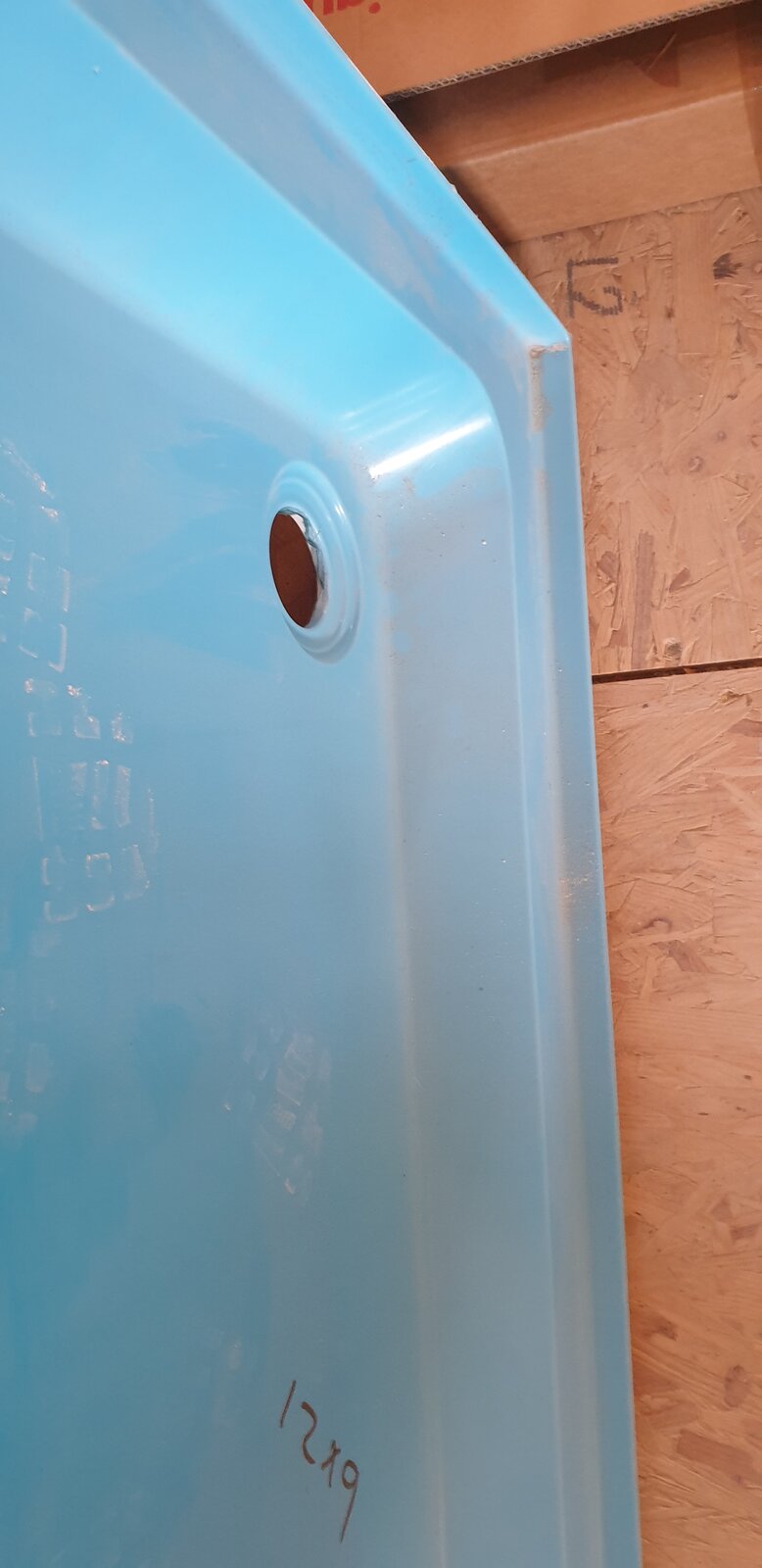

If you want to use the panels in an area that takes a lot of water like the shower, then best practice is to install the backer board, prices range a lot, abacus elements are expensive, or you can get much cheaper alternatives, have a look at wickes or your local merchants, ive seen some cheap deals on them. Moisture board will be fine if you make sure no water can get at it.
The weak point is always the joint where the waterproof panels meet the tray when the silicone bead fails, so if you use a shower tray tape something like the link below, it can keep any water from entering leaking down the back of the tray or coming into contact with the backer/plasterboard used. Then just your usual silicone bead between tray & wall panel to seal. Also add a bead to the corner and end profile trims if used.
The best shower trays for long term water "proofing" are the styles with edge rim fins/upstands on two or three sides.
The bottom course of tile (& vapour barrier) comes down over the fin/upstand but stands off the tray rim by about 5mm - 6mm, & is sealed in with silicone.
The stick-on upstand strips, in my limited experience, deteriorate after a few years and can become a nuisance
What material are the trays with the up stands, can you get them in stone resin or just in plastic type trays?

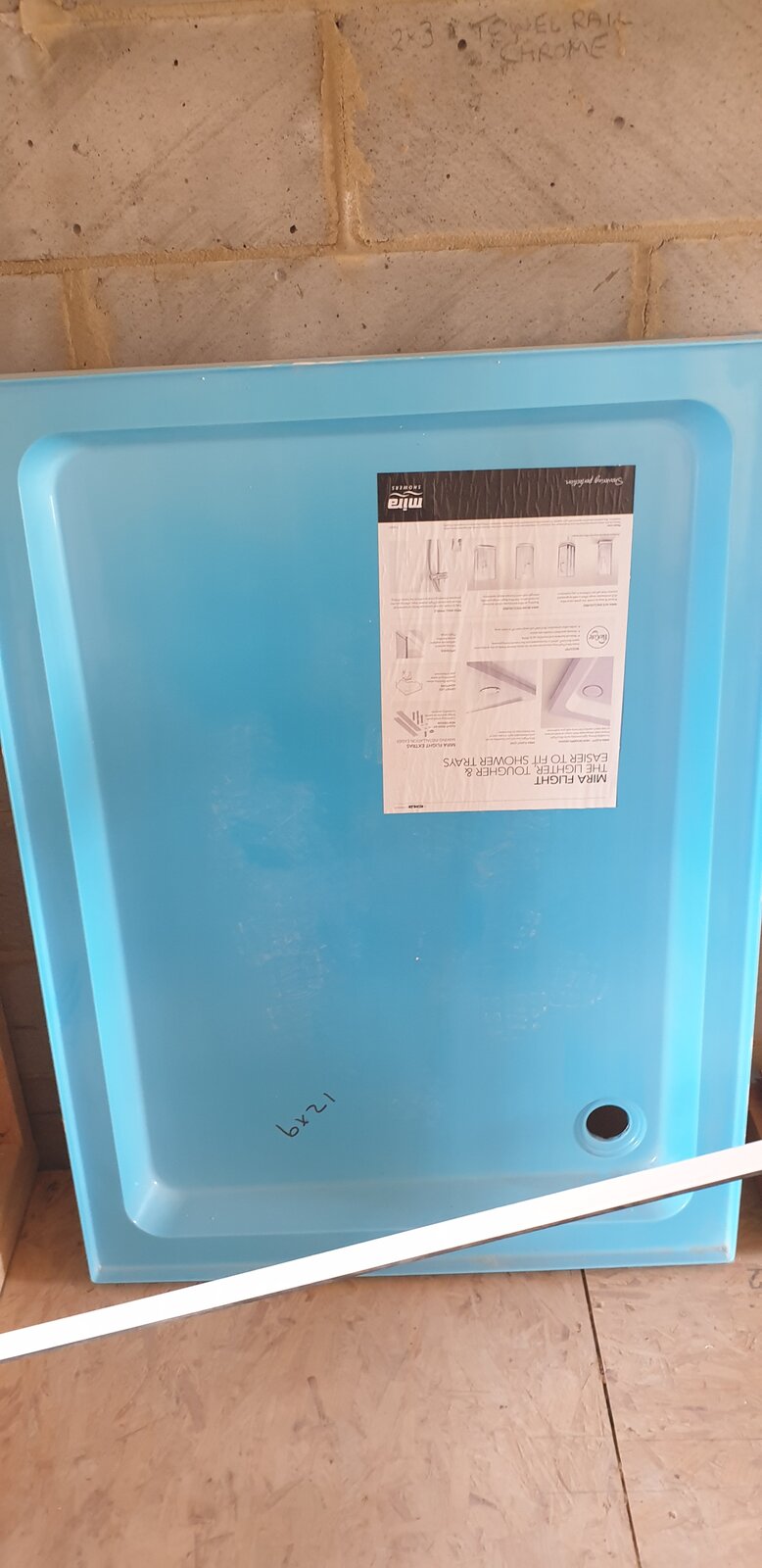

These are the ones I've got, upstand on all 4 sides so hopefully no leaks around the tray.
Mine are all Mira and I think they are resin as they are very heavy.

I'll get a photo of the shower tray and upload hopefully today.
I've had a look and seen the up stand trays, you can also get them with 3 up stands but less common and not MIRA.
