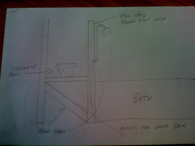

Guy, i'm planning on putting my sink above the stairs in my bathroom. as you will see from my very bad diagram i will have a wall either side so i need to put a panel at the front, i need to be able to remove this just in case i ever get a problem.
I would like to tile it so that it looks like its part of the wall. the wife has suggested putting a small door under the sink but i think this will look rubbish as she has picked brown tiles.
What would you use to make this panel? how would you fix it? there will be a timber frame that i can attach it to.
also, what would you use for the counter top as she wants this tiled too.
any help would be great
Why not make the whole panel a door? Hinge it either left or right. It can still be tiled. You can use a loft catch to keep it shut.
I was thinking this myself after reading another post.
What would you suggest i use for the door? could i attach the hinges to an aquapanel or should i use wood?
thanks

one more thing, what would you use for the counter top that i'm planning to stand the basin on, would you use aquapanel for that?
I tiled the end of a bath panel years ago, I held it in place with chrome domed mirror screws.
