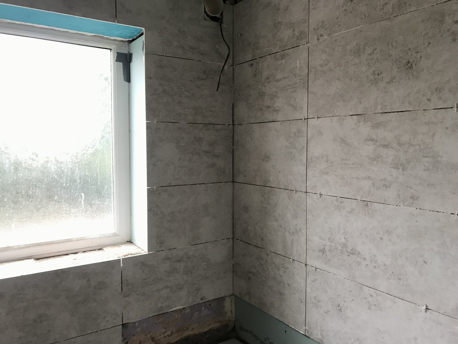

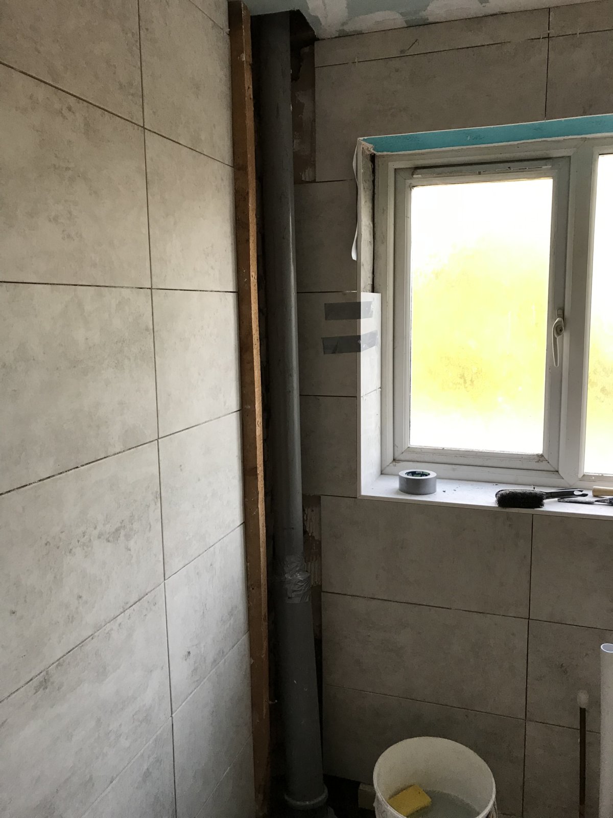

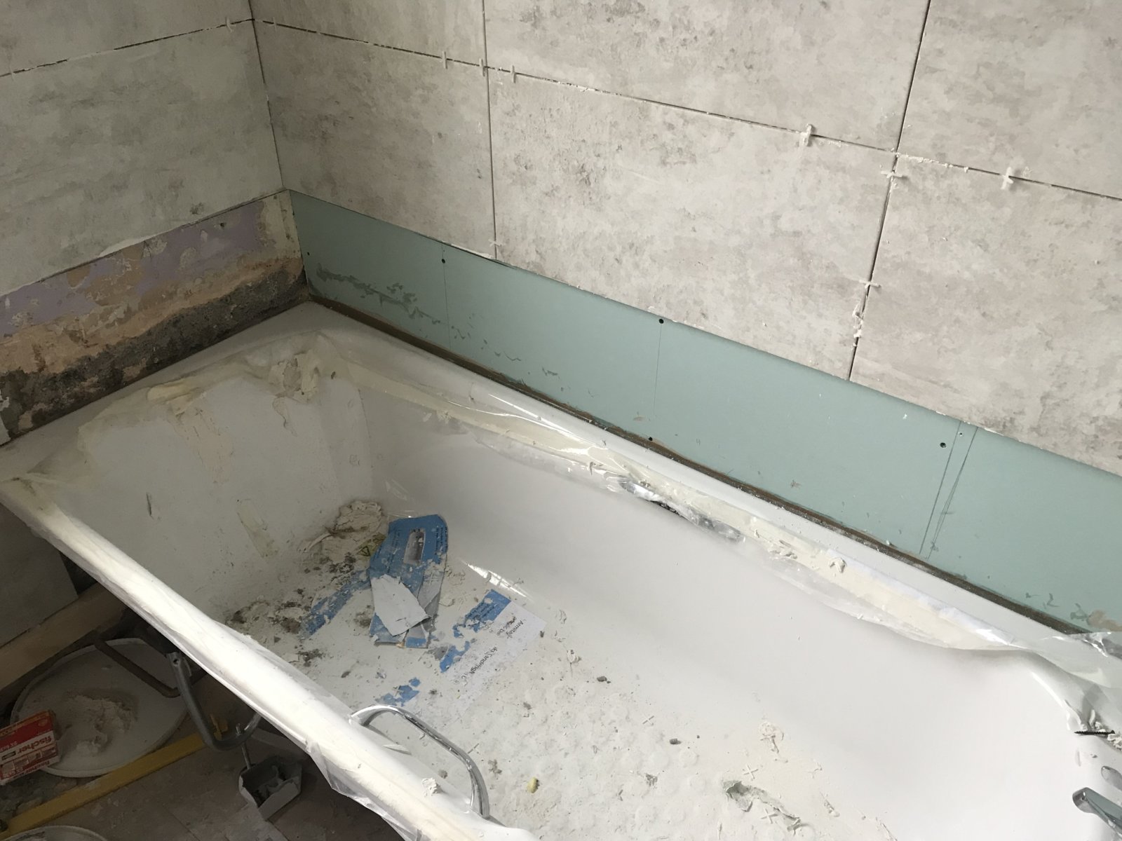

I set my datum line and gave consideration to the points mentioned above. I am tempted to attack this a wall at a time. I'm hoping that a pro can yay or nay this...
The actual planning side of tiling is simple find your centre points vertically and horizontally you can then draw out your tiles if you really thought you would come across problems of small tiles needed near edges and so on. To which you could push your starting point (centre pont) forward or backwards to whichever direction by enough margin so that you're happy.

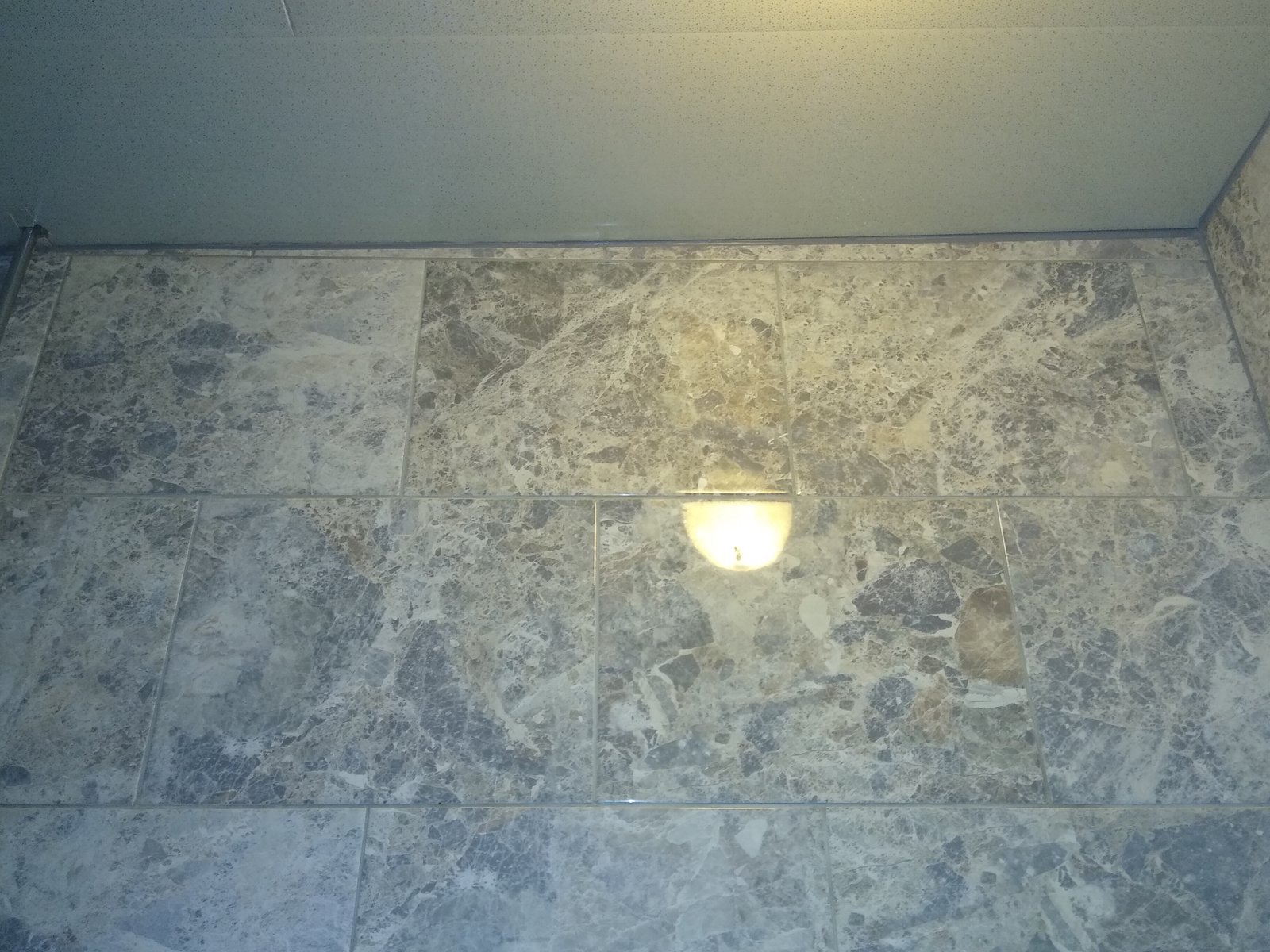

I wouldn't be so worried about the top of a wall as here is what mine ended up looking like, when I started my first big tiling project, which was my bathroom. I had full tiles above the bath to begin with and ended up with short tiles I had to file to a fine mm at the end. I'm not a tiler either.
I’ve made some progress since then. Current pics
Coving works wonder in these cases if the little strip bothers you.
