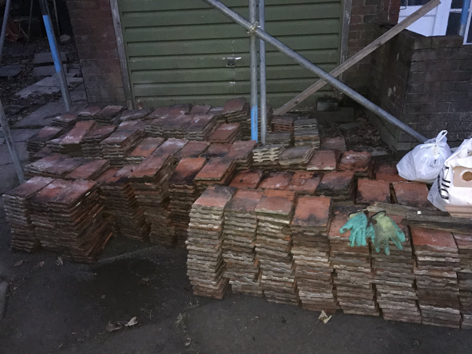

My battening is coming along. Gonna be nipping out to some reclaim yards this week. Looking for “dirty red” clay plain tiles, arris hips, valleys and ridges. Not to worried about getting a good match for the plain tiles, but getting the eaves tiles and tile and a half’s along with the ridges, hips and valleys all matching might be tricky.

What do these dirty red ones look like?
Anything like those?
Those tiles should be in the skip. They are delaminating badly and serve no further purpose as roof tiles. I did note the proliferation of shale remnants, in the images you posted earlier.

Not all bad, second row from back third stack in, seventeenth tile down looks good
99p no reserve, they are all the ones that came off in one piece, some good, some not so good.
