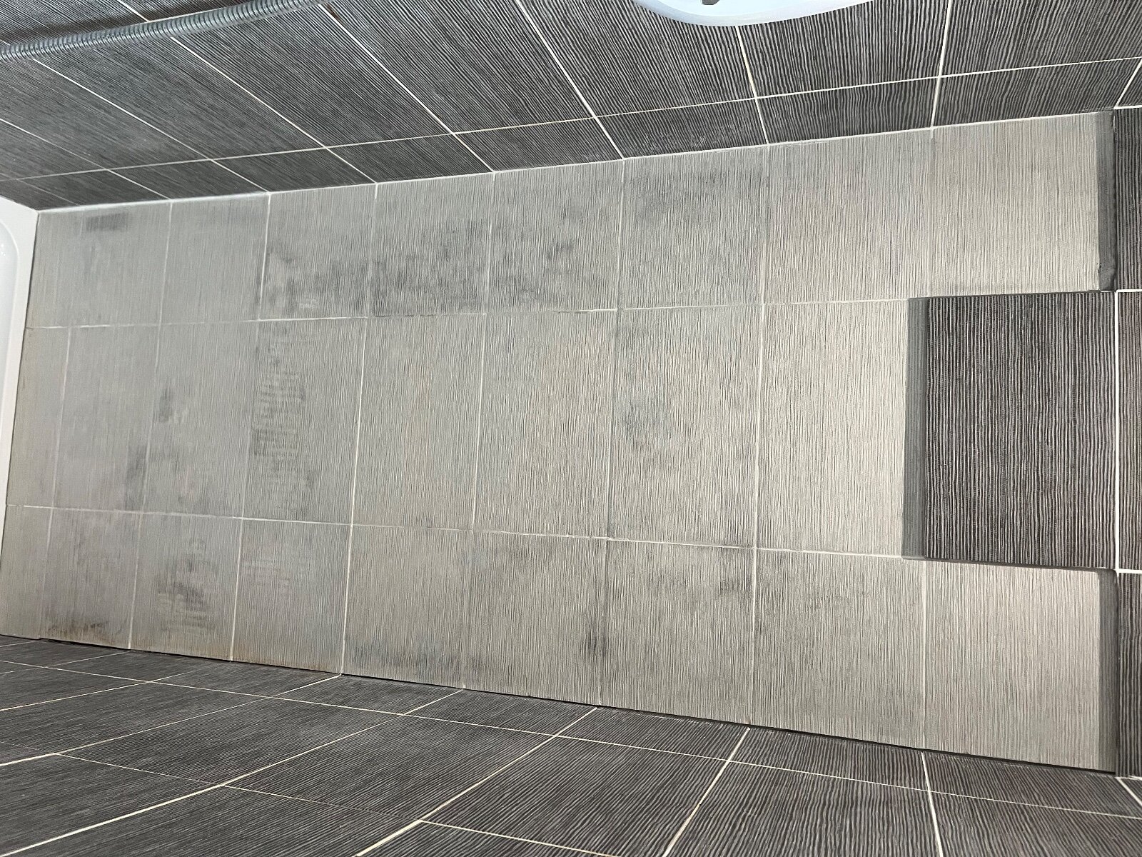

Hi All
So I’ve gotta re tile this shower in my bathroom starting from what what’s left on the wall and continuing down the bottom.
I’m not sure where to start really. Do I do all the middle tiles 1st or the edges? Any hints and tips to make it easier as I’ve never done tiling in my life.. how do I work out what size tile spacers I need?
Tom
Are you over tiling with the dark grey ones? Do the middle ones first and then cut the sides to fit.
Spacers - match the existing, looks like 2mm. Looks like there is still one in the joint of that last tile, dig it out and buy some the same
Hi
Yeah over tiling the white ones with the darker ones. Can I do the middle then let it dry and then do the sides? Guess I just clean the tile adhesive away from the edges of the middle ones ready for the sides when I do them?
