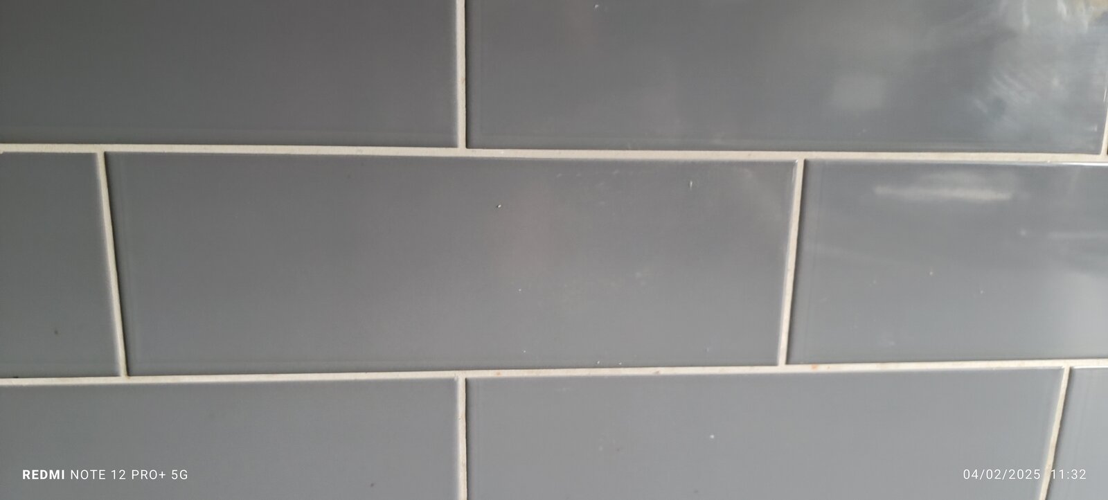

I need to tile under the wall units as they have been replaced with shorter units ( had extra long wall units previously)
The wall is clean and is part of an extension we had 5 years ago so it's plasterboard.
I need to do 16 tiles on each side of the wall , can I use tile and adhesive all in one ready mixed or am I better getting powder stuff and mixing it ?
Tiles are roughly 4 inches wide and 9 inches long.
Also any ideas on how much adhesive and grout I will need....any other tips be helpful.

If your wall is good, clean and flat then in your shoes I’d use a tub of premixed Greenstar or similar. No point in buying a whole bag of powder tiling adhesive.
You won’t even use half a tub.
Remember to source the same size of spacers as used on the rest of the walls.
