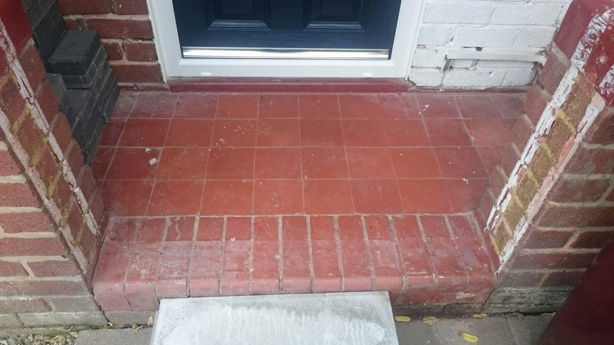

Hi I've had a go at tiling before but need advice from professionals etc.
I am gonna tile over the existing tiles in my porch area but at the edge of the step is a curved brick. Do I tile upto the curve and square it off or leave it ? Thanks
I have something comparable. I thought the tiles would have to come off (SDS+, rotostop, chisel, I was thinking)
