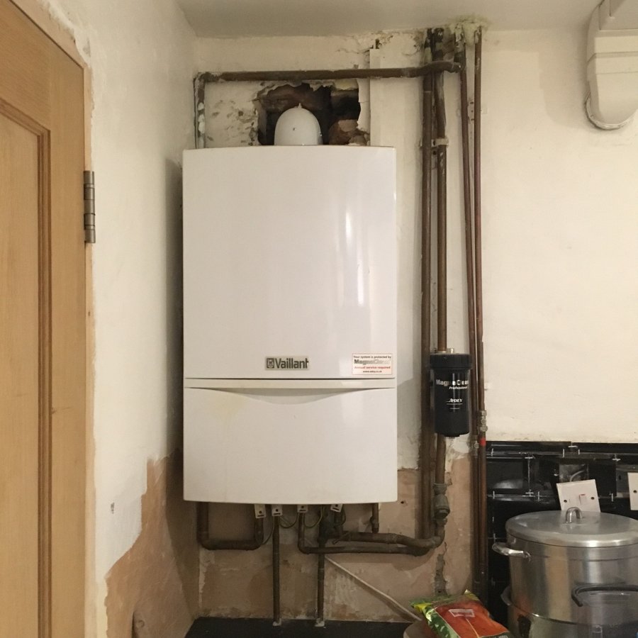

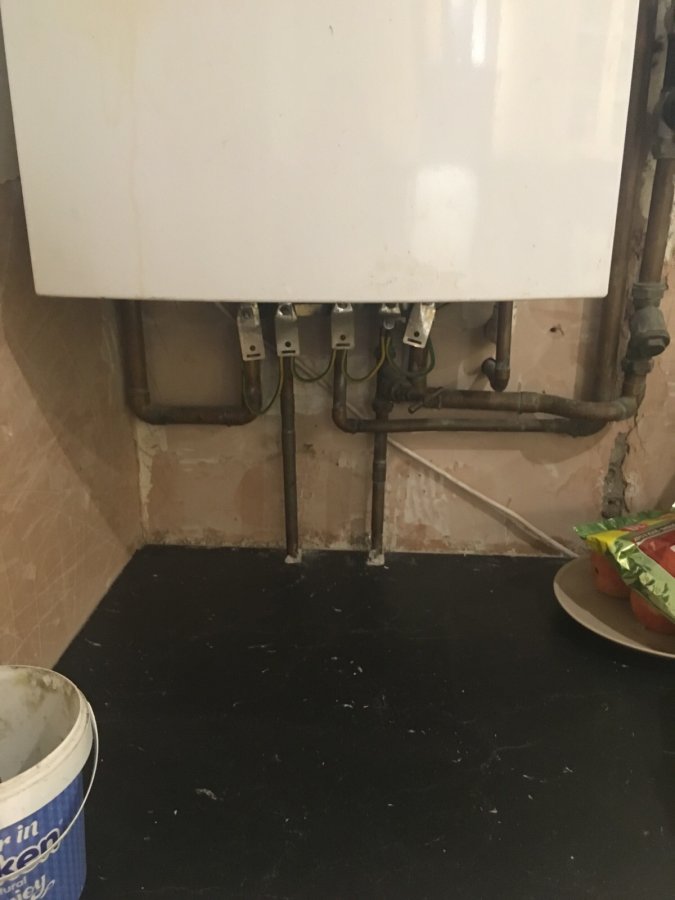

I am currently tiling the kitchen splashbacks and have done all the worktops except under the boiler. There seems to be a stop cock of some sort connecting the boiler to the pipes and some other bits I feel will need accessing so I wish to create a create a door type opening, but to blend in with the rest I thought I would tile the front to match the rest of the worktops. See Pic below
I was thinking of creating a frame using 1x1 batons and a piece of 6/12mm hardibacker board screwed onto the batons (I have some offcuts lying about) for good solid adhesion
I was thinking of using standard door hinges but my worry is that the weight of the tiles, adhesive & grout will be too much for the hinges or that section and will cause the 'door / opening' to sag and drag on the worktop as the depth from the board to the back of the tiles won't be deep enough to get the screws in to have a solid grip and I don't think stuff like no nails / sticks like will be useful either (but I could be wrong)
Part two of what I propose isn't as tricky but what I also wish to do is box in the pipes going to the upstairs toilet but I've got a Magnaflow connected and also I don't wish to conceal the stop valves which are connected to the pipes, I have circled this as the pic quality isn't that good.
The green highligting is what I'll be boxing in with more 1x1 batons and then standard plasterboard screwed on top
My concern here is how to have an opening or leave a gap for a screwdriver to get through to the valves should we need to turn the water off for any reason, I also wish to have the magnaflow filter protruding out as I dont want the boxing to be so deep
Bottom half highlighted red is the area I wish to create the tiled door opening
