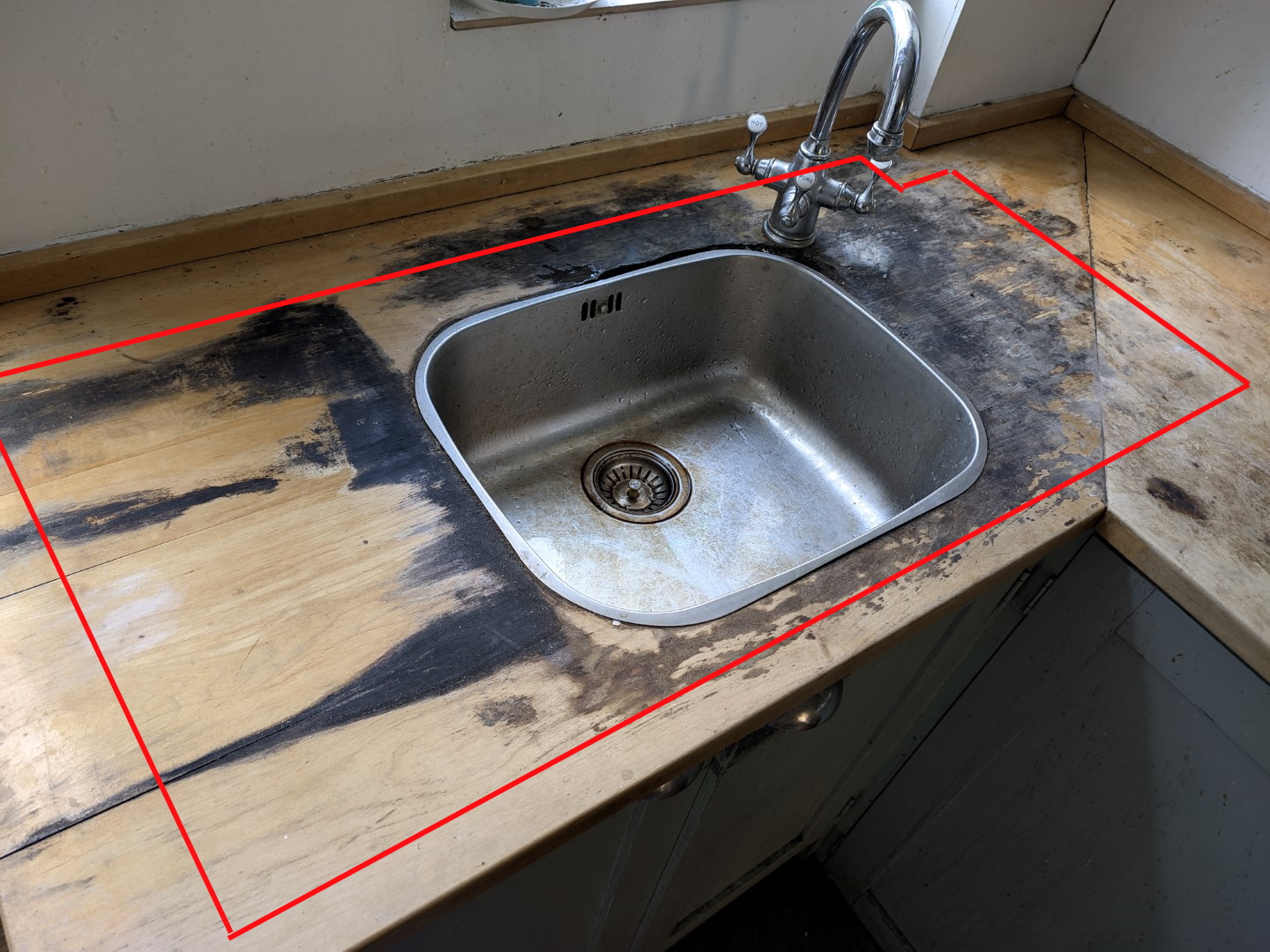

Probably easier if I post a picture - this is what I'm dealing with. Really, just trying to do something that will make it a bit more tolerable for a year or two while I save for a new kitchen. The plan was to rout an apperture about 8mm deep in the red shape, and drop an appropriately cut tile (or something) in there, with suitable sealing and adhesive. I was attracted to tile because you can get really nice looking ones for £25 and this is not meant to be an expensive job. Some of the suggestions have been lovely but would cost way more than it's worth.

Is the wood really rotten? Sure, some towards the back of the sink looks like it is pretty rough. Could you not just remove any rotten timber and use epoxy resins such as Oxera
I am not a kitchen fitter, but your sink looks like it should have been under, rather than surface mount.
