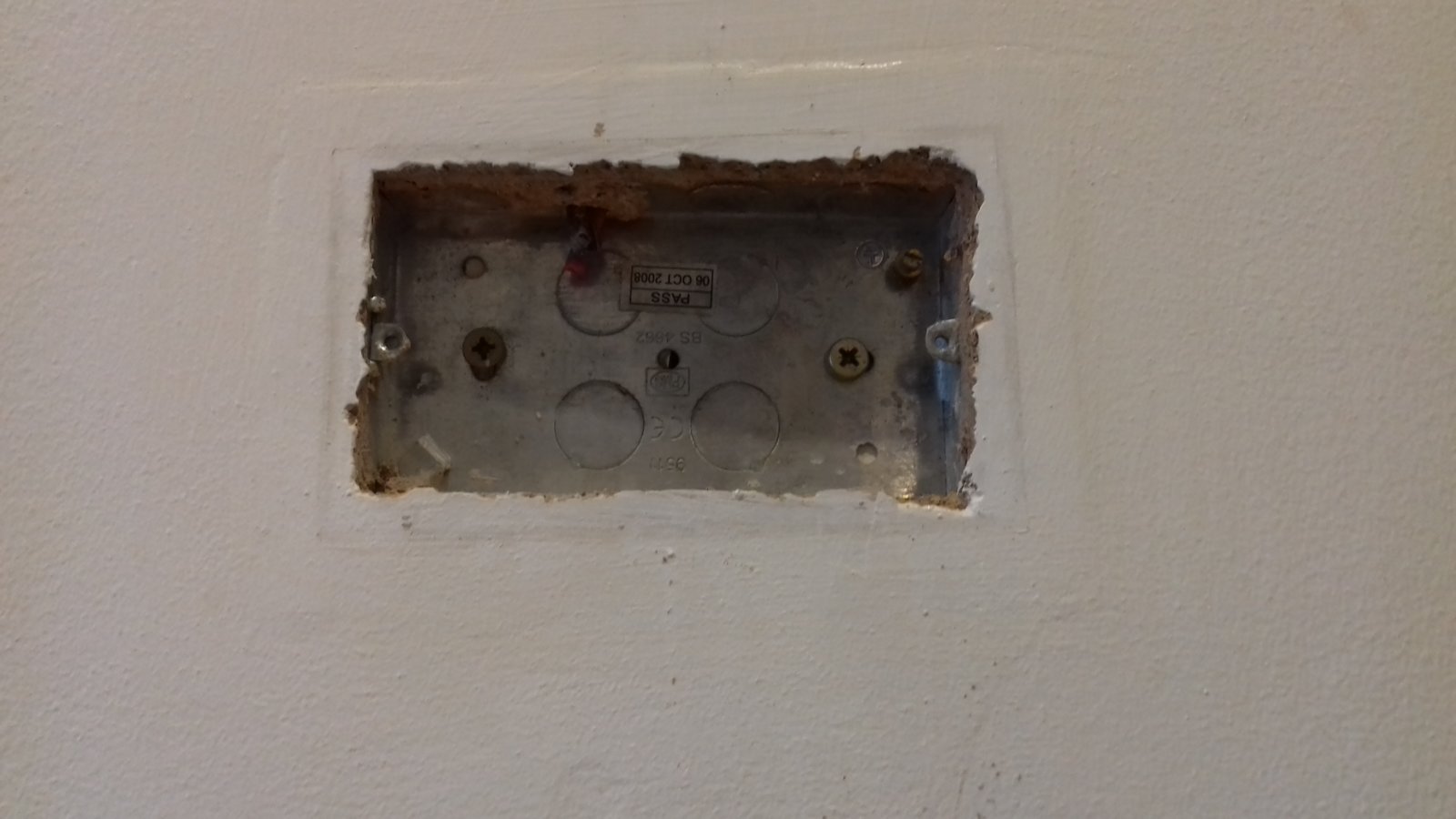

I'm about to start putting up a tile splashback in my kitchen, and I've got a question. The fitters who put my units in installed some new electrical outlets and took out an old one; they left the back box in the wall and (as I requested, for reasons of money) didn't fix all the plaster, because in general that's the sort of thing I can fix pretty well myself. Can I take the back box out, patch the drywall there, and tile over? I'm wary about electrics and, as you can see from the photo, there are the ends of some wires at the top. Even though it's out of commission now, do I need to leave access for it? A little access panel would be kind of unsightly in the kitchen, so I'd prefer to cover it over if at all possible.

The wires have no doubt been snipped rather than pull them out completely and disturb the plaster above. You can't be certain it's 100% dead without testing it for voltage though. If it's no longer live undo the screws and ease it out and back fill.

You need a two pole "voltage" detector - a simple multimeter will do - and measure from the wires to a known earth.
However, that does not mean the wires will not become live if something is switched on.
Do you know where the other ends are?

The wires go up the wall into the upstairs bedroom; I had the floor up there last week (renovating the whole house) and they join the mess of cables there, all going to the kitchen downlights or upstairs sockets. Given that fact, I guess it means they won't come live again -- since there's nothing that will be drawing current through them? (Unless I'm misunderstanding).

Hmm. CURRENT can only flow if there is a load attached. And there will not be any load!
What you should be testing for is VOLTAGE. You can do that with a multimeter, if you know how to drive it (hint, use the AC VOLTAGE range, not the AC CURRENT range!)
They will if they are still connected.
Yes, you are misunderstanding
If the cable is still connected it's like a water pipe with a closed tap on the end.
If it is still connected to the supply, the pressure - voltage - is still there just waiting.
If you touch the live wire in your box, you will open the tap and current - current - will flow; with electricity it will be through you.
You really need to find it upstairs and make sure it is disconnected.
