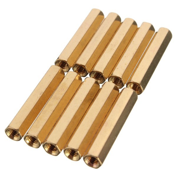

Just to complete the tale, it turns out that the back of the mounting box goes straight through to the brickwork, at precisely the point where I'd like to make a screw hole into the box. This is because this part of the box is the part that was bent around to make the original screw hole (that I managed to shear off). So, I'm going to drill into the brickwork and Araldite an extension stud into the wall (https://www.tlc-direct.co.uk/Products/MK3710.html). I can stack these up if one isn't long enough to do the job on its own, but it ought to be easy enough (famous last words :)).
I take it is isn't a plasterdepth (16mm) box?
Not sure what a 'plasterdepth' box is, unless it's one of those boxes which lock themselves behind a plasterboard wall (e.g. https://www.tlc-direct.co.uk/Products/MTMDLB1.html)? In any case, it's a regular metal box, that is screwed into the brickwork. It looks like breeze block at the back - maybe not the strongest of materials, but probably good enough to take a retaining screw for the switch - if I go deep enough and use enough Araldite.
You could have glued something like this to the back I.e a big blob of gripfill it would never move then,, Ah well you have done it now so too late
