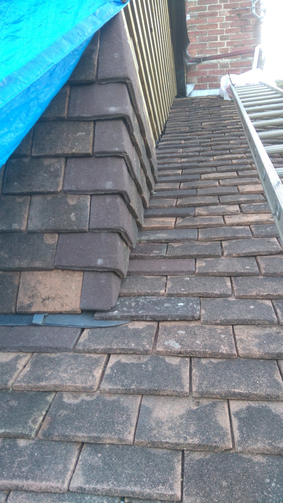

Hi,
I'm wondering how I fit a tilting batten or something similar that will kick out the eaves/lowest tile on every row of a dormer cheek going up the pitched roof.
If I simply screw a 50mm batten below the horizontal at the same pitch of roof then won't it obstruct the tile further up.
Is there a way of doing something that keeps the eaves/lowest course ,at the abutment to the pitched roof, from hanging loose?
no not necessary but you would run a single batten the same thickness as the tile battens up the pitch and then run your tile hanging battens into that
Yes thanks. I had done that already as that seemed a good way of supporting the batten ends.
Have rested the lowest course on pitched roof tiles a little to keep them out.
Cheers
Yesterdays work. Took a while to start but should keep me busy thiscweekend until i get to the next obstacle of tje chimney. No scaffolding here either....

If that's all your own work first time roofing, that's pretty tidy, it will get a bit more hairy when your stood on the ladder to if there's nothing below you.
Be safe, get the scaffolder back to shoot the poles out a bit if your unsure.
I always ask for a 3 or 4 ft over hang so you can get a ladder up the cheeks safely

Yes I could ask for that. I've done everything of that ladder so far... :-/
Thanks! Yes it is first time building all of it. Taking me longer than I thought. Most of the "help" I've had have has been poor quality and has caused me more work rectifying... I've gained a few grey hairs and got aches in muscles I didn't have before. :-)
