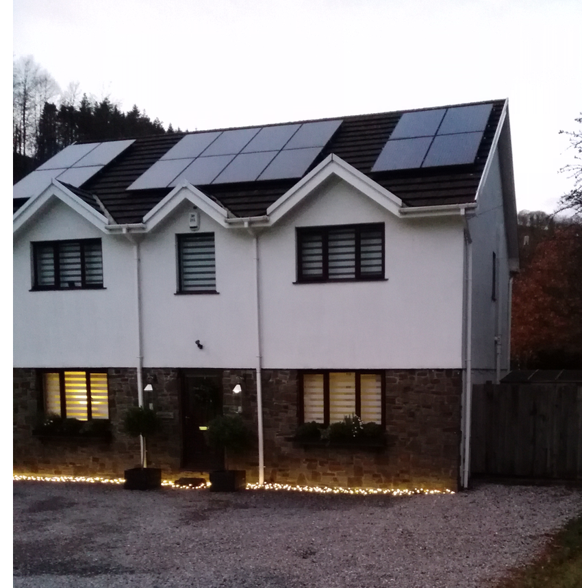

I will have moved into my TF house 25 years ago on 5th December after a 17 week build from first trench dug. I had a 6" frame as an extra, for the insulation. Probably the minimum now, I guess. I've had leaks, one or two good uns, with no adverse effect on the frame. To counter wessex, I'd never build a block house- timber far better for the environment. I will concede his point about cladding- wish I had been a bit more adventurous in design and outside finish. As for cranes, my blokes (2 of them, one 65) lifted every panel and truss into place by hand- shock horror these days, I suppose.
Cost (1995) Land, 1/3 acre brownfield, £26k, Build 1650 sq ft, £54k. I only add that to make you feel ill:D

Ha ha, no, I'm in Wales, and going nowhere soon. Leaks. No I haven't followed them up with inspections and so on. But there has been no deformation of the structure, and the timber condition is as it was back then. Cladding and design... I designed mine on school graph paper with sketch of a traditional pitched roof house. It was all about the money, and that seemed the safest way to go. I/we wish we had gone for a more contemporary design/ more glass/open plan/better orientation for views over the river and forestry we have alongside. Cladding need not have been stone and block/render. That said, I'm 64 now, so upkeep of timber cladding would be becoming an issue in my mind now, had we gone that way.
