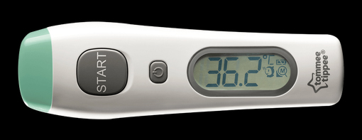

Yes it did take a long time with mother's house, but I don't have a differential thermometer. I am told it should be set so there is a temperature drop of around 15°C between supply and return with boiler running, I tried to use a thermometer thermometer.jpg it was a failure, theory great, set to baby bottle setting and point and read, but reading not steady enough. So the method used was to turn off lock shield valve and turn it back on ¼ turn at a time until just felt supply pipe start to get warm, this was an improvement, however the TRV TRV.jpg has numbers on it which seem to have no relation to degrees C, and taking one out of my draw and testing where I can actually see if open or closed, I found at a setting there was around 3°C between fully open and fully closed, so to keep a room at 20°C it was some where between 2 and 3, so I have three or more controls, if boiler on/off, what temperature boiler set to, pump speed, lock shield valve, and TRV if only one needs adjusting great, but two or more, not easy.

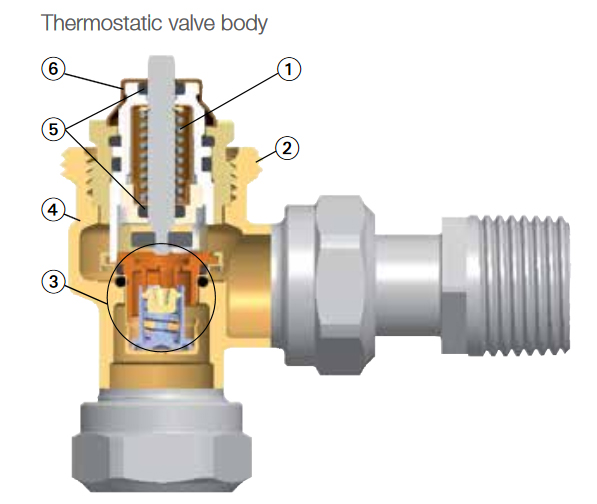

It seems Combined-TRV-Lockshield.jpg this is a combined lock shield and TRV, never used one, maybe it does help?

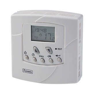

But the wall thermostat does not help, 84067_P.jpg looks simple, not programmable, however it has a number of features, some good, for example it looks for a signal once every ½ hour so if the battery goes flat it fails safe, but also it has anti-hysteresis software, what this does is start switching the boiler off/on before it reaches set temperature, and it adjusts the off time, so it will not over shoot, however with a modulating gas boiler this defeats the built in software and causes the boiler to stop modulating, so may be great with the oil boiler I have today, but useless with a gas boiler. It means energy wasted out of flue every time it turns off, and turns on flat out rather than modulated.

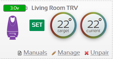

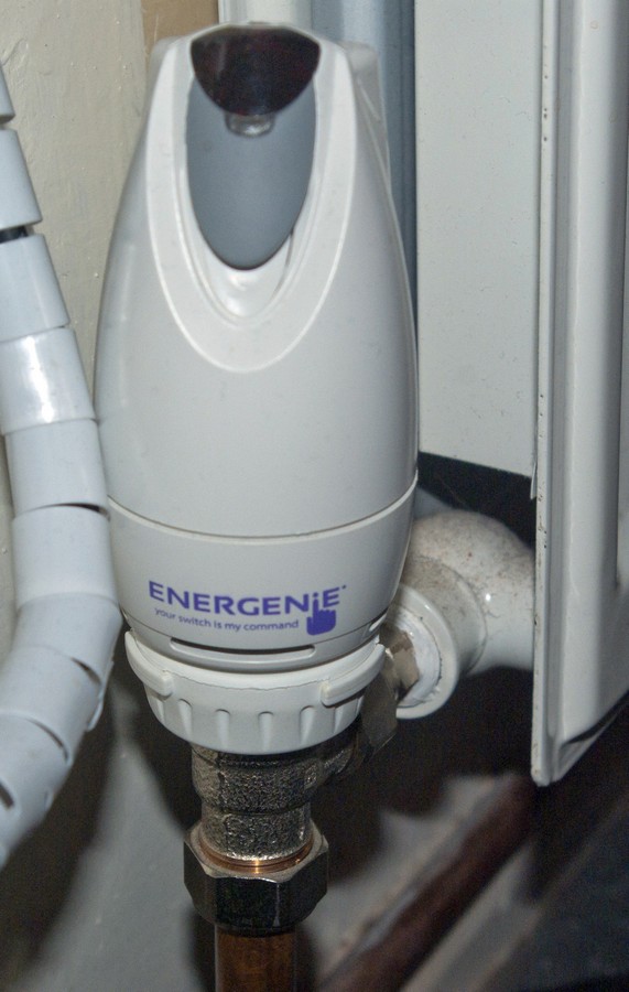

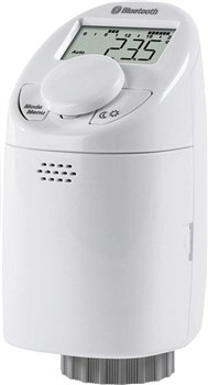

This IMGP8035.jpg TRV head produces this TRV_report.jpg computer read out, so you can adjust the lock shield so target and current match, however the anti-hysteresis software is too good, and it takes over two hours to settle at a temperature, and there is no manual override. The EQ-3 Bluetooth Smart Radiator Thermostat.jpg does have a manual override, but only shows target temperature not current.
