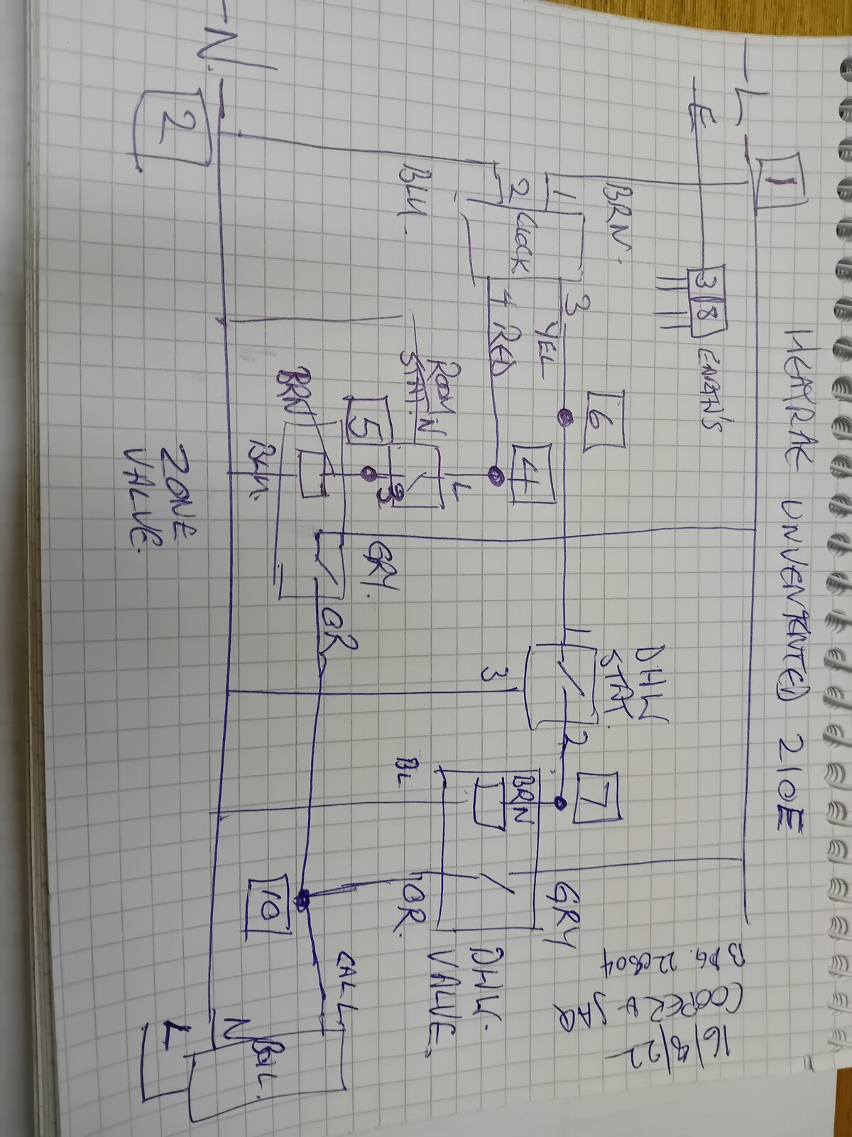

Excuse my notes from 2022 for a system with a couple of 2 port valves, I can interpret if required:
Hopefully this is correct
Earths not shown

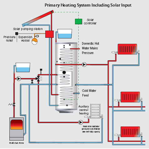

This is the bit which is making me think you have some thing out of the ordinary. My house is also out of the ordinary with CH and DHW due to having a garage made into a granny flat, so this is only heated when we have visitors, so central heating both uses motorised valves, pumps, and programmable TRV heads. Normal is one or the other, not both as they in essence do the same thing.
I thought to start with only talking about DHW, but having it independently controlled for three floors does not seem normal. I know some CH systems do that, but unless like me with what is really a separate dwelling but using same CH boiler, it seems wrong to split into floors, as at the moment I am still using top floor, which has two bedrooms, an office and craft room. Down stairs we have living room, dinning room, and kitchen. So both floors used during the day, therefore using programmable TRV heads is far better as we can select room by room what is heated.
I can select DHW to be heater in summer by oil but with solar panels I use electric, but if I did not have solar panels I had to use time as no tank thermostat, but if I had one, the DHW would not be turned off except for holidays. 40 gallons takes a long time to cool so no point, only other reason for timer is to use off peak power.
Anyway enough of my house, what we need to know about is yours. I fail to understand with a modern well insulated tank why you want a timer? Something missing in telling us what you want it seems.

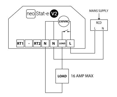

Thanks, so I do seem to have a permanent live and neutral coming from downstairs, the neutral is just connected straight to the tank, the live has a simple mechanical switch in between.
So when I connect the neostat hw or even a cheap timer, I have the live from downstairs coming in, neutral connected to the existing neutral from downstairs/one that goes to the tank. Then a link from live to common, and the live that goes to the tank on NO, that seems to be the switch that just goes bonkers when the stat hits temp and calls for heat/completes the circuit.
Could I grab the live off another permanent circuit, I have a Heatmiser UH8 beside this, so could nab a live and neutral from there for the neostat power, then connect in the live from downstairs to the common, then my stat to NO?

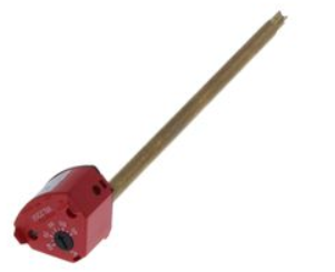

The traditional thermostat comes in different lengths, 1708173541103.png and I have a short one, which goes into the top of the hot water tank, I need a longer immersion and thermostat so it heats up more of the water, I think your tank it fits in the side, and my google showed a tank with multi pockets, it is possible to arrange one thermostat to turn on, and another to switch off, same idea as float controls, and likely a float relay would do the job. However again it is the safety aspect I am not sure about.
Only if that is connected to the same circuit as the hot water system.
Ultimately you are trying to connect the timer in the wrong place, it should be connected to the wiring centre with all of the other devices.

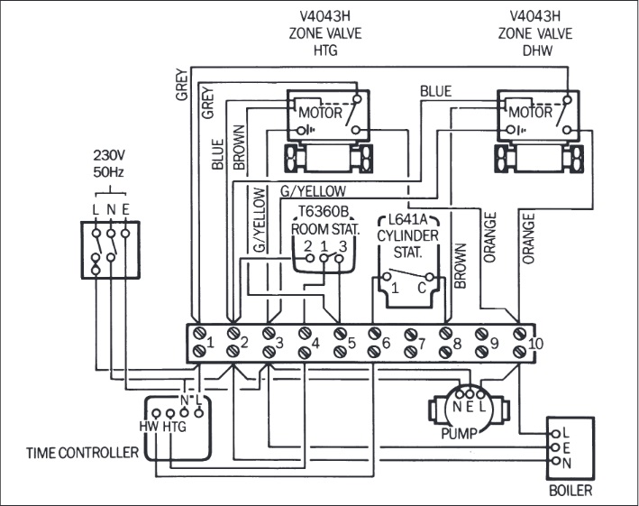

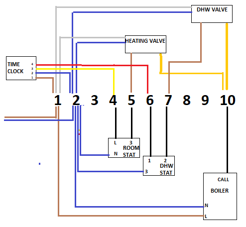

I supplied a copy of my notes and created a pictorial which is virtually identical to that from Eric but that goes nowhere near multiple Heatmisers, UH8's and switches going bonkers.
