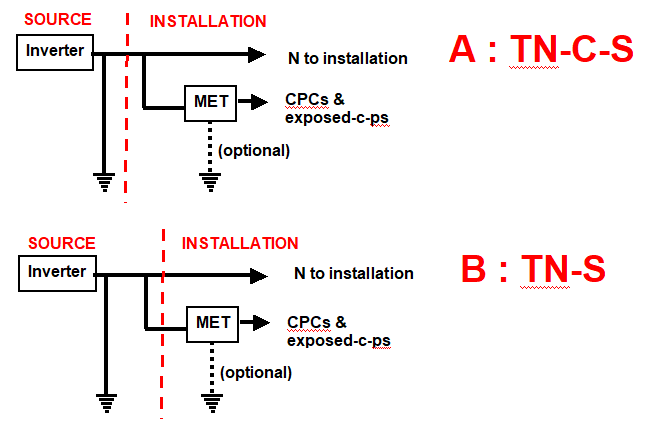

However, as I've been saying to eric, if he has a TN-C-S installation which suffers a 'CNE failure', there will then be no cable connecting the installation's CPCs (hence exposed-c-ps) to the transformer - so the only path (if any) back to the transformer from L-CPC faults in the installation will be 'through the soil', via a local earth electrode and/or extraneous-c-ps (if any) - and I can't understand why eric thinks that means that his installation would have 'become TN-S'. Usually similar language, I would say that it had 'become TT'.
What am I missing or misunderstanding?
Where's the fault Eric is postulating?
I'm assuming upstream of his inverter. And his inverter is upstream of the N-E link in his installation. So if a fault upstream of the inverter causes its N to connect to its local earth rod, the installation N-E link is still there, and his installation earth is still derived from it.
All that's happened is that the supply source is now his inverter instead of the substation transformer, so isn't he actually still on a TN-C-S supply?
Yes, I think I've seen some of the light :-). I was thinking/writing about 'TN' installations from the viewpoint of the DNO supply - and, as I wrote, there could not possibly be a ('DNO supply') TN earth if the sheath of a TN-S supply or the CNE of a TN-C-S supply had 'failed'. However, as you remind me, I should have been thinking about things with the inverter, not the DNO supply, as being the 'source'.
There is potential for confusion with the terminology, since 'streams' can go in different directions, but I take it that your 'upstream' means upstream of the inverter when the inverter is the source.

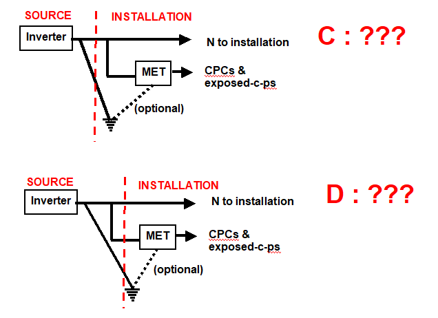

Having given more thought to it, I think the situation becomes rather arbitrary (and 'trivial') when the 'source' and 'installation' are in essentially the same location and have only one connection between them to true earth - since, as far as I can see, whether the (inverter) supply is TN-C-S or TN-S depends upon the (essentially arbitrary) decision as to the position of the dividing line (dashed red line in my diagrams) between 'source' and 'installation' - see my diagrams A and B.
However, if the (one) point of connection to earth is on the installation side of the 'dividing line' (my diagrams C & D), I'm less sure what one should call that - but nor do I think that it makes a blind bit of difference what one decides to call it ;)
C and D are both variations of TN.

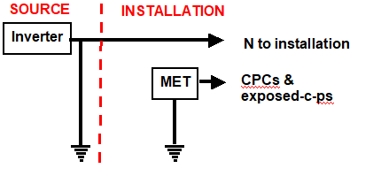

If someone really wanted an inverter or generator installation to be TT it would look like this
but no real installation will be like that.
Inverter / generator installs are almost always TN-S, with the N-E link internal to the generator or immediately after the output terminals, the earth electrode also being connected at that same point.
Indeed they are but (for what it's worth!) would you call them TN-S or TN-C-S ?
If someone really wanted an inverter or generator installation to be TT it would look like this .... but no real installation will be like that.
Agreed - but, as you imply, there would be no point (yet some reasons for not doing that).
Yes, that's more-or-less what I concluded - although, as I illustrated, I think there are some situations in which one could describe it as TN-C-S (although that would make no difference).
