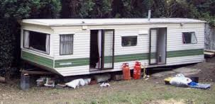

Yes, This does show how to export to an outbuilding but Autumn 2005 is going back a bit, now we regard a building similar to a caravan the same as a caravan. So a wooden shed could have a TN-C-S supply, but not a metal shed.

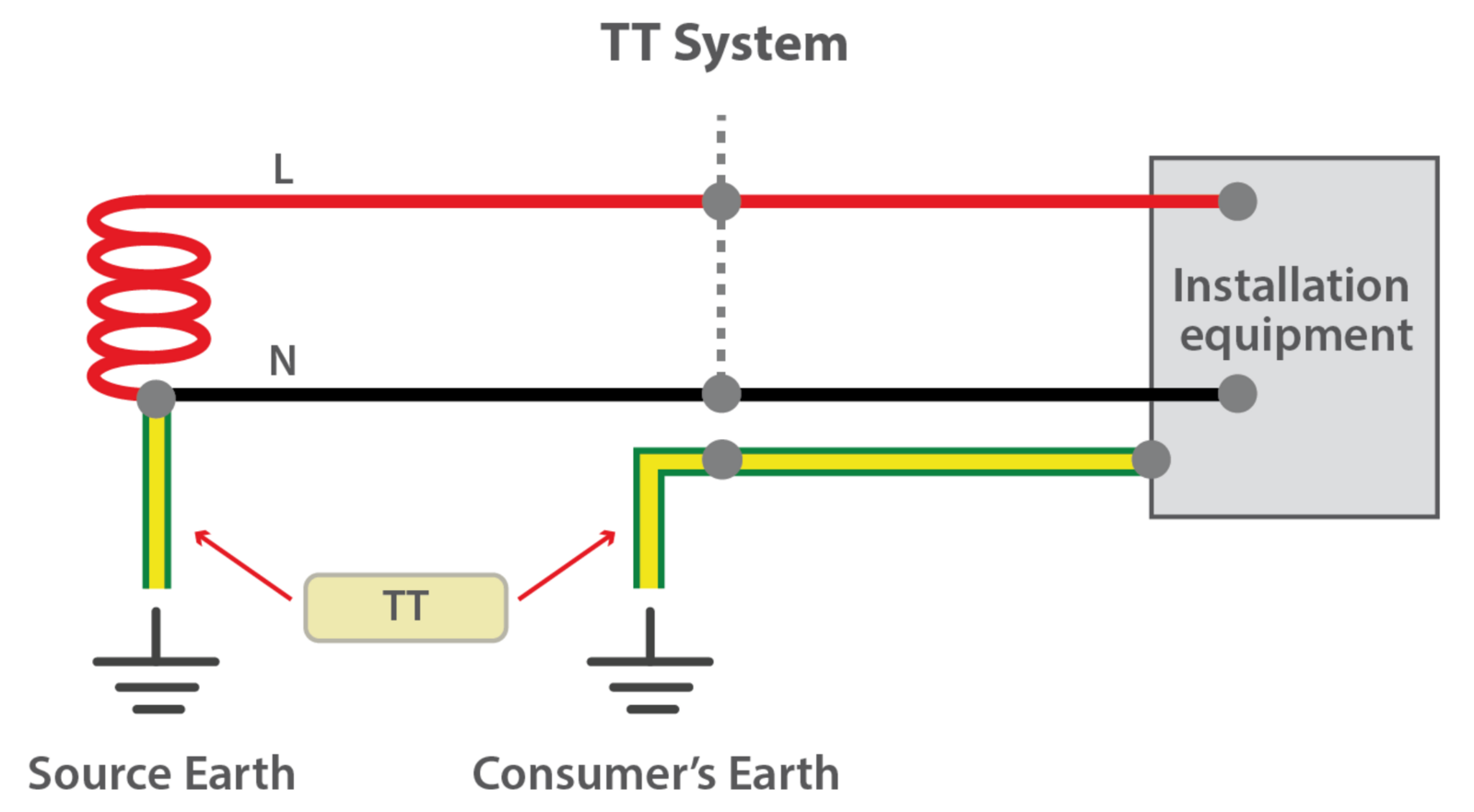

The system does have an earth electrode, which is always connected. But the connection neutral to earth is within the system, not at some point on a pole with no earth from the pole to local system, and does not cause the fault current to run through the ground, so it is therefore a TN-S system, not TT.

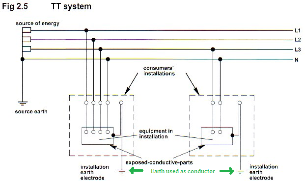

It almost sounds as if you are saying that any TT installation is actually TN-S, because the N and E are 'separate'!

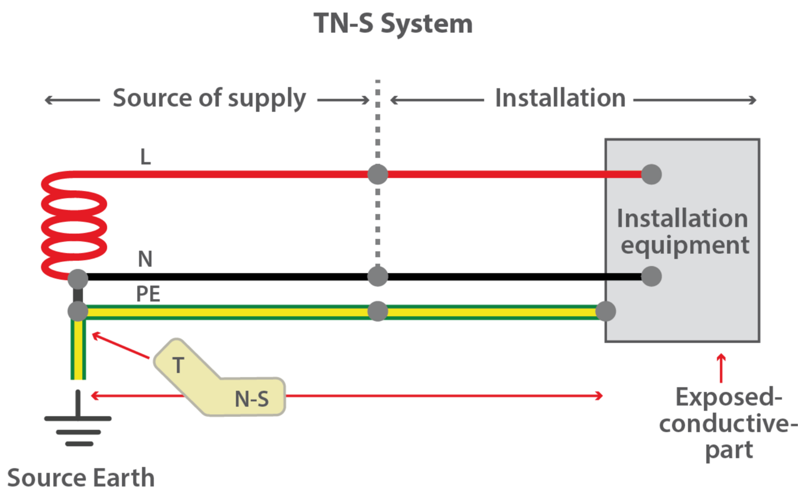

The loop, in through the line wire, which goes to an overload device, and to the device being used, which has an earth fault, so goes to the earth wire back to the supply transformer, and trips the overload, where does the ground come into that loop.
Or
The loop, in through the line wire, which goes to an overload device, and to the device being used, which has an earth fault, so goes to the earth wire back to the earth, through the earth back to supply transformer, and trips the overload, clearly the earth is used in this case.
What "earth wire back to the supply transformer"? As I said, if there is a 'CNE failure' there is no route back to the transformer other than (if there is a TT electrode, or other connection to earth) 'through the ground'. I can'gt see how that could be called 'TN'.

What 'earth' would the inverter "auto-connect neutral to"? If the 'failure' were a 'PEN failure', then there would be no DNO-supplied earth to connect to, so the only alternative would be a local earth electrode, in which case it would become TT, not TN-S.
Wouldn't TN-S vs TT depend on whether there is a cable from where the N connects to a local earth rod to the installation, or whether the installation has an earth electrode separate from the one N is connected to?
