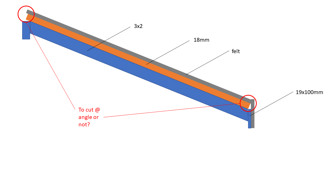

I'm after a bit of hopefully advise or thoughts as to how best to finish the roof of my shed.
Thanks to comments, I'm pretty much at the stage of getting the sheet ply on, but have a question as to how to cut.
I'm hoping the below image might make it easier to explain:
1. Now on the one hand, I could simply run my plunge saw down the sheet ply at 90 degrees (per the picture).
2. However, I'm also wondering whether I should set the saw to 22.5 degrees on both sides to make the edges of the ply flush at both ends.
I'm assuming that (2) would be preferable, but I've had mixed experiences with accurate cuts when using the plunge saw at angles.
I have a 1.4m rail, so I'm not able to clamp the rail at both ends for the 2.44mm length required. If there is any advice as to how best to go about this (or there's another way in which you'd suggest), I'm all ears!!
As always, thanks very much in advance - we're definitely getting closer to the finish line here!!

I would just keep it square.
But on a small shed like that I'd just fit the end trusses and span with purloins.
Then sheet with a corrugated cladding system.
The purloins can rest on top of the trusse or can be inset.
No need to cut flush, just so it doesn't overhang so the felt can wrap around the sawn end of the rafters.
