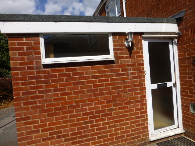

The room in question
We have a porch/utility/outhouse attached to the front of the house (see pic below).. It has a built-up felt flat roof, single-skin +/-95mm thick (half brick?) walls on three sides, a concrete/screed floor, and is not heated by the main house CH system.
The three single-skin walls do have an integral DPC (visible in the first photo, level with the base of the door cill).
There are two doors.. one is the front door (seen in the pic) and the other is inside and leads from the 'outhouse' inside to the dowstairs hallway. The house is an early 70s terrace.

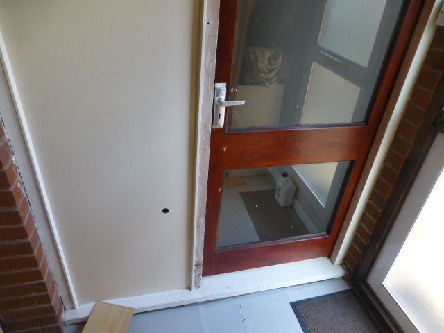

Current make-up inside
The roof is a 'cold roof' so has a plasterboard ceiling with loft-style insulation half-filling the (ventilated) cavity between the rafters/joists beneath the boards.
The walls are currently lined with dot-n-dab fixed plasterboard (probably done in the late 80s-early 90s).

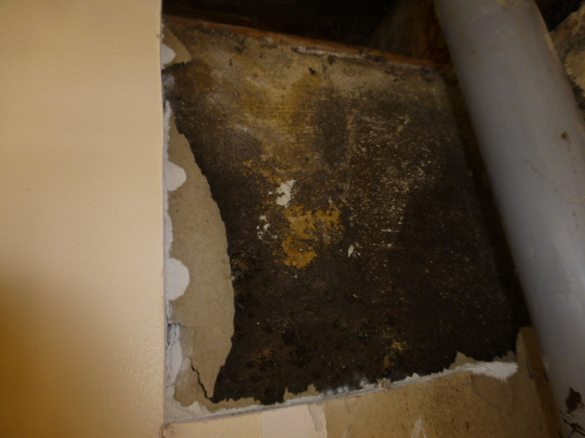

The flat roof is old and has leaked in the last couple of months.. (I've made a temp/patch repair in the meantime). The old-style coated chipboard boards are showing signs of failure..
The plasterboard ceiling is failing in places and the boards starting to droop..

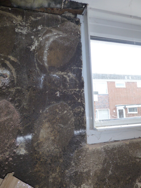

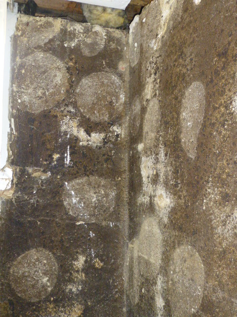

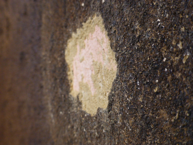

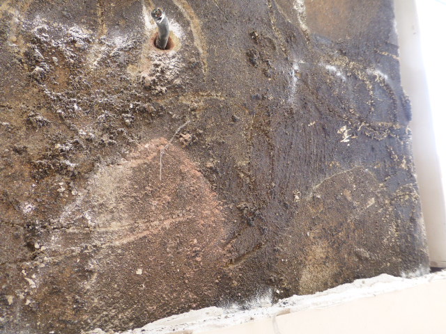

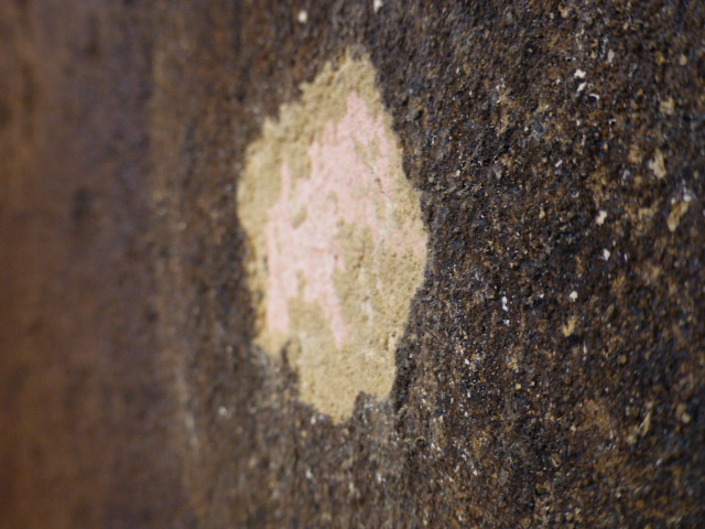

Having removed some of the existing plasterboard from the walls, I can see the walls have been painted with what looks like a liquid DPM in the past (see pics).
Regarding this coating, should I..
a) try to remove it in order to leave a 'permeable' wall?;
b) leave it as it is?;
c) add something similar (like BlackJack liquid DPM) over the top..?
The application guidance from Celotex for the internal insulation of solid walls seems to suggest that the wall should be permeable and stripped/clear of coatings. I am reading elsewhere that either a liquid DPM or a plastic sheet/tanking should be in-place..?
Is the guidance from Celotex based on the assumption that the solid wall is a double-brick-width thickness and not prone to ingress from the outside..?
Many thanks in advance of any thoughts/input you can offer..

Having removed some of the existing plasterboard from the walls, I can see the walls have been coated with a sand/cement render and painted with what looks like a liquid DPM in the past (see pics)

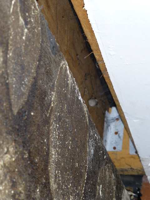

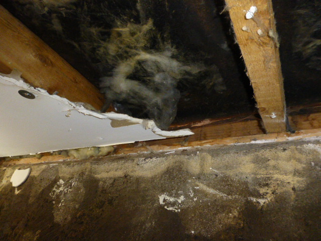

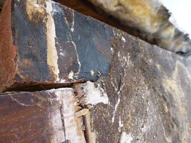

There's a part of the ceiling I had to cut open when I had the leak.. pics of the rafters/joists as follows.. I wanted to leave the rest of the ceiling/insulation in-place until the roof is sorted. You'll also see an internal downpipe from the flat roof above.. (There was low natural light so the flash made the walls look lighter than they are in some of the pics..)

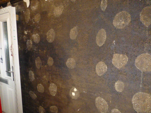

I have stripped all the p/b off. The render and 'liquid dpm' coating is applied across all three walls. The coating is about 1-2mm thick.
The walls feel and appear sound/dry. Never any cases of damp in the past.

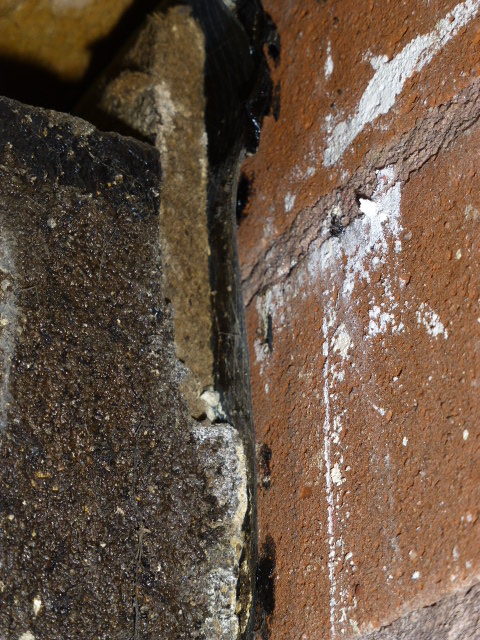

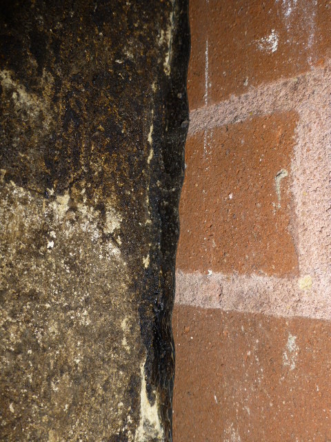

The wall that abuts the house's outer leaf (of the front cavity wall) has a strip of DPC from top to bottom as seen in these pics :
Never any previous issues with damp in this area of the main house.

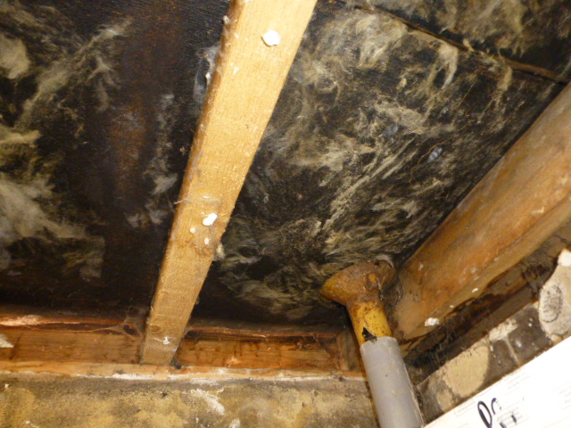

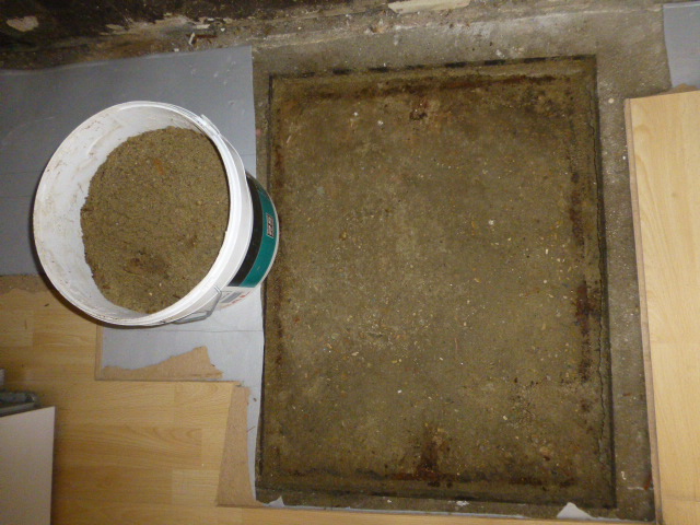

Floor
The laminate flooring and poly-foam/styrene underlay went down about 7 years ago.. there was previously a carpet/rug in there (no underlay).
I've lifted parts of the flooring and underlay.

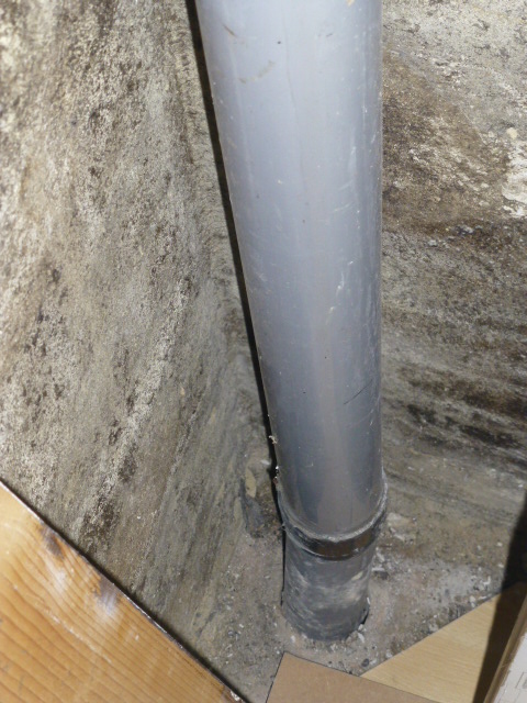

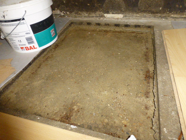

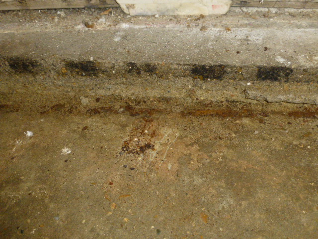

Areas of the floor are damp. There was an old blockboard timber panel. It was sodden/rotten damp and crumbled to bits when trying to lift it. This panel was dry at the time the laminate and underlay went down. Beneath the board panel was a layer of loose sharp sand (about 25mm deep). Beneath the sand, a very old man-hole cover.............
I can't see any evidence of a floor membrane around the perimeter of the room, around where the downpipe enters the floor in the corner, nor around where the manhole cover is.

What are my options for the floor... Painting a liquid DPM or suchlike over it and up the wall?, or laying a membrane sheeting with laps up the side of the walls..?

I've read countless threads re garage conversions on the various forums together with the application guidelines from the likes of kingspan and celotex... a lot of info taken onboard.
I haven't come across any examples with an internal render such as mine.. With what appears to be the liquid dpm on top, how does that affect things when using for example a celotex system where they specify the wall should be permeable..? Aside from me contacting Celotex tech and asking them, any ideas on this..? The majority (if not all) the advice I've so far read on the forums etc suggests to seal the internal side of the wall, not leave it 'clean'.
With that solid wall, then it's assumed that some moisture will go across from the outside.
So to prevent this causing a problem on the inside you need a barrier. This can be in one of several forms, and can either go on the internal or external face of the external wall.
Similarly, moisture will be assumed to enter the wall from the internal room - moisture from use of the building. So to deal with this, you either stop it entering in the first place, with a barrier on the room side (aka vapour check or vapour membrane, or you ventilate a cavity within the wall, or you insulate the wall to remove cold spots which could be condensation risk areas. Or a combination of these.
The easiest way forward is to place a big sheet of polythene on the internal face of the wall, then insulation within and across a timber frame with no air gaps, then a vapour membrane, then plasterboard. The details of this you can find in some of the other posts.
But the key thing, is the principle that you stop moisture coming through from the outside, you stop vapour entering from the room side, and you eliminate all voids within the wall to remove the chance of moisture condensing within the wall structure.
The existing render is irrelevant. If the existing waterproof coating is sound, then you could potentially recoat with similar instead of polythene. Either way, pay attention to the detail at floor/wall junction and wall/wall and wall/ceiling junctions.
