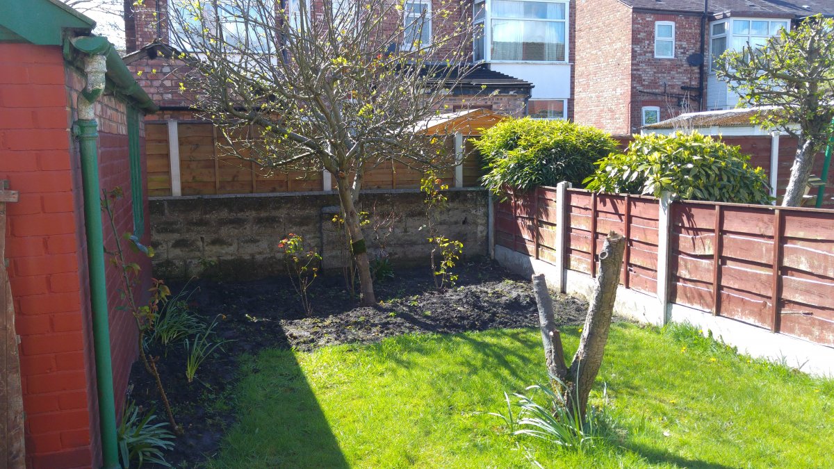

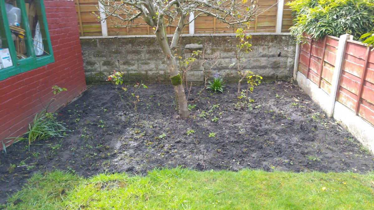

Hi
I have an 'average' sized garden for my semi.
There were 3 fruit trees originally, however by the time I got there, the was a stump in the middle of the lawn and an apple tree which dominated the end of the garden.
After a couple of good years of Cider, I've taken out the Apple tree and removed all the weeds (it was great for growing weeds in the shady area...)
Questions on what best to do now.
We would ideally like to extend the lawn and have beds at the back and sides.
The existing lawn, isn't the best (please see pics) as we have been focusing on the house (and cider).
We don't have any dogs, the child is 4 months, as such we can keep off the grass for a the summer if necessary.
The ideas are:
1) Throw down seed where the trees were and see how that grows. Plus scatter around the lawn to help bulk it up (it's a bit patchy in areas) (cheapest option)
2) Turf the areas where the trees were
3) Go whole hog and re-turf the whole lawn.
I'd obviously like to go for the option 1, whilst wanting the finish of option 3 :)
Been keen to know how much prep I would have to do with either seed or turf. Happy to get cracking and break the back for a few weekends :)
Of a side note I have removed the stumps, but not chased out and removed all the roots, would this be an issue?
Depends how impatient you are.
Both will look the same after they're established. Turf is quick but dearer and more backbreaking , seed is cheaper but requires time.
Check at a suppliers about different grass types too. Some are more suited to ornamental lawns whilst other species are better at coping with the kids playing football on it and of course a mix can be tailored to suit you specific needs.
If I'm remembering correctly there is an old saying about seeding which goes along the lines of "one for the birds, one to rot (or die) and one to grow" which is essentially saying sow more than you think to be sure. The last time I did a lawn I used seed and mixed it with sharp sand and raked it into a bed.

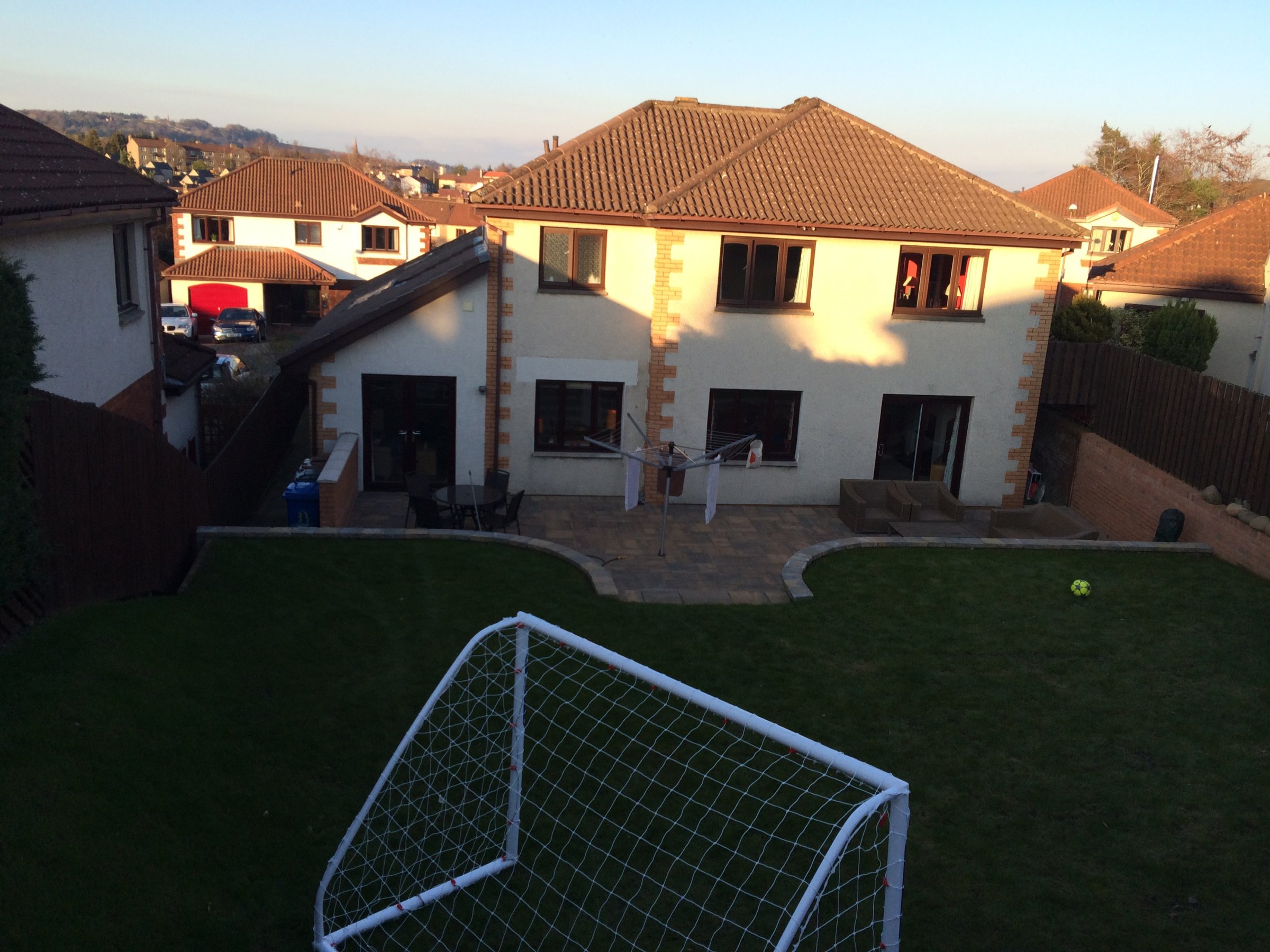

Seed will do as good a job for less effort and money - just needs time. First kill the weeds with glysophate, use a shopping basket to sieve the top few inches (that bit hurts but is worth it if stoney, though your soil looks good), level it out with a rake, then sow a decent grass seed at the appropriate rate (overseeding is actually no better than underseeding as it will impede growth - you can always sow more seed a month or two later), then water little & often and leave it to do its thing for the summer.
Here's mine (sowed October in Scotland, photographed March, though its even better now - lush!)

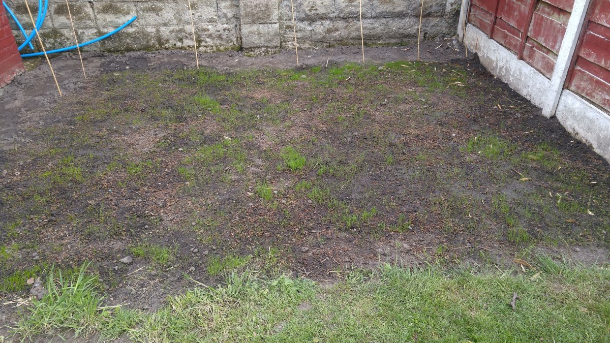

Hi
After a couple of weekends of weeding, flattening, turning over, more weeding, sifting stones, chicken manure, seeding etc.
10 days later it is looking like Rooney's hair mid transplant.
What should I do for the full Trump toupee.
Should I scatter more seeds?
Scatter and trying to turn over (but would that kill what is growing)
Wait a few weeks for the lawn to take, then buy some Lawn Thickener?
Cheers
One thing you haven't mentioned is watering. Unless it is raining you need to water every day with a watering can with rose on.
It looks fine, I am doing mine and it takes a lot longer than these seed packs say. About six weeks before it stops looking scratchy and thickens out.
Haven't used weed killer here. I have weeds coming up but I just pinch them out. Is working OK.
Ah yes I am watering every evening.
I am pinching the weeds I can reach, but ones in the center I was unsure, as I would have to step on the new grass.
I suppose I could setup a scaffolding plank and bricks so not to step on it.
Cheers for the reply.
Lol I have had the same worries here :D
However I have found grass I have flattened completely has revived in a couple of days, it's tougher than it looks!
I even pulled out a fair few blades in the weeding but now five days later it is filling in, haven't even been watering either :(.
Don't worry you'll be cutting soon!
Worry not - that'll thicken up over the summer as more of the seed germinates. If you feel the need in another month, mix seed with a 50/50 mix of topsoil & sand and spread it over the thinner sections. Best not to disturb the existing soil with young shoots.

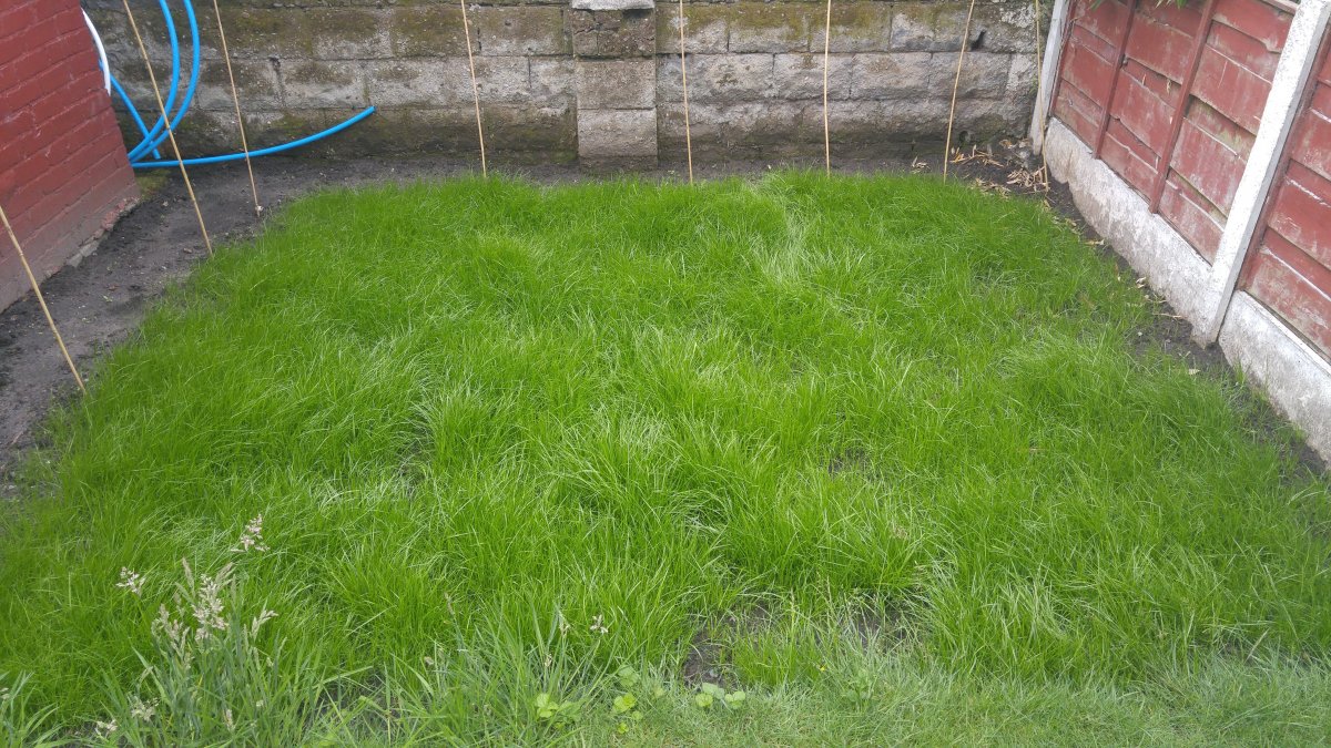

4 weeks in, It's start to thicken out in areas, though still patchy.
When should I do the 1st cut?
Think I am going to re-seed the patchy bits to thicken it up
That looks long enough to start mowing IMO. Do it on the highest setting for a while and slowly bring the height down.
