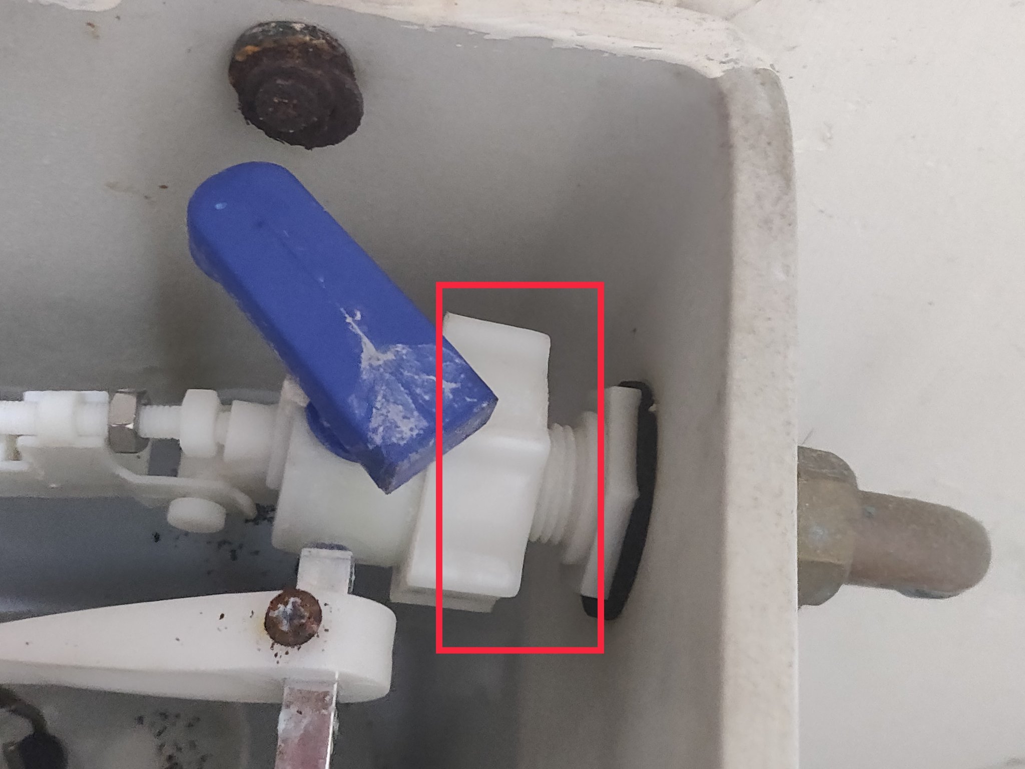

I have a small leak which I think is located within the red box in the attached photograph. It seems to be between the plastic part which looks intended to be turned by hand and the threaded section. I don't seem to be able to turn it by hand in either direction though. Any idea how I should proceed? It doesn't appear to be like any of those I've seen on YouTube. Thanks.

Stick a wrench on it and give it some! Should move
As said, use a wrench to loosen it. It's definitely removable. It will have the changeable diaphragm in there.
Maybe that big nut is just cross-threaded? That could account for its reluctance to move and the leak.
It should move with water pump pliers, but it could be damaged or the seal may have gone, which will need a new one.
