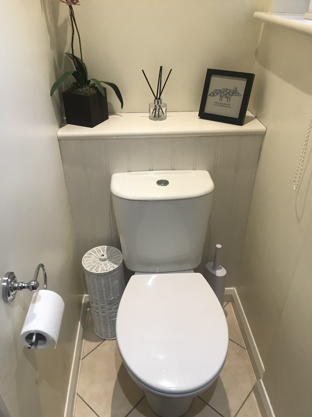

This. ^^ We have a Sanislim in our downstairs loo. Boxed it all in so very quiet too.

Nah. It went wrong after it had been in about 5 years - I chucked a wedge of Kleenex down it when I had a cold and it jammed up - didn’t notice until next morning when I heard a humming and buzzing. Toilet and cistern out in one go, lid off, pipes disconnected and with a little bit of a kerfuffle it was out. With the advice of Just Pumps on here, I replaced the capacitor and it was all good.
