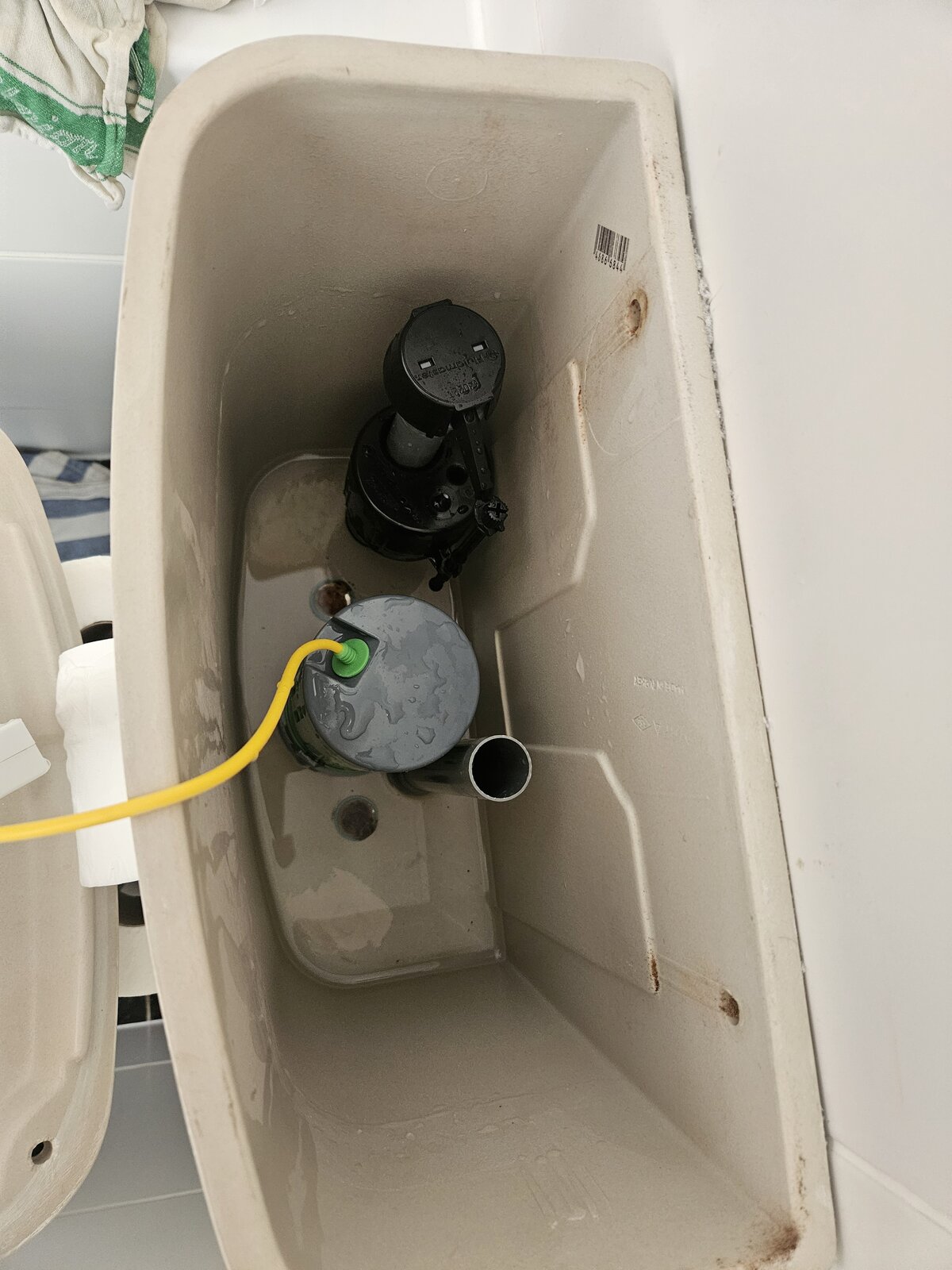

So recently discovered that water was dripping every so often along the toilet and decided to change the Valve Diaphragm Washer.
Took out the float valve, replace the washer and put everything back to normal.
Now when I put the water back on - it is not a drip but proper water flowing out and cistern is unable to stay full as always emptying. so i kind of make it worse as now the toilet is not usable....
If I change the full float valve, would that resolve it?
or should I call the plumber! lol

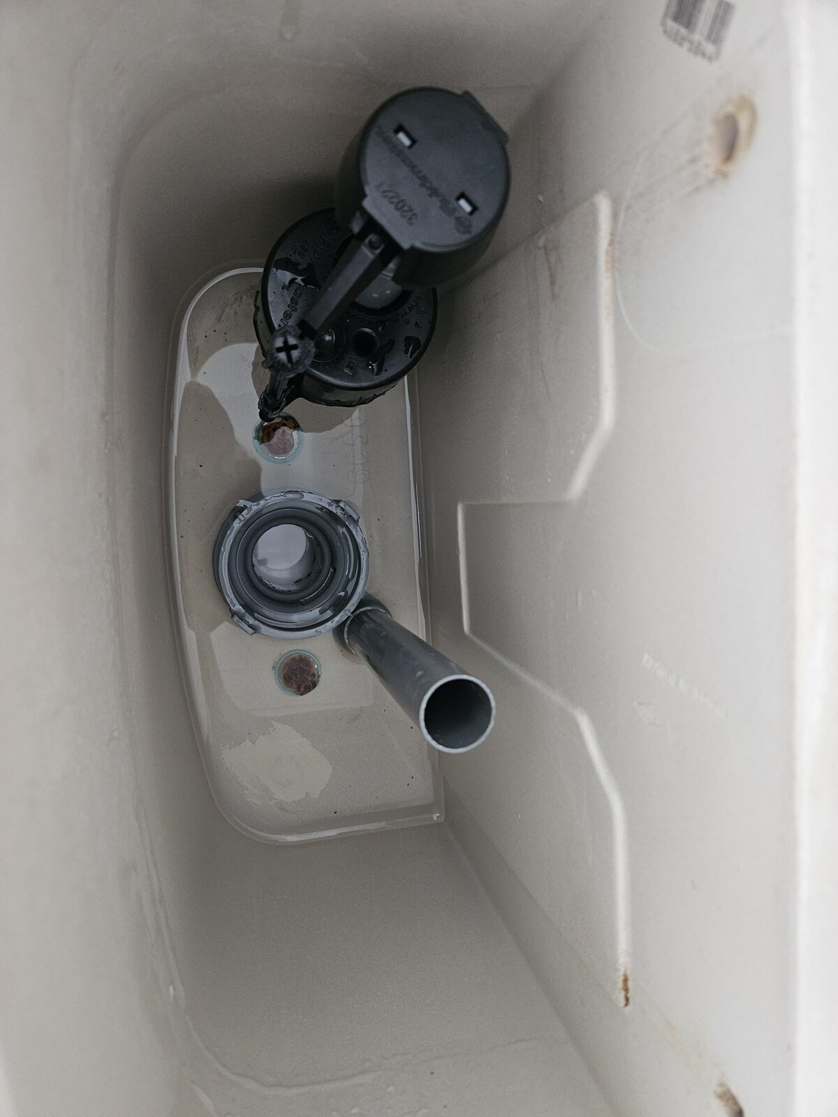

by the flush valve, you mean the one in the middle, not the one of the left. Let me try to do that

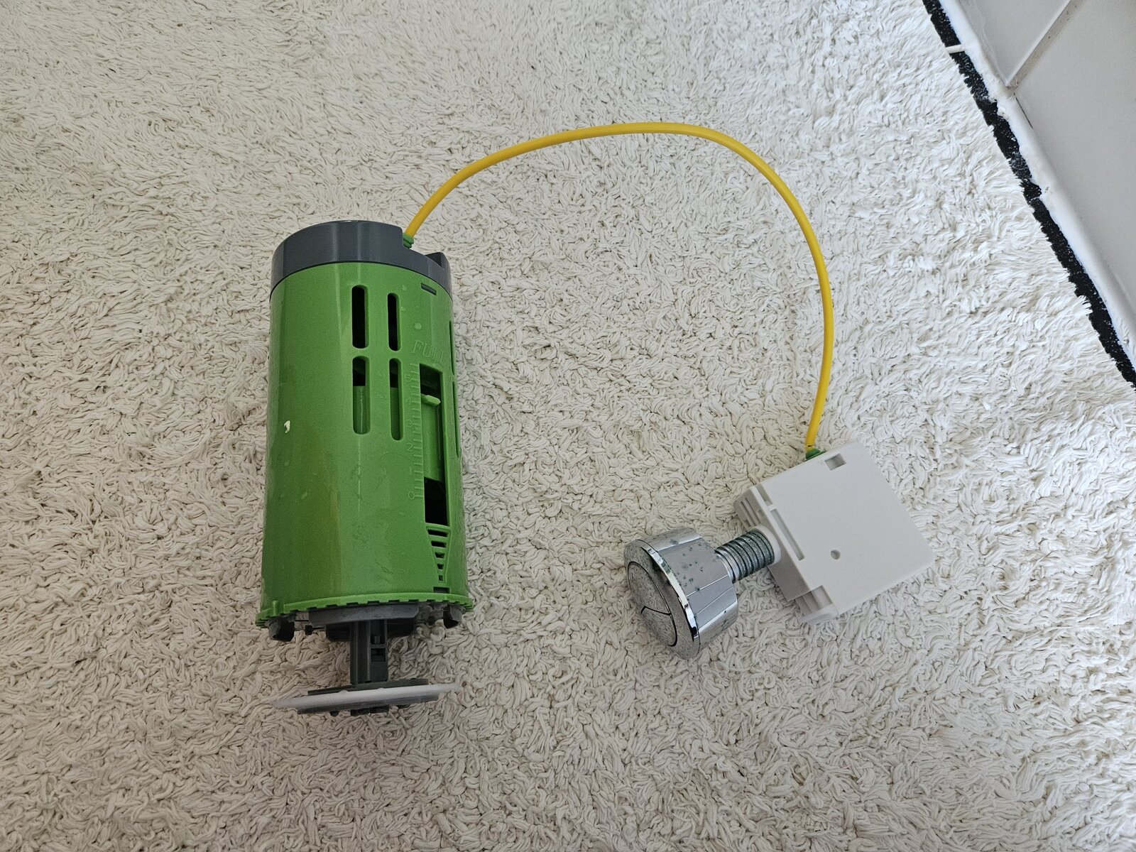

So took the flush valve out and look all right, washer is pretty good condition too - when I press the button, how should the valve react? I wonder if i put too much pressure on the cable when I lift the lid and maybe broken the cable and now the valve mechanism is slightly loose?
I guess next steps, back to the shop to get a a new flush valve rather than replacing the float valve?
Those cable types can be a pain. The valve should flush when button pressed. Does the cistern hold water with the lid off?
yes it kind of move when I press the button. When the lid is off, I fill it up with big bucket of water and water does not hold anymore at all. So have a feeling i might have broke something as it was holding yesterday!
Thanks for your input - greatly appreciated. Last try before I call for plumber for.

Welcome to the world of non British Standard plumbing. Since the relaxation (complete collapse) of the regulated plumbing world as it once was, any outlet can sell anything that looks good and is not overly expensive.
Place the lid on top of the cistern and then measure the gap from the bottom of the cistern to the button hole. That measurement will govern what brand/type of flushing valve that can be fitted, and there will probably be several to choose from.
Bite the bullet and replace the whole of that cistern's internals to start afresh. The poxy modern alternatives to the reliable tried and time-tested syphon are nothing but trouble. Start again with new cable free innards and give yourself a fighting chance(y)

Whoopps Whoops! At today's time, after a third run to the shop or was it a fourth...
and after deciding to take it all apart
Got that item which fit much nicer for the button flusher and that seems to have done the trick!
