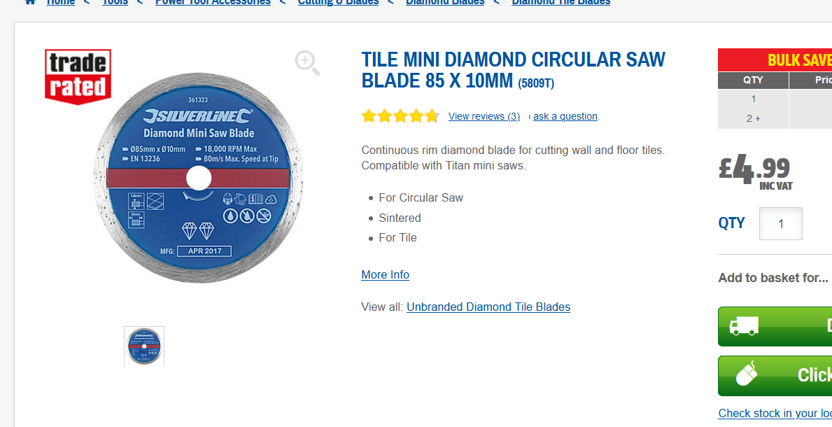

    Depending on how handy you are, it is possible to drop the branch down by chipping round the supersleeve pipe and cutting it from the inside with a 85mm tile blade on a dril with a 10mm bolt and washers for an arbour, you already have a 110mm repair collar above the branch.

    It looks to me that the black bit (what is this made of?) goes into a clay bend, but i cant be sure, i'll try to get a closer pic. Would prefer to replace the black bit, rather than cut it, access is pretty limited there. How would i get it off? I could always cut it shorter after its off anyway. Would i need to replace some pipe below the repair collar?
