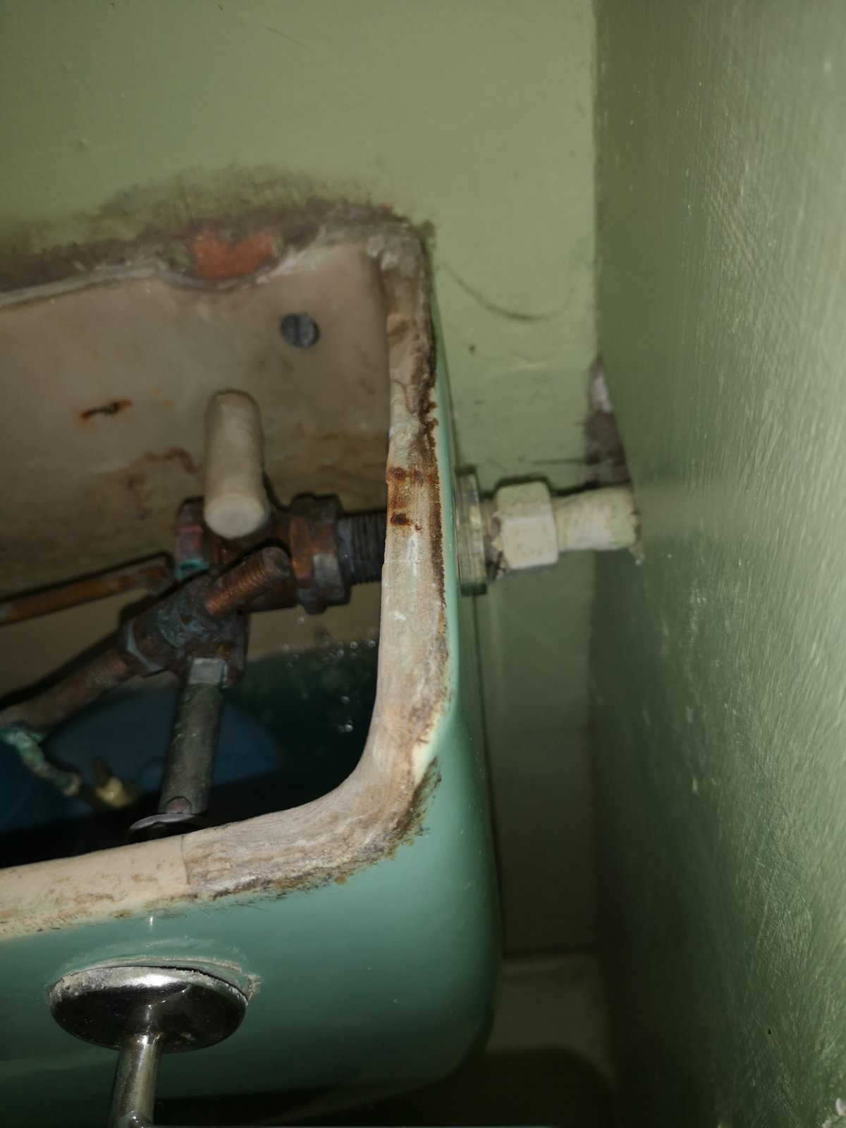

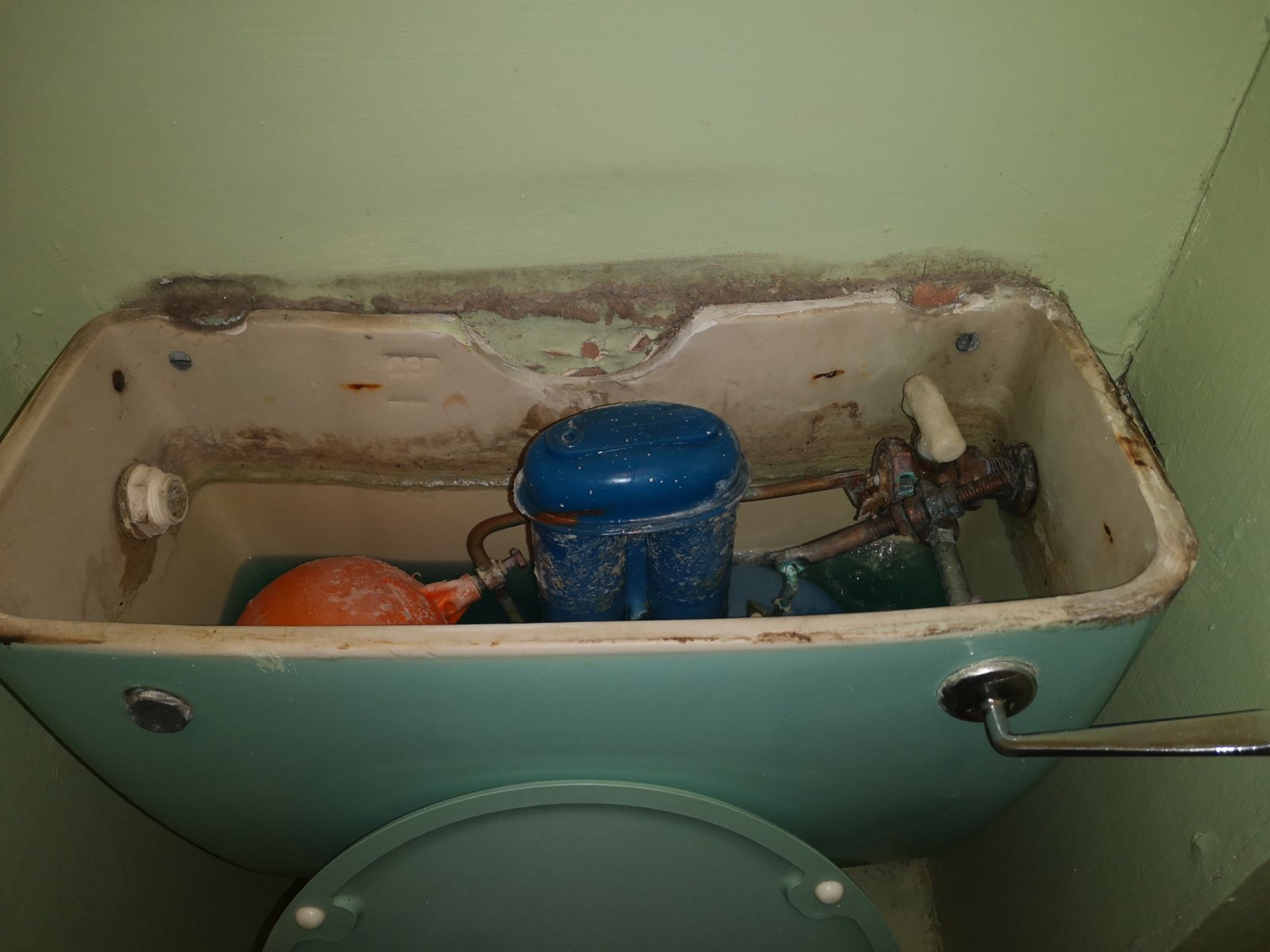

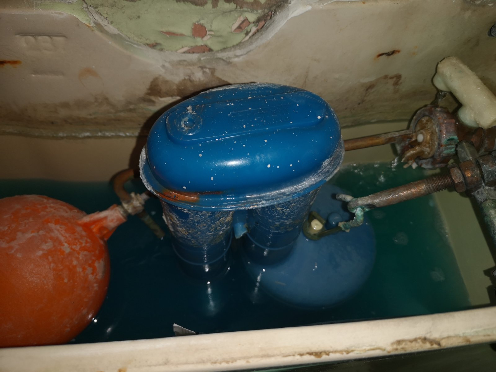

Recently bought a house and now have a lovely old fashioned toilet and bathroom suite (nice).
It takes agea.for the cistern to fill up once it's been flushed, and wondered if there's a simple way to get it to fill up quicker at all?
I can't help but think there's an easy fix but not too sure what I'm looking at, have attached some photos.

Try a Fluidmaster side entry fill valve. Should fill a lot quieter as well as quicker.

Check the supply pipe ( top right of cistern) that comes thru the wall .Trace where it goes / comes from ,looking for an isolation valve that may be partially closed down.
If this is in order the float valve may be partially blocked ,so you can service the valve or fit new replacement as advised above by ReganAndCarter.

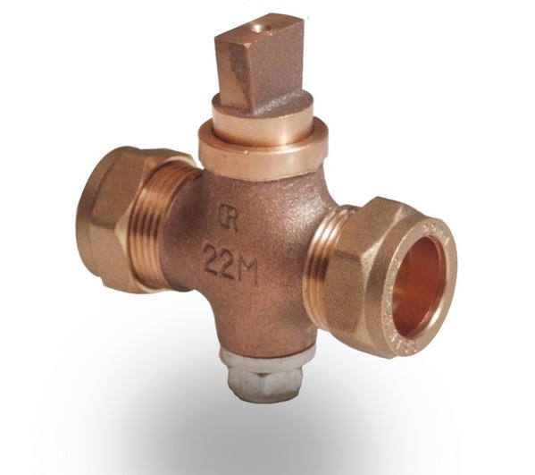

Also, another daft question. I have an old back boiler in this house, there is a tap next to that, I always wondered what its for (im assuming now that turns the water supply off?)

1. Turn off water to cistern.
2. Unscrew big brass nut. The one on the inlet valve nearest the float arm and furthest from the side wall of the cistern where the valve enters.
3. Take out diaphragm washer, take to plumber's merchants and get replacement.
4. Fit replacement, do up big brass nut again, turn water to cistern back on.
5. You may have to re-adjust the water level by moving the float up / down after undoing the bolt at the ball end of the float arm.
Total cost should be under £1.

Does the tap look like this ?.

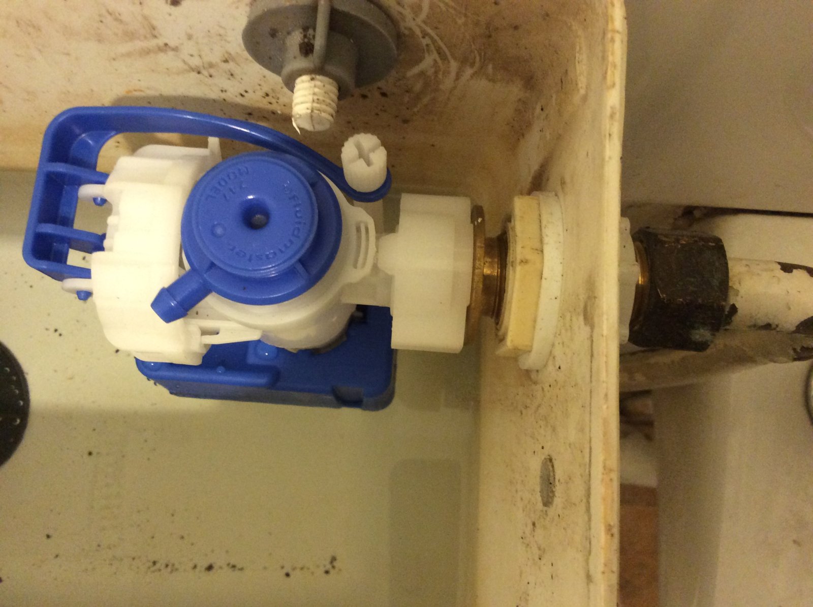

I fitted one to a temorary toilet this week, it fills really quietly. the thread is quite short if the cistern sides slope too much from vertical or are really thick.
Yours like mine, the siphon is in the way so has to be turned 180° to make room for the fill valve

Regardsing the tap above, I cant quite tell as it seems its been boxed in at some point. Its a tap ive not touched located on the right hand side near my back boiler/firefront. I have no idea what it could be for.
