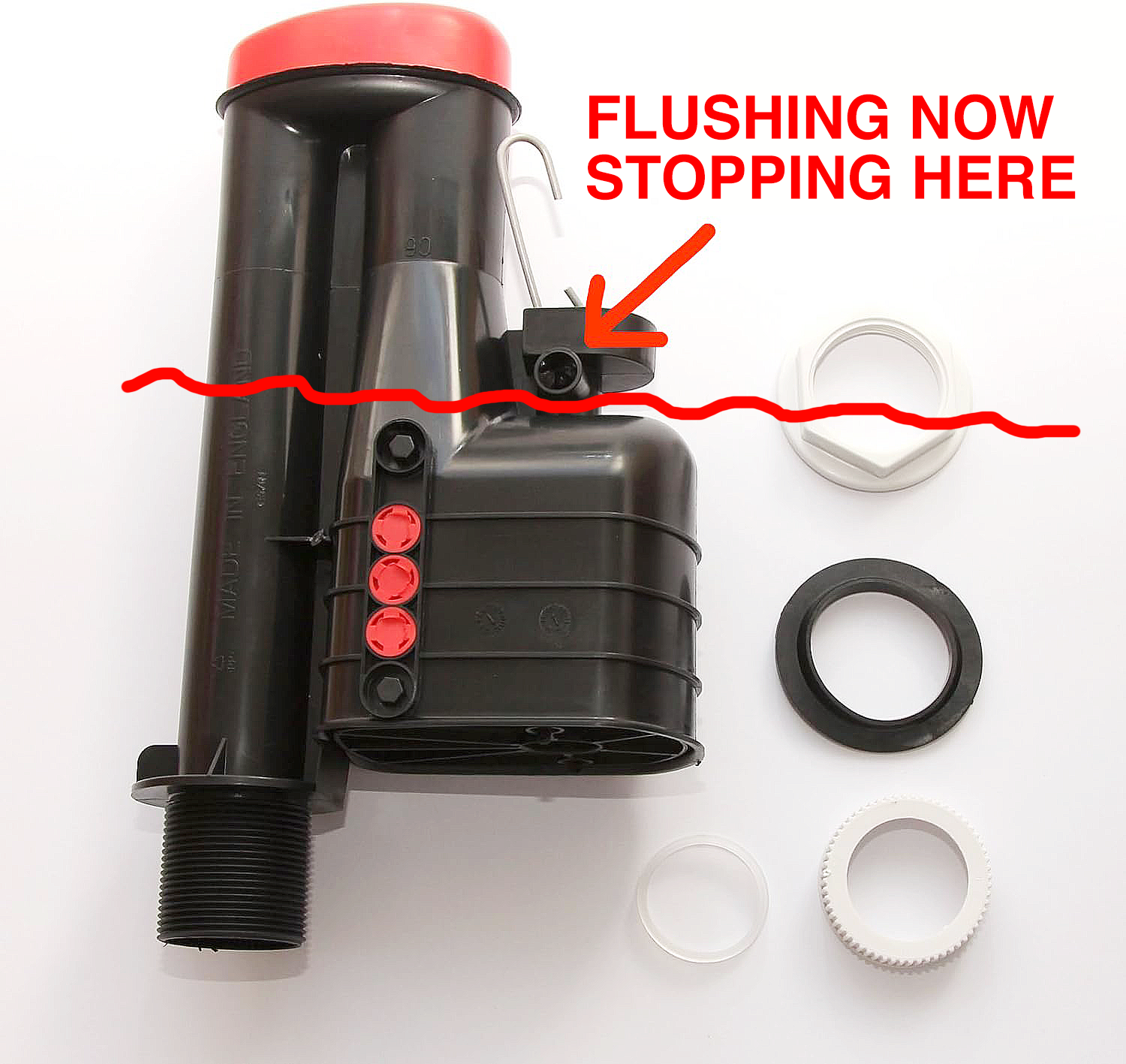

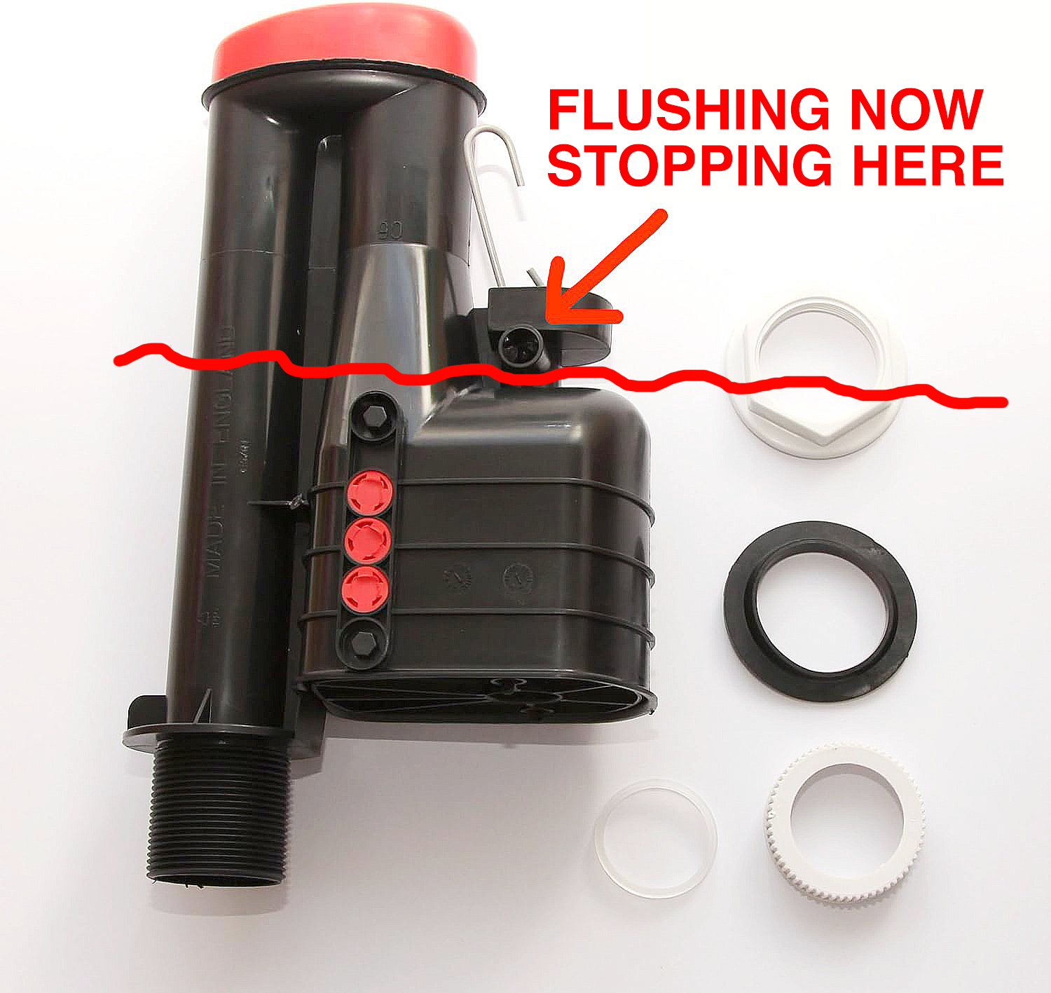

Hello!
I was checking something in the toilet cistern. I flushed, but holding the float ball, so the cistern wouldn't be filled. With a very low level of water in the cistern, I flushed a couple of times. Then I let go of the float ball and the cistern was filled.
I didn't do or change ANYTHING.
The problem: Now, when I flush, the siphon stops the flushing at a much higher level than before, flushing much less water than before. The flushing now stops every time at the hole you see on the picture. Before, it was stopping at one of the holes on the left (that is, at a much lower level).
Again: I didn't change ANYTHING. The hole the arrow is pointing to has always been unplugged.
Was it bad that I flushed without the siphon being covered with water? How can I make the siphon go back to flushing normally (that is, almost emptying the cistern)?
Thank you!

Did you remove the siphon hook from the handle? If yes, what happens if you disconnect it again and manually pull the hook up?
Thanks, but can the float arm stop the siphon from flushing? I don't see the connection.
The problem is when I flush the water goes down, but the flushing process now stops earlier than before. No problem with the cistern being filled. It's just the flush that stops too soon now, but I don't know why (because I don't know how a toilet siphon works, for example if it has something to do with pressure).
PS: I didn't change or remove or disconnect anything. I just flushed 2 or 3 times when the water level was low. Now — because of that? — the flushing is shorter (stops earlier).
The hole at the side releases pressure earlier reducing the total flush .plug needs to go back in .
Thanks, but that hole (the red arrow on the picture) has always been open (unplugged). I didn't touch it (I don't even have any plug for it). The picture I attached is from Amazon and that hole comes unplugged. So, maybe it's supposed to stay unplugged?
It might sound silly, but are you flushing it correctly?
I long pull may release a lower load, a short pull may release more water. Try both.
Sorry, I edited my post. Yours is a dual flush siphon. Please try a long pull, and then a short pull.
Thanks, but it doesn't seem to have anything to do with how I pull. The flushing process stopping earlier started after I flushed 2 or 3 times with a low water level (it was all I did). I don't know what changed inside the siphon/valve. The cistern fills up normally, I flush normally, but now the flushing process stops earlier.

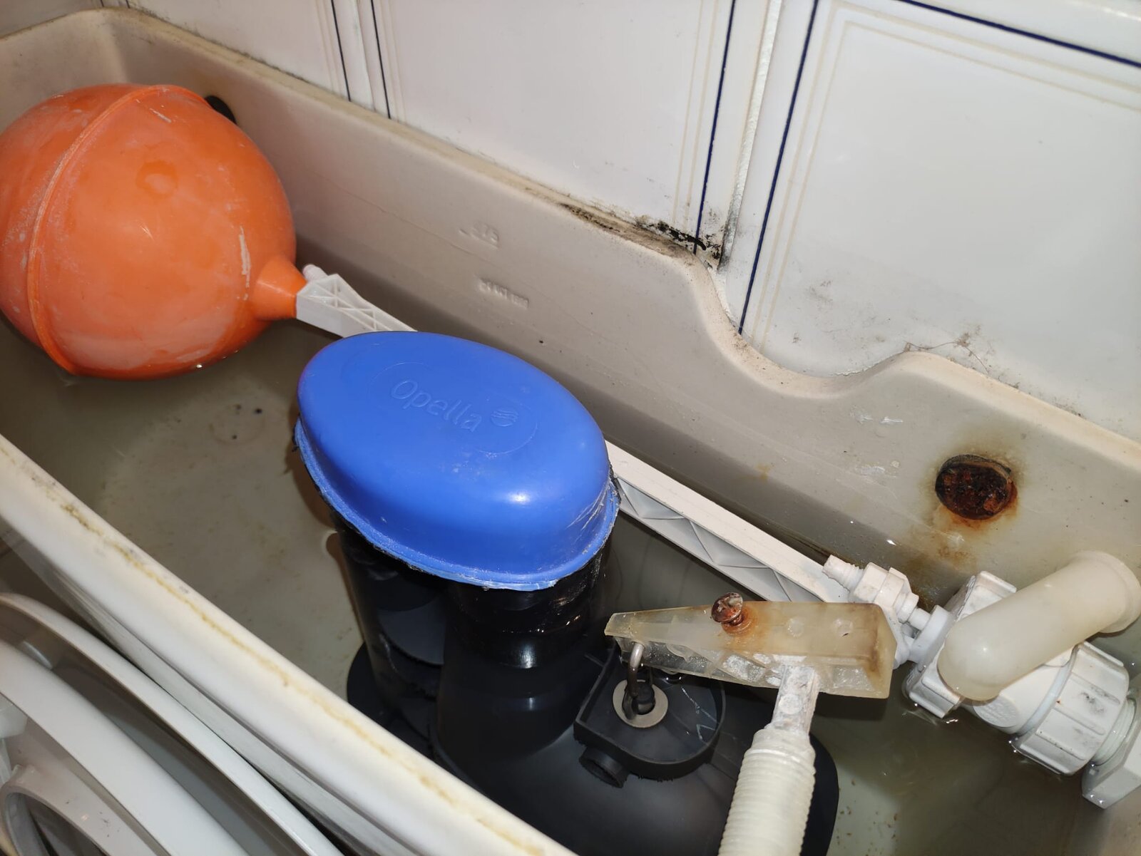

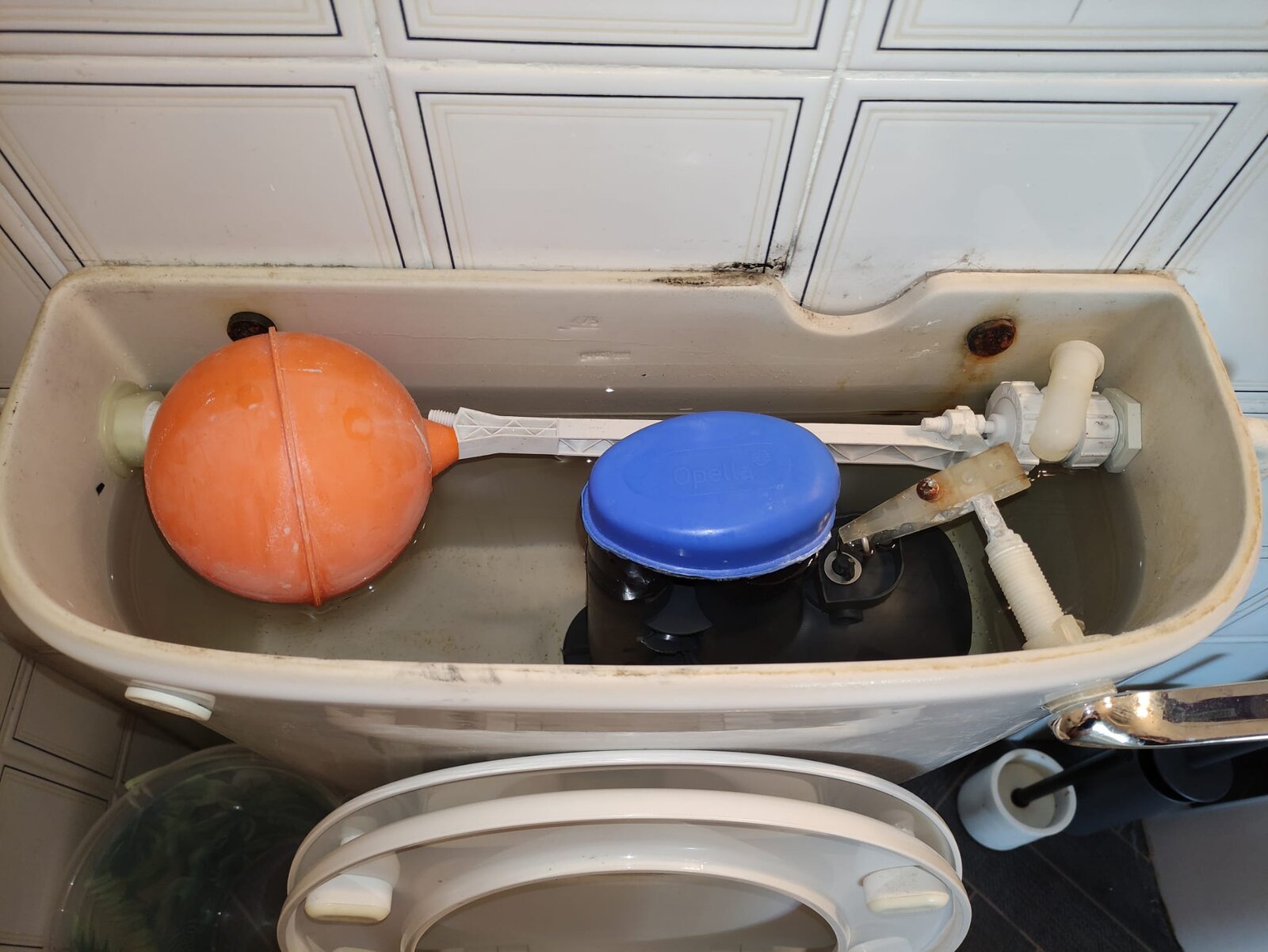

Show us pics of your actual cistern inners,including the water level before flushing,and the position of the blanking caps on the siphon.
I don't know what you mean with "blanking caps", but if you mean the little red caps on the holes you see on the original picture above, there are no caps. The little holes on the side (to make the flushing stop at that level) are all unplugged.
