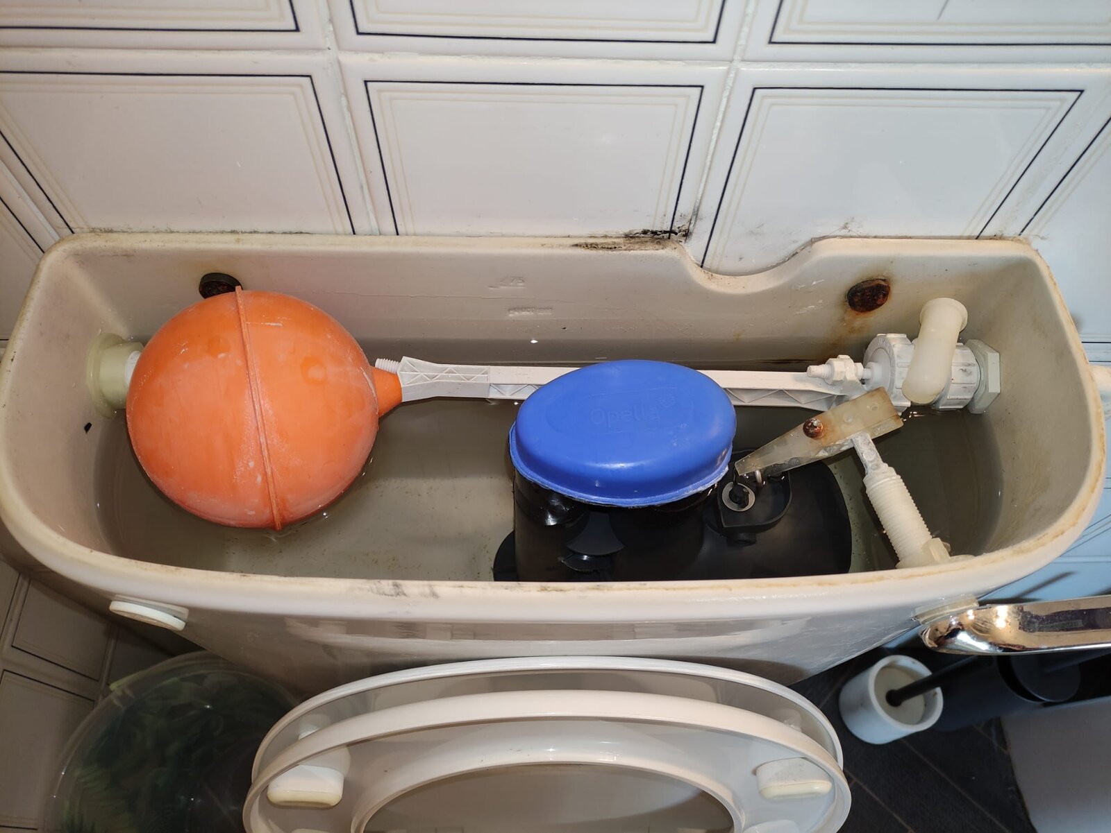

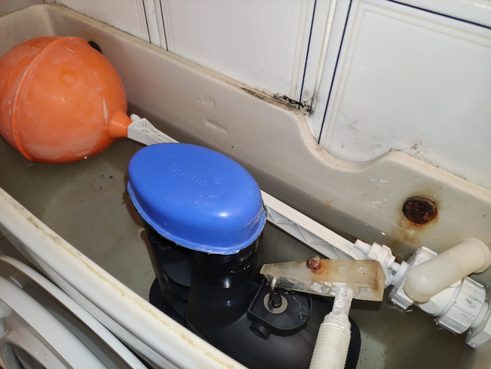

Toilet siphon flushing much less water now

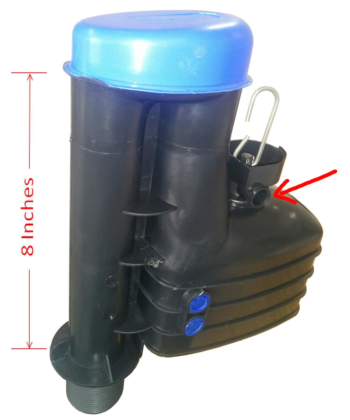

I don't know what you mean with "blanking caps", but if you mean the little red caps on the holes you see on the original picture above, there are no caps. The little holes on the side (to make the flushing stop at that level) are all unplugged.View attachment 317768View attachment 317769
Thats why it's not flushing a large volume ,there should be a blue bung ( blanking cap),in the higher of the holes on the side.
Put your thumb over that hole and flush ,it will flush a larger volume.
The water level looks a tad too high and appears to be close to the overflow outlet ?
If you mean the hole that is closest to the chain, (please, see the picture), it wasn't plugged before — and the flush was normal.
The holes that stop the flush are on the left side, close to the bottom, and they are unplugged (the flush was stopping there). Now it's stopping at a much higher level (above these holes).
As I said, I didn't change (unplug, etc.) anything. I just flushed 2 or 3 times with a low level of water. This problem started after that.
If the flushing stops at a higher level than the holes ( for the blue bungs ,on left side of Syphon) then air is entering somewhere near that level and breaking the syphonic action. Maybe there is a crack. I would suggest you replace the Syphon.
