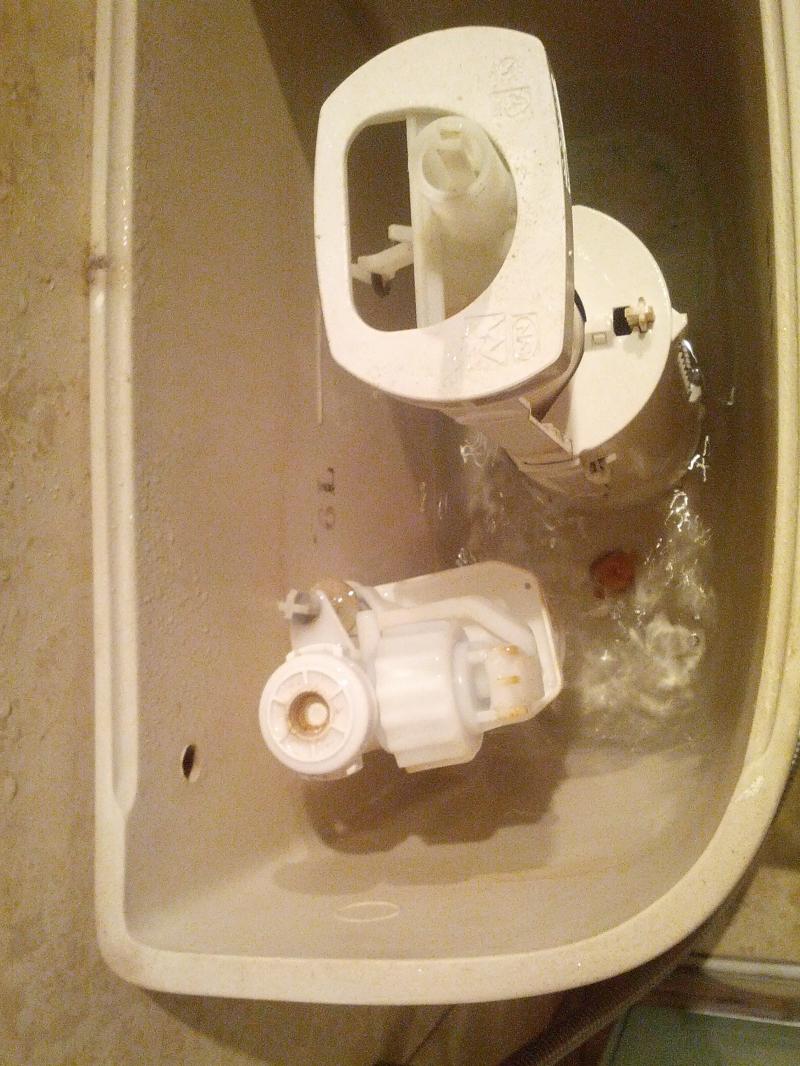

Hi Guys, what a brilliant forum. I have this cistern mechanism. I have put the new diaphragm in and it is now filling up inconsistently. Sometimes the float stops it overfilling and other times it flows over down the overflow into the bowl. Other times if I flush fully and drain the tank it just runs into bowl (stays less than an inch full) and doesn`t fill tank at all, any ideas folks?? Many thanks.. :)

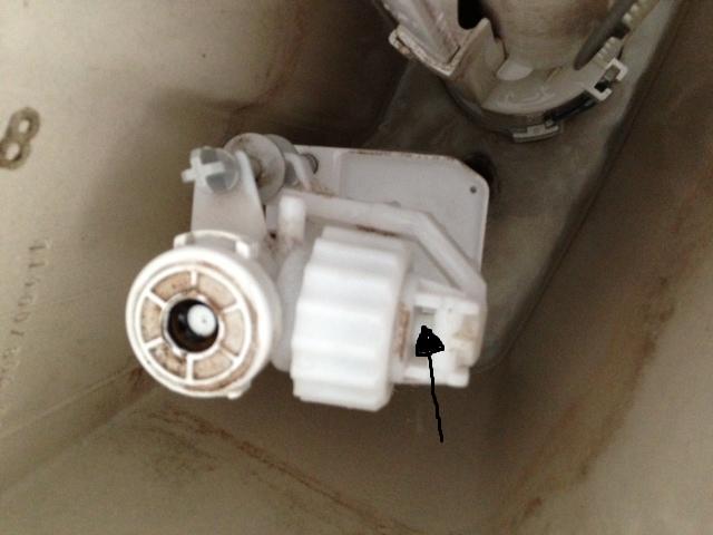

Hi Brilliant advice, however i have swapped the diaphragm washer and it still takes 15 mins to fill the cistern. where the nut/lever is its like a fine spray coming out?
Any ideas greatly appreciated . thank you
Kev
This is a pic of the valve thats causing me problems
GALLERY]
...where the nut/lever is its like a fine spray coming out?
Kev

Hi guys. Need some help. Having a bit of a problem.
Have the siamp single flush toilet which stopped filling up so changed the diaphragm as discussed on all other posts. This fixed the problem and the water began to flow but only about an inch up the cistern and then it stops again. Checked washer in properly. Took it all apart again but can't figure out what's going on.
Can anyone help? Am struggling. Looked on the siamp website and everything but doesn't mention this problem. :(
Thanks!
My cistern is slow to fill too with the water seeming to leak out in a fine spray though the swivel arm by the white plastic nut however, when i run the bath taps, this seem to temporarily fix it and the cistern fills up normally.
So if this was the washer, surely this would always be problem or we have a pressure/pipe problem?
what do you think?
GALLERY]
Sorry to open this thread up again, but mine is taking forever to fill, like a couple of hours, it is exactly the same as this and water is just spraying out of the top, which bit do i need to unscrew please
managed to work out how to upload a pic, sorry kev used your pic and added a little black arrow to show where water is spraying from
