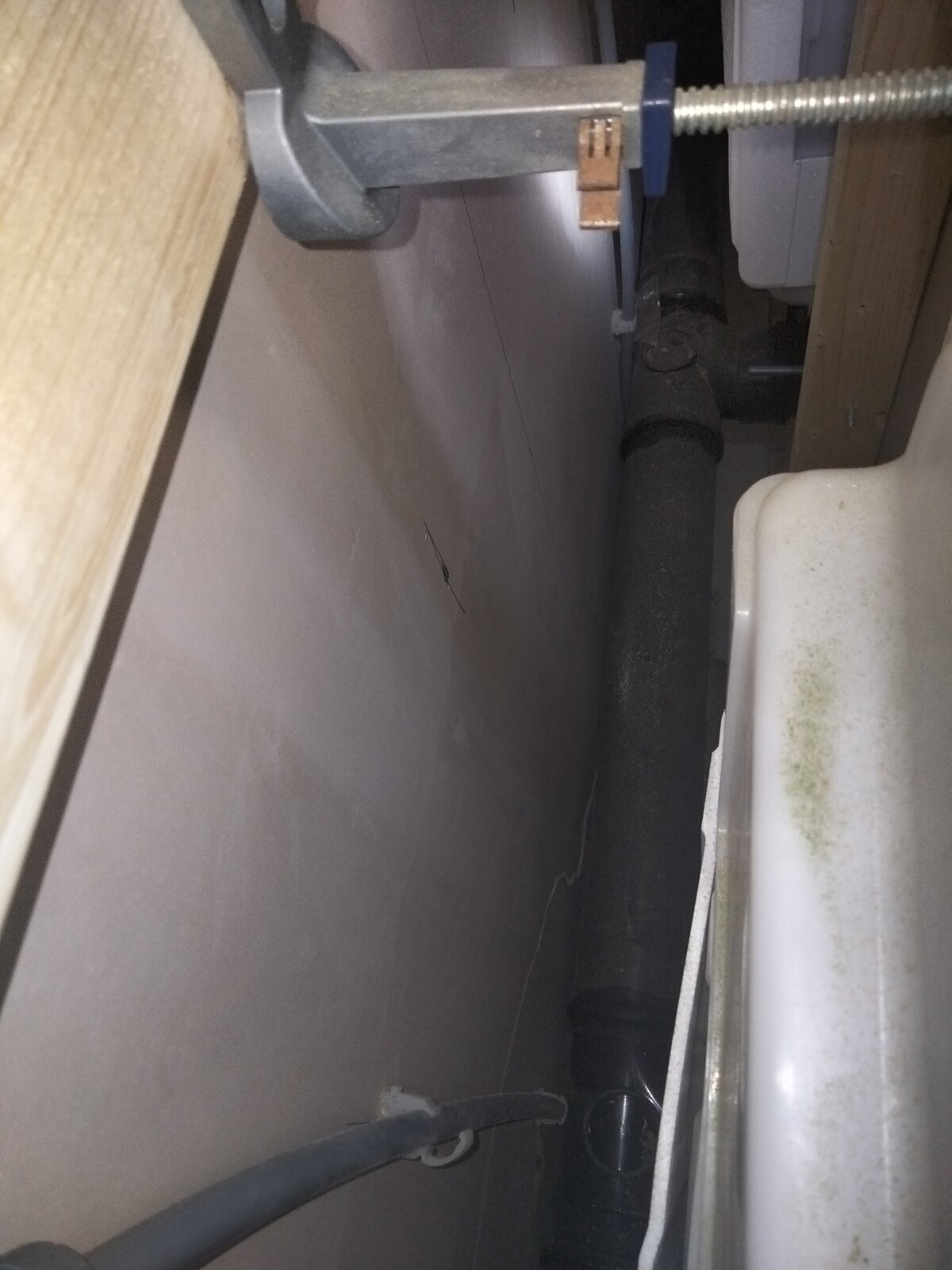

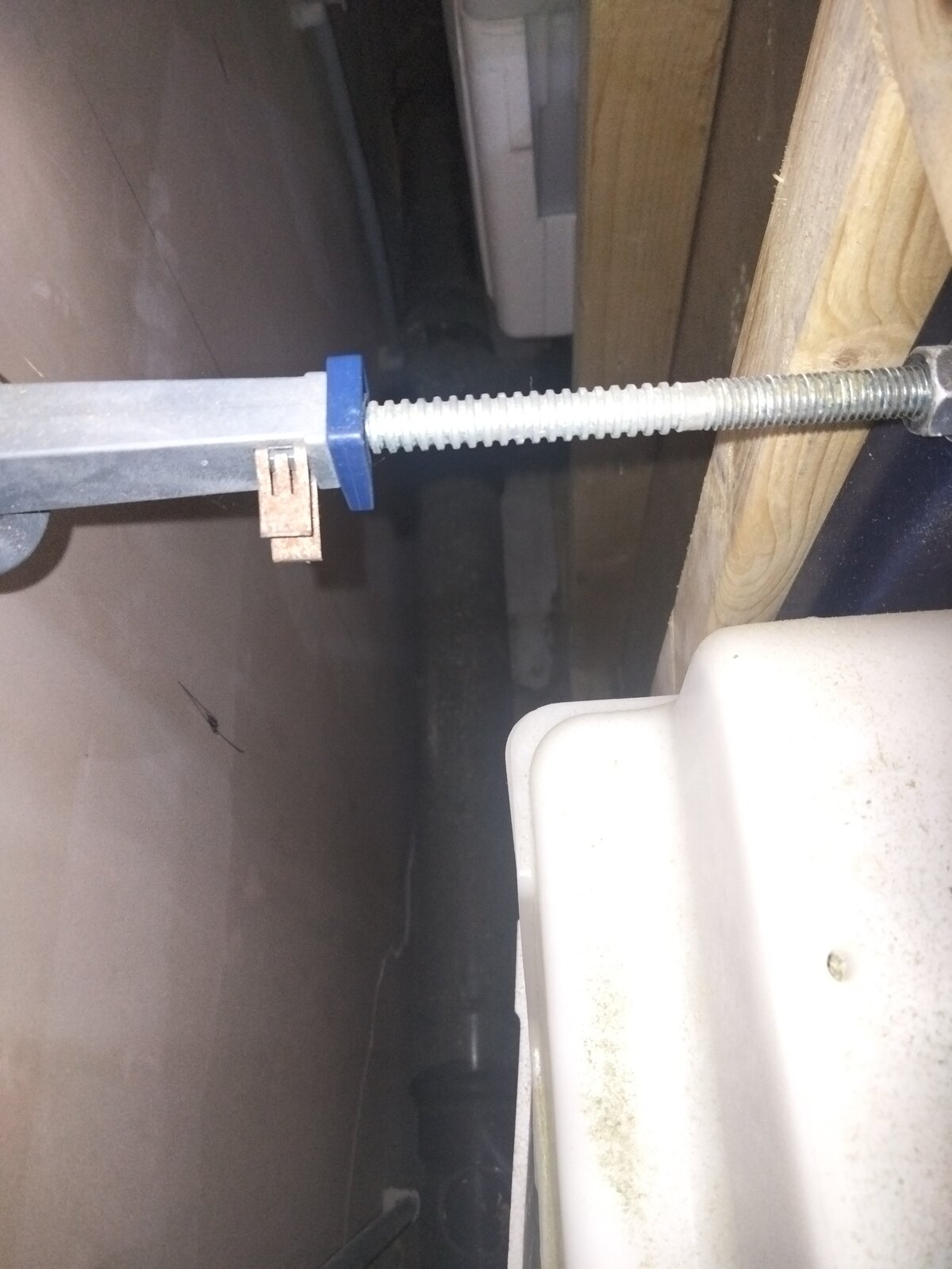

What could be the cause of a toilets trap water turing brown when it is not used. It's the last toilet on a run of 2 toilets. It keeps turning brown even though the toilet isn't being used. Flush it and the water is clear then it turns brown again after a couple of days.
No clips but pipe supported by bricks have had level on it and is a decent fall.
When flushing the first toilet you can see the trap move up and down on the second toilet.
There is no vent or aav on the run so wondering if this is the issue. However the installation has been ok for 3 years previously.
That could be part of the issue, it is not draining fully. Have you checked the manhole where they discharge to - any sign of it backing up?
