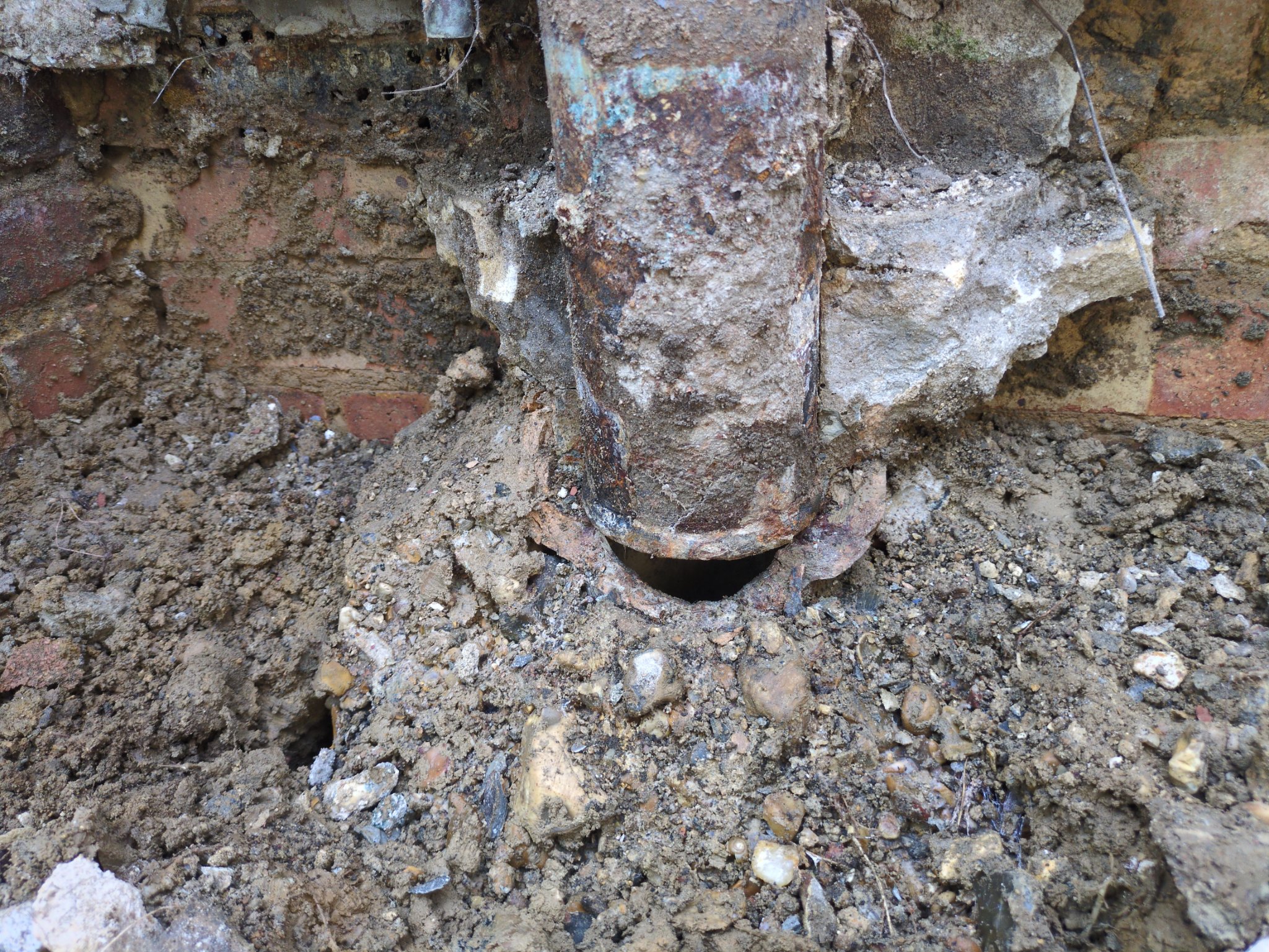

I'm taking out the the concrete patio and cracked the clay waste pipe to cast iron downpipe connection. Please see the photo.
What's the permanent fix for this?
The clay pipe is encased in concrete below ground, not sure how far down the concrete goes below ground, but the pipes go down about a metre or so.

Actually I think that the bottom section in concrete is also cast iron
You need to investigate and determine the state of it in the ground and decide how much you want to replace.
You can use a UPVC Soil to Clay adapter which will fit inside the iron pipe.

Looks like the (damaged) female end of a salt glaze pipe to me, connected under the SVP.
Clay pipe connectors are concreted in, could be a long weekend :oops:

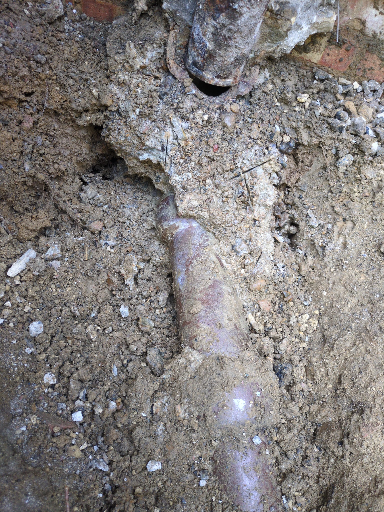

Make a v with a disk cutter and use a lump hammer and chisel in the v point.
Mate was a fencer and that's how he bust concrete in posts easily.
Cheap SDS with a chisel fitted works well

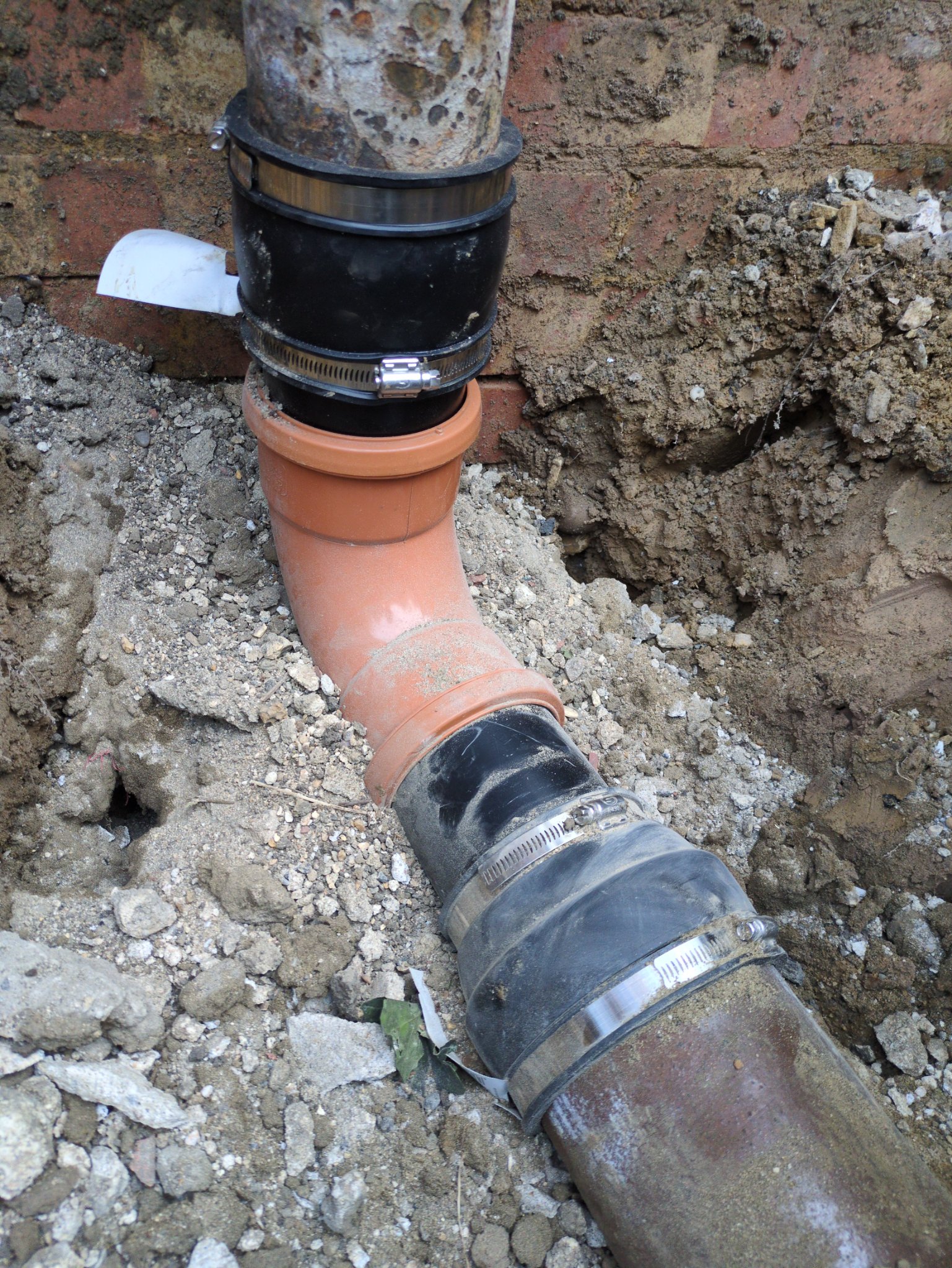

Cast iron into flexseal connector, 110mm pvc into 90 bend pvc, 110mm pvc into flexseal clay pipe connector.
I used my concrete cutter straight through the clay pipe as it was also broken lower down.
Thanks for the help guys

Neat fix. A rest bend would have been better though. (y)
