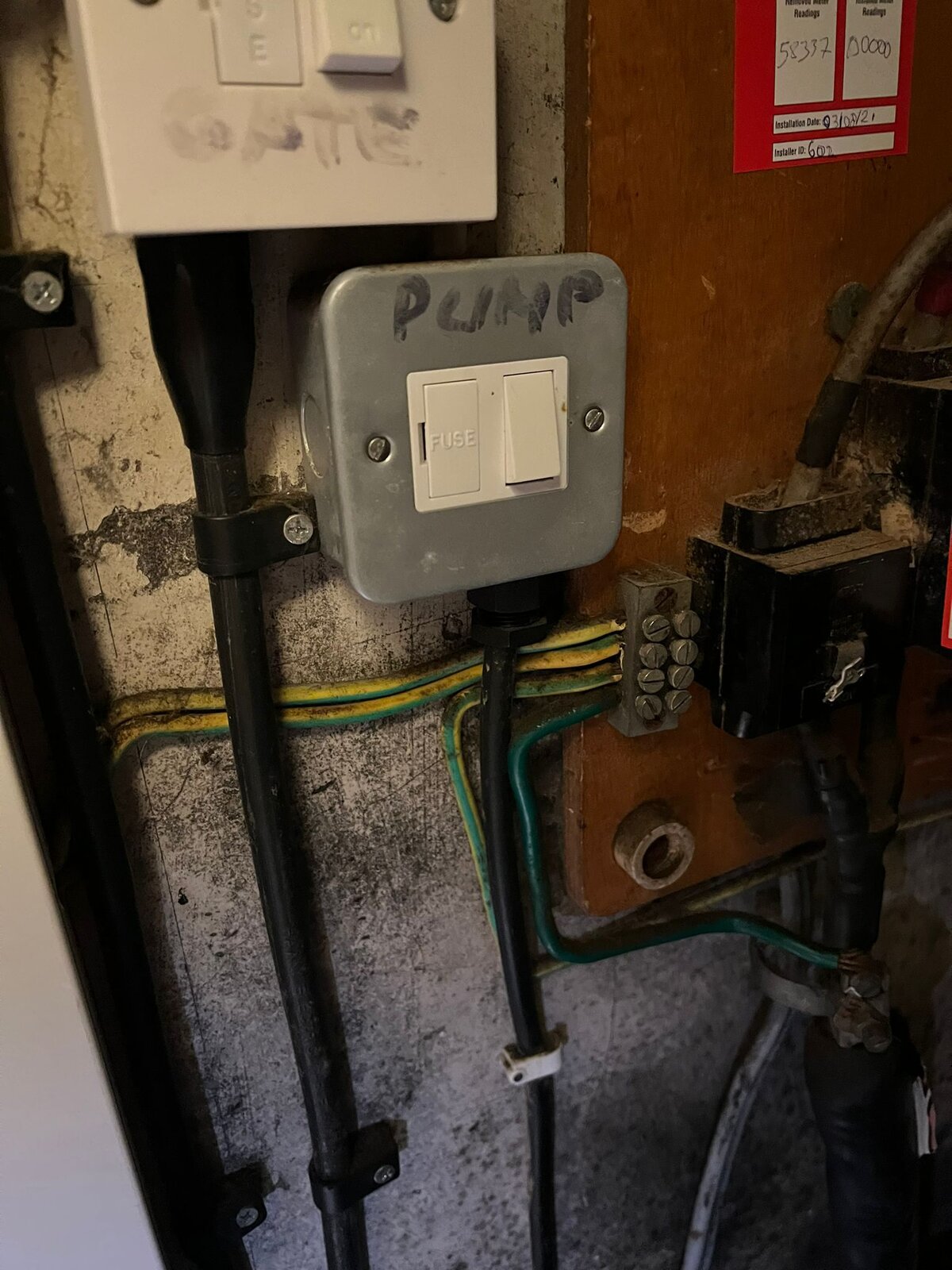

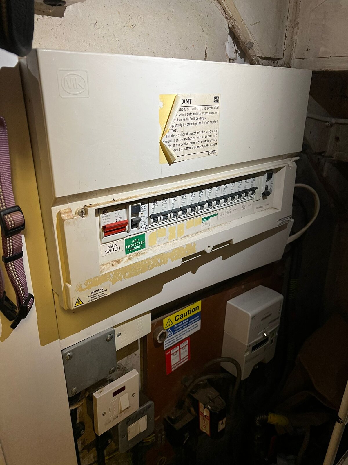

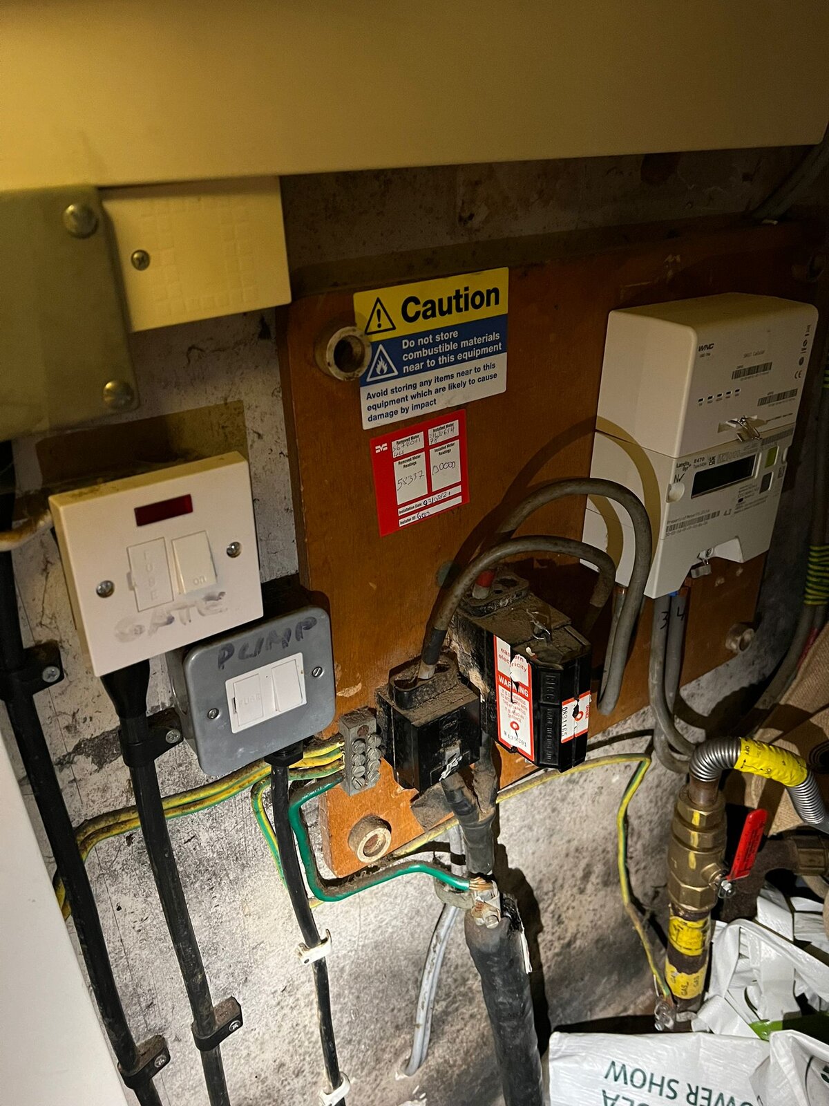

Are you able to post a picture of your mains intake and consumer unit area, so we can establish what earthing system you have, and what you have in terms of RCD protection If you have an earth provided by the DNO they are obligated to maintain it. If you are getting high loops on sockets as well then we can probably rule out a poor joint on the cooker cirucit being an issue.
If the cirucit is on RCD then the loop being a little high for the 40A breaker is not so much of a drop everything and get it fixed before you can can cook dinner issue. Yes, high incomming loop does not need addressing, afterall it could deteriate further (which is why a 32A breaker is probably not the pancea others think it is, yes it tests out fine now, but what about in three months time?) but a 30mA RCD technically has a maximum allowed loop of 1666ohms (however if you are anywhere near this value, then its going to be to very unstable, but it does have the ability to act in a sticking plaster sort of way to give you fault protection until the DNO can dig up the road and fix the actual issue)

It looks like everything is RCD protected, so the risk of a high resistance suppliers earth is a lot less than if it wasn't. An RCD can actually be used as fault protection, but this is generally discouraged in TN systems, and definatly not really the done thing when you suspect there is a fault that ought to be fixed rather than ignored.

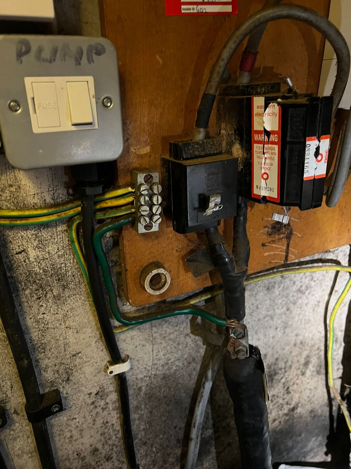

You have a TN-S earth (at least as far as its presented to you), SNE (separate neutral, earth) in DNO terms with the lead sheath of the cable providing the earth conductor, TNS supplies => 100A are allowed to have a Ze of upto 0.8ohms, but I'd suspect that yours is probably a little over that, plus having it that high in what I'm guessing is a tightely packed urban area is unusual without a fault. What often happens is the joint where your service cable is jointed to the street main breaks down over time (bearing in mind your incomming service is going to be at least 60 years old, likely even more) Or sometimes the supply is looped through a neighbouring property first, and the arrangement connecting the two sheathes is no longer as it should be (your earth connection does look to be using the wrong type of clamp, but doees not seem to look insecure - but dont try and fiddle with it)
Best think to do is get in touch with the DNO (Who I suspect is EDF as they look after the old LEB (London Electricity Board) area) and tell them you have been told you have a high Ze / and can they come and look at sorting it. The first thing the DNO will do is a loop impedance and then they'll tell you whether they think there is a problem or not, if you are on site when they are there, try and ask what they measured, and also note whether they turned you off, separtated their incomming cable from your earths and tested the incomming alone (as opposed to doing it with everything still connected - which can mask problems)

That connection to the PILC incoming cable looks like it's via an earth clamp, which is a no-no.
Best replaced with a constant force spring which is a coiled strap which is wrapped around the lead sheath of the incoming cable. Only the DNO can work on the incoming supply.

Looking at picture there seems to be an earth clamp around the supply cable, so could be TN-S or TN-C-S or even an unofficial link to DNO earth.
The DNO are duty bound to tell you max Ze and earth type. But you say an electrician attended, so back to first post, why did he not test it? It is so easy for a scheme member electrician who must have the test gear.
I'm struggling to get my head around that statement :-) The OP has TN-S, and the only other type of "supplier's earth" is TN-C_S, which surely would be (I would say 'inevitably') less likely to have a high Ze than does TN-S,wouldn't it ?
Can you clarify? What am I missing?
Kind Regards, John
I'm struggling to get my head around that statement :) The OP has TN-S, and the only other type of "supplier's earth" is TN-C_S, which surely would be (I would say 'inevitably') less likely to have a high Ze than does TN-S,wouldn't it ?
Kind Regards, John
Could he have meant the risk of injury by electricution to the client is less, due to having the rcd protection.
With a high Ze an rcd protected circuit is more likely to go off under fault than a mcb protected circuit, would it not

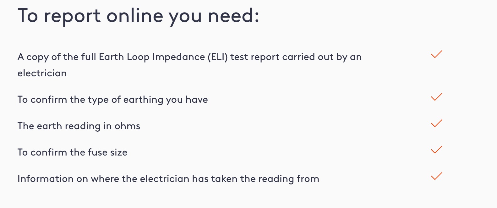

Thanks - I just checked and we're with UK Power Networks (great name!). Sadly it seems I do need to pay an electrician anyway - I've attached a list of checks they need before they attend.
How? Only way I know what size fuse I have is I was there when new meter fitted. They have seals on them. I have in the past used the enquiry methods to get the Ze, the DNO should have it on record, if not they have to send some one out to measure.

I'm smiling thinking how it would go if I called UKPN and tried to argue with them :)
Not sure I have much choice? It's so annoying a broken hob as led down this expensive rabbit hole! But I guess if it's a safety issue, better to be poorer than dead.
I called UKPN - went as well as I expected. They just redirected me to the form I already told them I'd seen. Computer says no.
