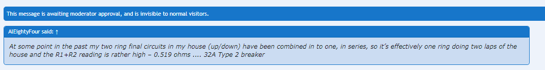

At some point in the past my two ring final circuits in my house (up/down) have been combined in to one, in series, so it’s effectively one ring doing two laps of the house and the R1+R2 reading is rather high – 0.519 ohms

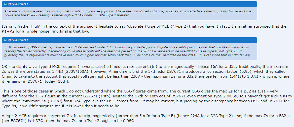

At some point in the past my two ring final circuits in my house (up/down) have been combined in to one, in series, so it’s effectively one ring doing two laps of the house and the R1+R2 reading is rather high – 0.519 ohms .... 32A Type 2 breaker
It's only 'rather high' in the context of the archaic (I hesitate to say 'obsolete') type of MCB ("Type 2) that you have. In fact, I am rather surprised that the R1+R2 for a 'whole house' ring final is that low.
... If I’m reading OSG correctly, Zs must be < 0.79ohm, and whilst I don’t know Ze (no tester) it could quite conceivably push me over that. I’d like to know if I’m reading the tables correctly, if somebody could please confirm? The reason it passed on the 2011 EIC appears to be mis-ID’d MCBs as type B, not Type 2. I'm guessing the Zs requirements must have been much higher for that setup back then (1.44 ohms Zs max recorded on the 2011 EIC, I can’t find that in 18th tables)
OK - to clarify .... a Type B MCB requires (in worst case) 5 times its rate current (In) to trip magnetically - hence 160A for a B32. Traditionally, the maximum Zs was therefore stated as 1.44Ω (230V/160A). However, Amendment 3 of the 17th edof BS7671 introduced a 'correction factor' (0.95), which they called Cmin, to take into the account that supply voltage might be less than 230V - the maximum Zs for a B32 therefore fell from 1.44Ω to 1.37Ω - which is where it remains (in BS7671) today (18th).
This is one of those cases in which I do not understand where the OSG figures come from. The current OSG gives the max Zs for a B32 as 1.11 - very different from the 1.37 figure in the current BS7671 (18th). Neither the 17th or 18th eds of BS7671 even mention Type 2 MCBs, so I havent't got a clue as to where the 'maximise Zs' (0.79Ω) for a 32A Type B in the OSG comes from - it may be correct, but judging by the discrepancy between OSG and BS7671 for Type Bs, it wouldn't surprise me if it is lower than it needs to be!
A type 2 MCB requires a current of 7 x In to trip magnetically (rather than 5 x In for a Type B) (hence 224A for a 32A Type 2) - so, if the max Zs for a B32 is (per BS7671) is 1.37Ω, then the max Zs for a Type 2 ought to be 0.98Ω.

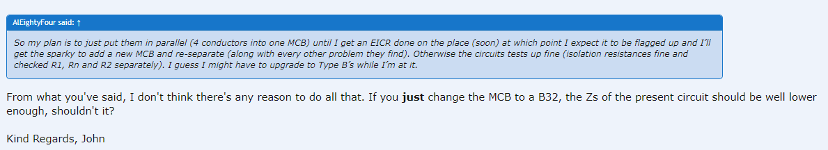

So my plan is to just put them in parallel (4 conductors into one MCB) until I get an EICR done on the place (soon) at which point I expect it to be flagged up and I’ll get the sparky to add a new MCB and re-separate (along with every other problem they find). Otherwise the circuits tests up fine (isolation resistances fine and checked R1, Rn and R2 separately). I guess I might have to upgrade to Type B’s while I’m at it.
From what you've said, I don't think there's any reason to do all that. If you just change the MCB to a B32, the Zs of the present circuit should be well lower enough, shouldn't it?
