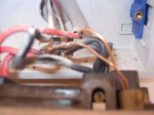

My Alphatek was showing "PE" when EFL testing from this outlet. There are three cables at the outlet.
Had they sleeved an earth black and connected it in with the neutral or something? DIY TN-CS :shock: ? I take it the PE thing is saying the earth is not connected? Is it a fancy radial or something? If it was a ring I'd have thought at least one of the cpcs would be connected to earth, or just a complete mess of spurs on spurs. No CPC sleeve makes it smell of a bad job.
Top marks, my numerical buddy!
Yes, one of the cpc's was sleeved black and connected to the N terminal.
PE means no earth connection.
It was a spur with two further spurs taken from it....lack of sleeving pales into insignificance compared to the other problems!!
