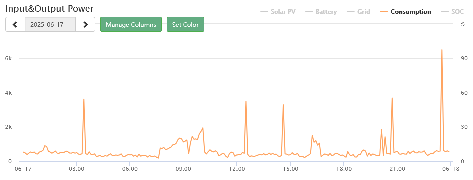

I have just had a 9" swapped for a 27", and I can see when the unit likely turns on. 1750230868761.pngI will guess short spikes are making coffee, and longer ones the immersion heater, but depends if it uses full 3 kW or some lower amount, I will guess this
first thing in the morning is still the immersion but lower output as not enough sun. It is set to use off-peak as well, so the
will be the off-peak. The whole reason for changing lenght is so on dull days there is hot water left, I know if I use the oil boiler the tank can last nearly 3 days, I suppose one can press the button and see how much used today, yesterday, and last 7 days, with the short immersion I was using less than 5 kWh per week, not had long one in for long enough for the record to show much.
Not sure what the results are when the CT coil batteries become discharged, I have changed them once, but did not look to see what used, and at that point had not set up the off-peak bit of the controller.
What are you controlling the immersion heater with? I am using an iboost+, the graph from solar software, the smart meter is in the main useless, as only shows energy used 00:30 to 05:30 when on off-peak, rest of time shows zero or export, so no real help.

I have brewing gear so could measure temperature, but from turn on after repairs, it took 4.22 kWh to heat from cold, that is a lot of energy, and I know from using oil to heat DHW, the tank can stay hot for 3 days.

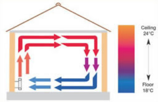

I looked for a diagram showing the currents within the cylinder while heating, loads for central heating circulation.jpg and there must be a similar flow when heating water. I would guess hot water goes up the centre and down the outside, but likely not much lower than the bottom of the element.

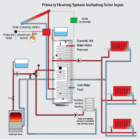

The Willis seems great, one should be able to select how much, hot water is produced, but the diagrams tend to over simplify, I have seen this Torrent pipe example.PNG up and running, it was not a single tank, it was two massive tanks on a special reinforced floor, the main concern was a power cut, and how to keep the wood burner cool enough, with warning gauges etc.
