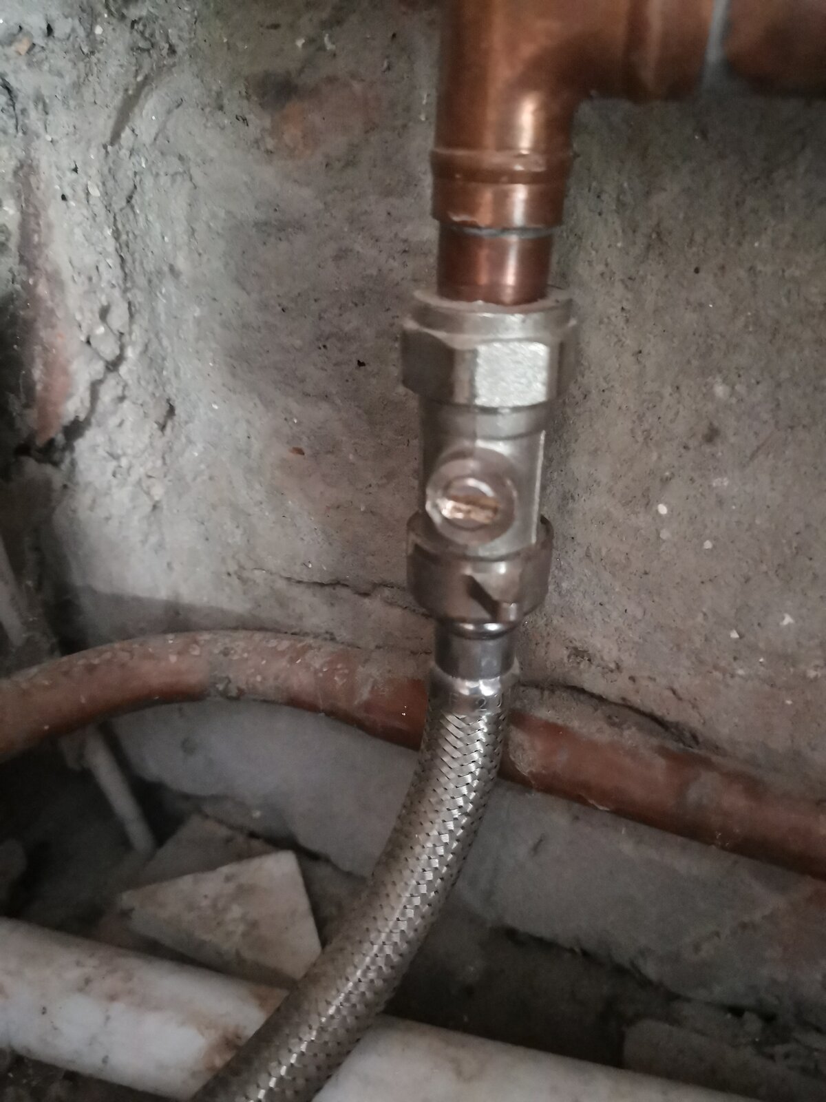

Pressure still slowly rising. Do I disconnect this to check? (Picture attached) the groove for the screwdriver is very worn so I'm worried it may not be fully off now

Yes, you can undo that side if you want, you could turn your cold water main off for a bit, see if it still rises, if not, then you know the valve is suspect and you could probably change it.
So water poured out after I took nut off. Feel like I need to maybe turn off mains and maybe call engineer at this point do ya think?
Try to align screw so water no longer pours out, use a container if need be, then reconnect loop and book in for a new valve/loop kit.
And dont accept another cheap shoite filling loop pay the little bit extra for a decent one, and tell them to fit it the right way round , yours is the wrong way round
